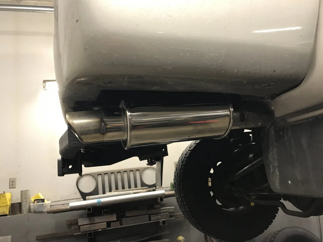

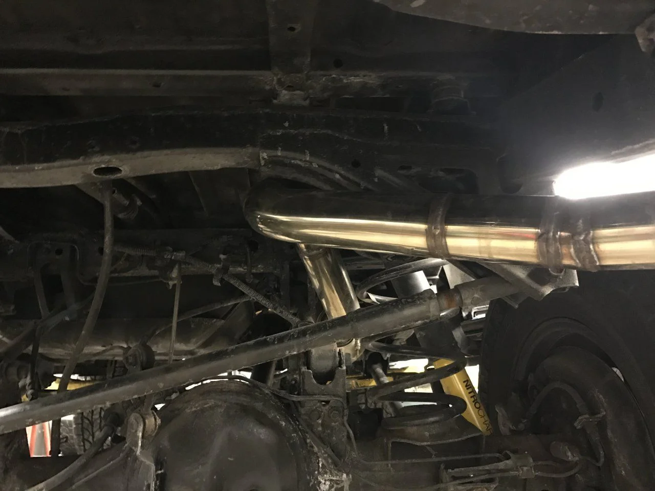

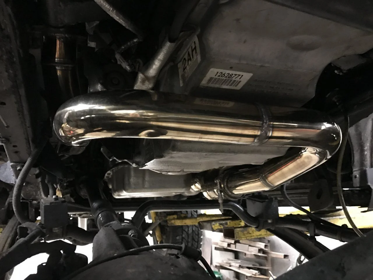

Here are some pics of my completed exhaust. I opted to build it all from 304 stainless, helps that my friend offered to tig weld the whole thing. I used Cadillac CTS-V manifolds and went 2 1/2" into a Y collector. 3" from there to the back. I went over the transfer case output with the pipe and there was plenty of room to do it with 3" mandrel bends and no rattling. Let me know what you all think. I have been driving it for the past week and am very happy with the way it all came together
So CTS-V manifolds clear the frame OK?
Yes ,they clear fine. I am using the truck front accessories and shifted the engine slightly to the passenger side for power steering pump clearance. I did put a small notch in the frame rail ( passenger side inside) to make getting the pipe on and off the collector easier. The flanges on the manifold were also trimmed down to eliminate a bunch of extra material that overhung the flanges. I just bolted on a set of 2 1/2" flanges and trimmed the manifold to match the shape of the flange. I can't say enough about the performance and flow of the CTS-V's. my engine "only" makes 330 hp which is a lot less than the 6.2 in the caddy so it's not a restriction. The pictures are kind of dark i'll put up some better ones.
