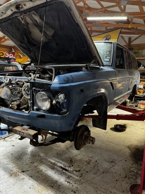

First pics from Wimberly:

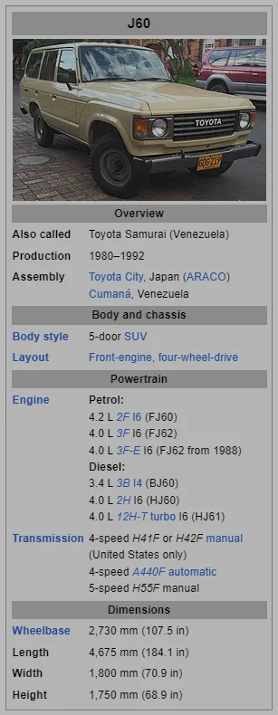

So, my understanding is that putting the the H55F into my FJ60 would be allowed since it was available for the HJ60. Or is this just a case of wishful thinking on my part? Of all the years driving my 60, the only thing I ever said to myself was "man, wouldn't it be great if this thing had a 5 speed?" So now that I have the chance to put one in it (in Texas), I don't want it to arrive and not get the "old timer" designation just because of that. After to talking to Marcus, my guitarist, I'm not even sure they would notice since he said they do the "driving" test on rollers in a garage and only go up to 2nd gear and test reverse. If I lest the original shifter knob on it, I'm not even sure they would know it had a 5 speed in it.

The H42 is down left, the H55 is down right
Crap, you're correct. FOILED, lol. I just sent an email to some folks asking if the H55 would prevent it from getting the "old timer" designation. Awaiting their answer...from their website:

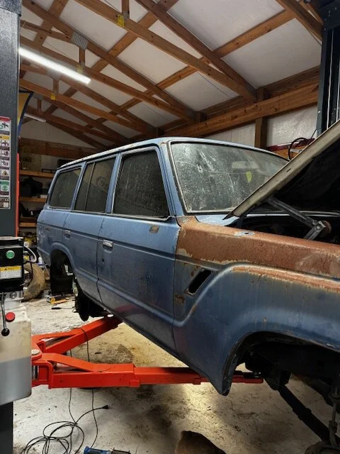

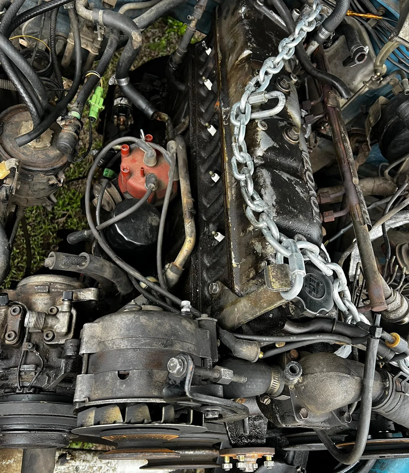

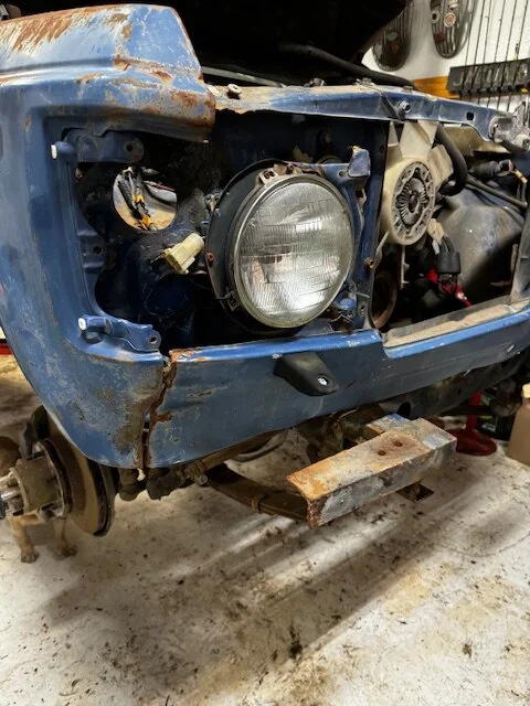

Long overdue update. Danny from Hill Country Cruisers sent some photos. And I've also continued working with the importer in Wuppertal. Looking into booking our flight back to Austin mid July for pick up...and drop off in Houston. Also found a nice FJ60 specific car cover for the trip over.
