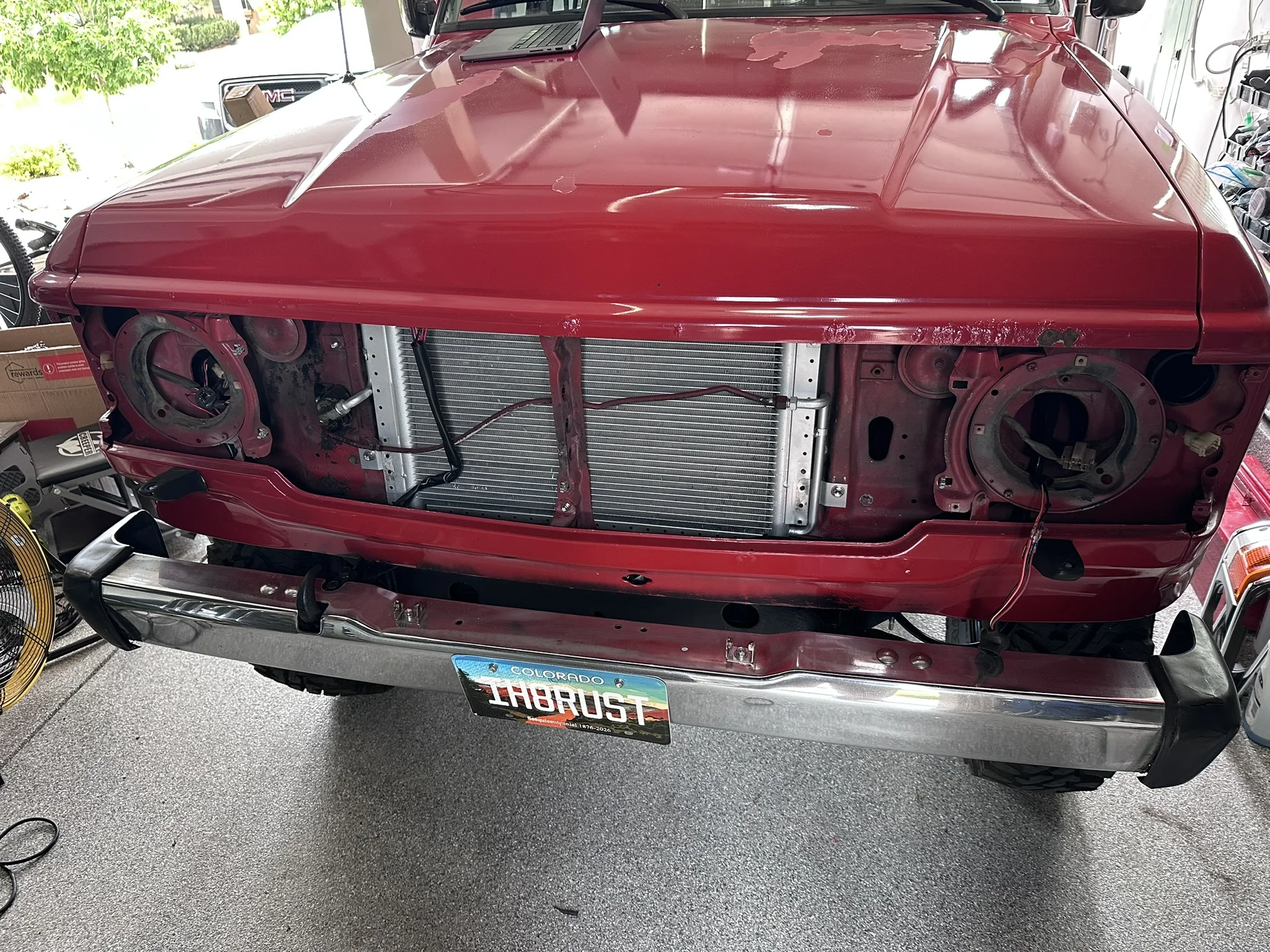

Just a heads-up—YMMV, but I’ve decided to go with the Phoenix Mobile Air condenser, Part #755-78005. At $99.63 plus shipping, the price is tough to beat, the dims look close and it was the only part number Coolstream gave me for an FJ60 that hit.
Important Note:
There isn’t a condenser currently on the market that matches the OEM dimensions exactly—so no true drop-in replacements. Many aftermarket options have the correct width, and some match the height, but all the ones I’ve found are slightly longer in length. You’ll need to fabricate some brackets (not difficult) and have new lines made; I’m getting mine done at a local rubber and gasket shop. As others have stated @cruisermatt has indicated he is putting together a kit for a universal condenser.
Chase (@red66toy from The Cruiser Cult) was incredibly helpful—I am using their video on Instagram as a starting point.
I’ve = been in contact with Enrique Tapia at Phoenix Mobile Air. They are a manufacturer for Coolstream.
www.phoenixmobileair.com
As always, do your own due diligence before moving forward.

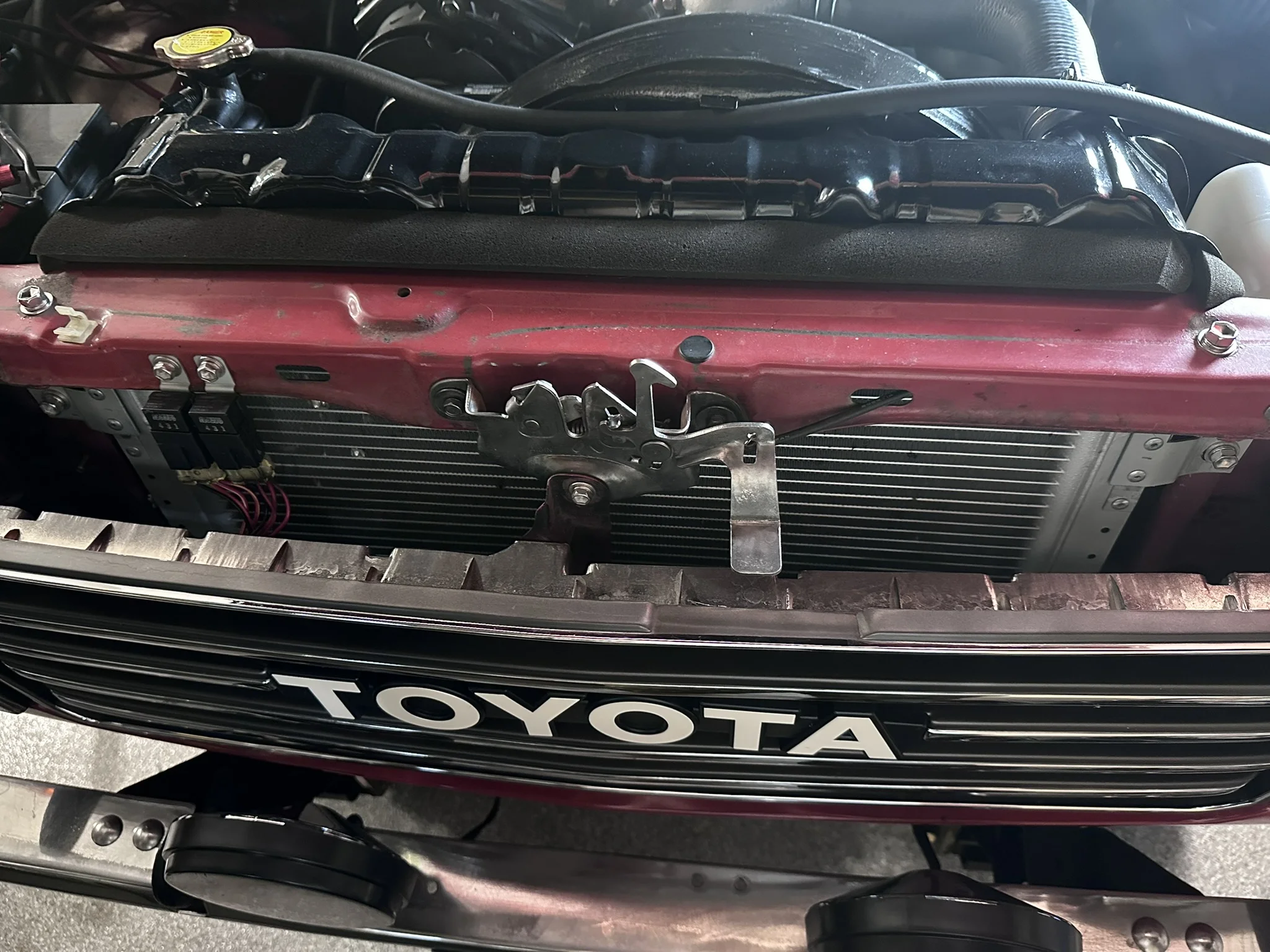

Here's the Cooler Classics on my '84. Brackets took some doing, and the pipe has to be adjusted. Come to think of it, I think it needs to be spaced away from the radiator for better airflow. It's not possible because it's too tall, and I can't move it forward without hitting that front pillar, which is already hits, and I can't move it up higher, so it's a bummer.
Can you incorporate the factory rubber isolator mounts some how? Helps reduce vibrations on the unit.
Thinking yes, maybe, but also, there are two-piece rubber isolators that can be bought to do the same. Come to think of it, I'll try that!
PS. Love the anti-theft harness, Koito fog lights, and the e-brake boot. Appreciate you.
Yeah see if you can make something work! :)
Thank you for the kind words! Seriously appreciated. :cheers:
