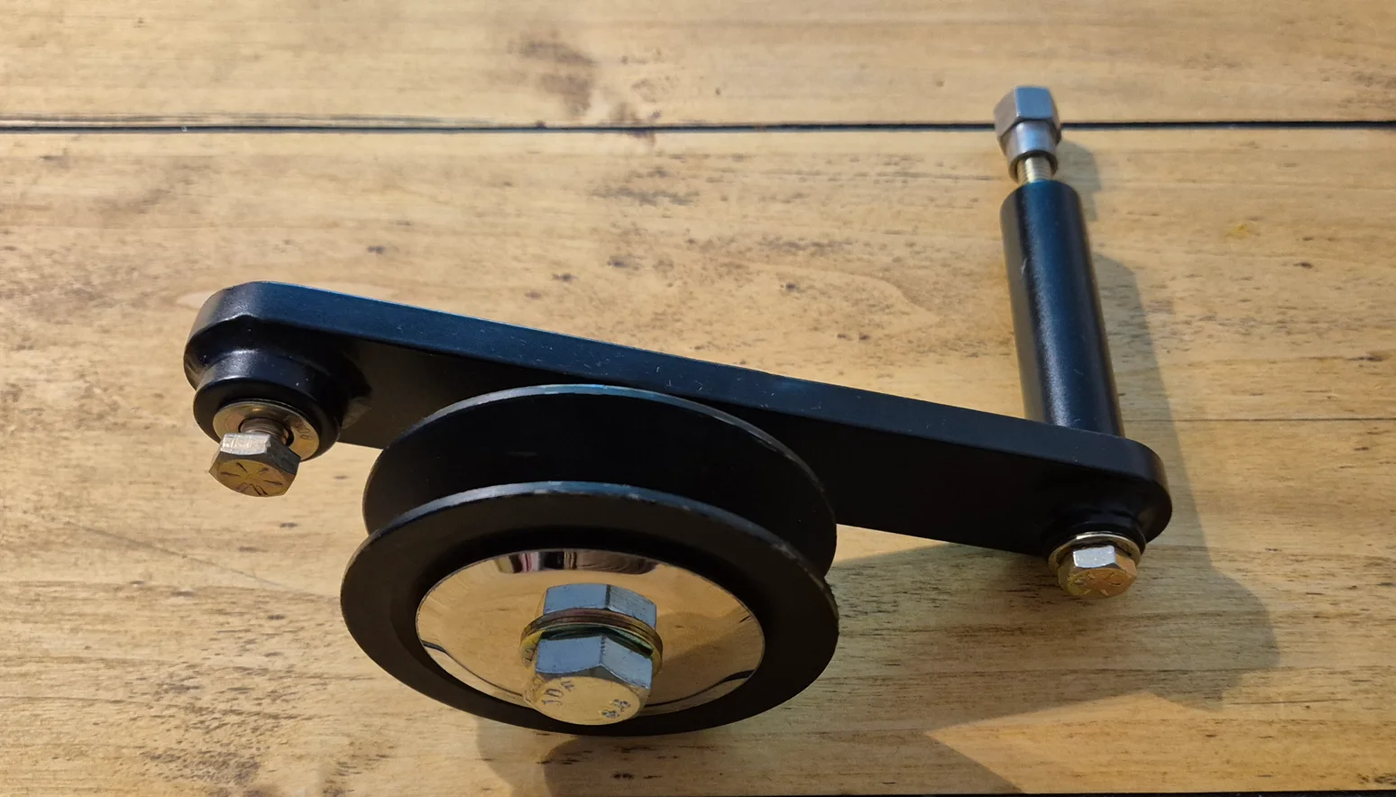

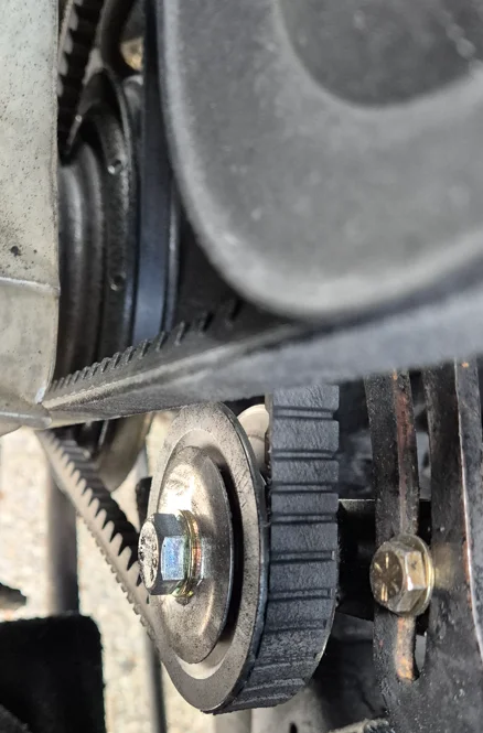

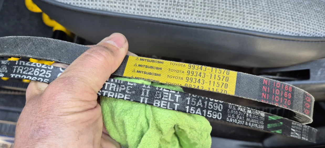

Replacing the belts with the actual, correct belts has sorted the PS (for the time being) and water pump issues but I'm going to install the Man a Fre dummy pully/smog pump replacement since I think it's about to seize. I'll pick it up in Austin next month.

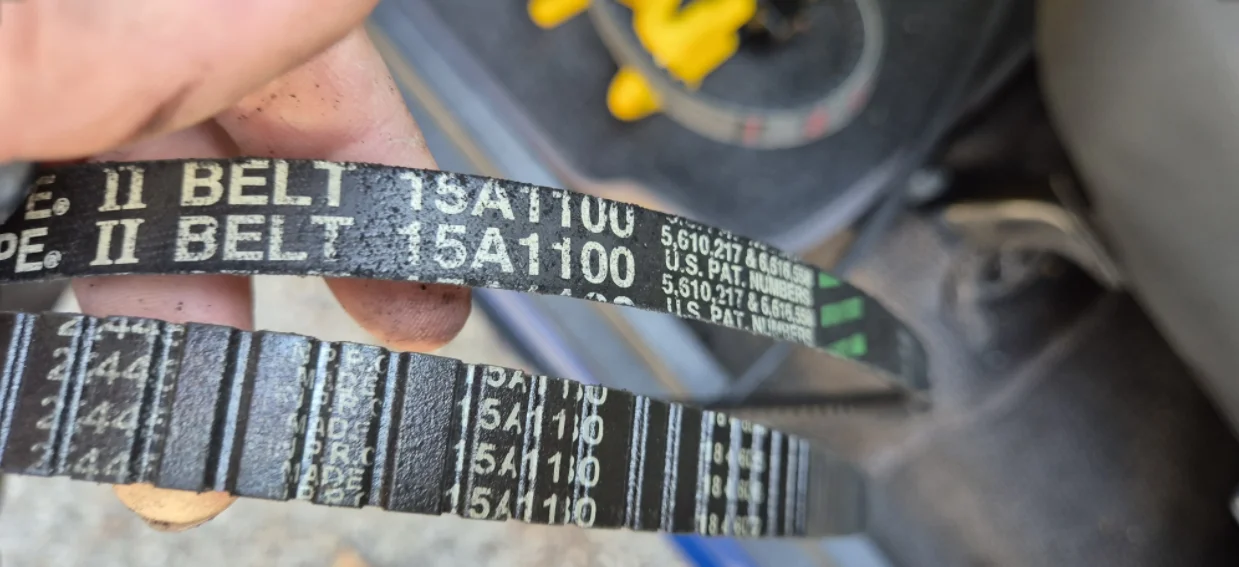

I'm going to check the old belt part numbers to see what they are actually meant for:
And:
And post belt install and 20 mile mixed drive:

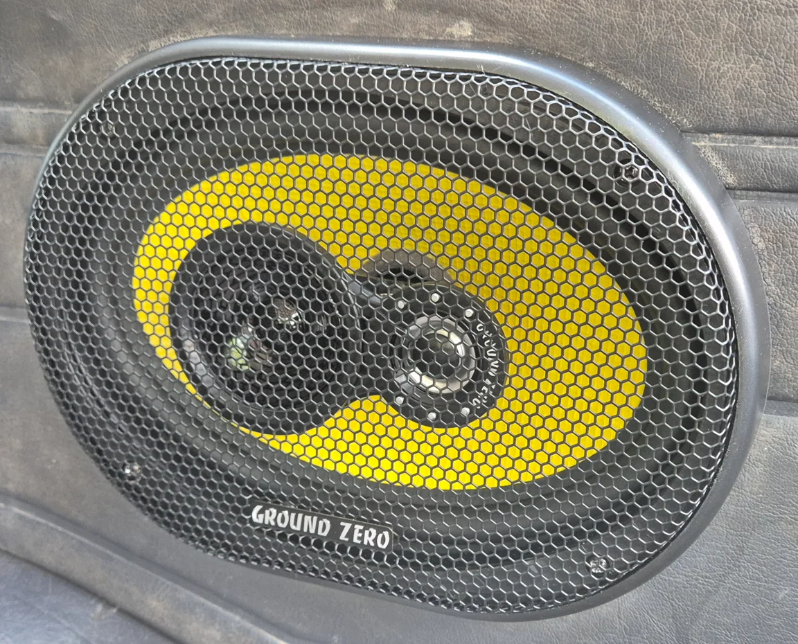

- grabbed some new speakers (the card was already cut when I bought it so I figured I'd like to get as much punch as possible so used a 1" spacer up front on the 6.5"s)

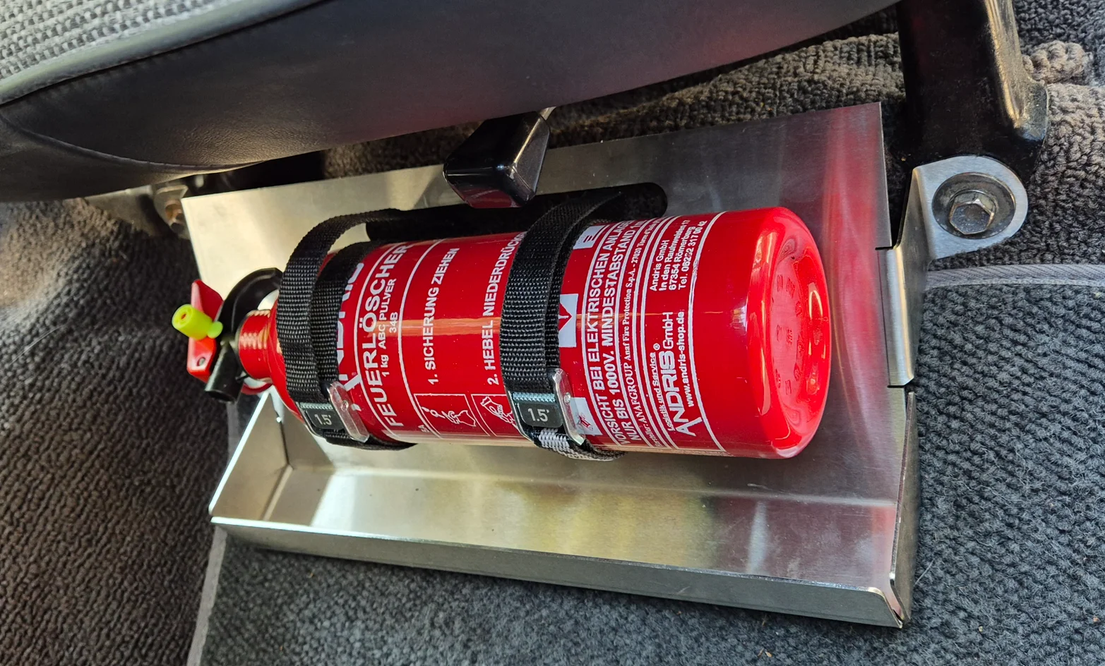

- Installed @CruiserTrash fire extinguisher holder. :) Solid and dead easy.

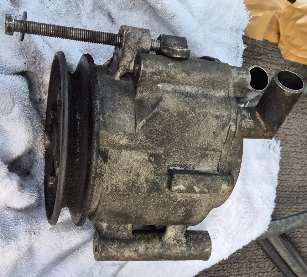

And am about to start in on the smog pump dummy pulley from ManaFre, which I bought as new but one that is clearly used (you can see from the pic) showed up. :/ If anyone has any caveats or gotchas for this replacement, let me know, but I think it's pretty simple since all the de-smogging 'plumbing' is already in place:

So, smog pump is out and the dummy pulley installed. No more slight pulley rattle and peace of mind.
So, does anyone need a working smog pump? Can be yours for ZERO doll hairs, just shipping. :cool:

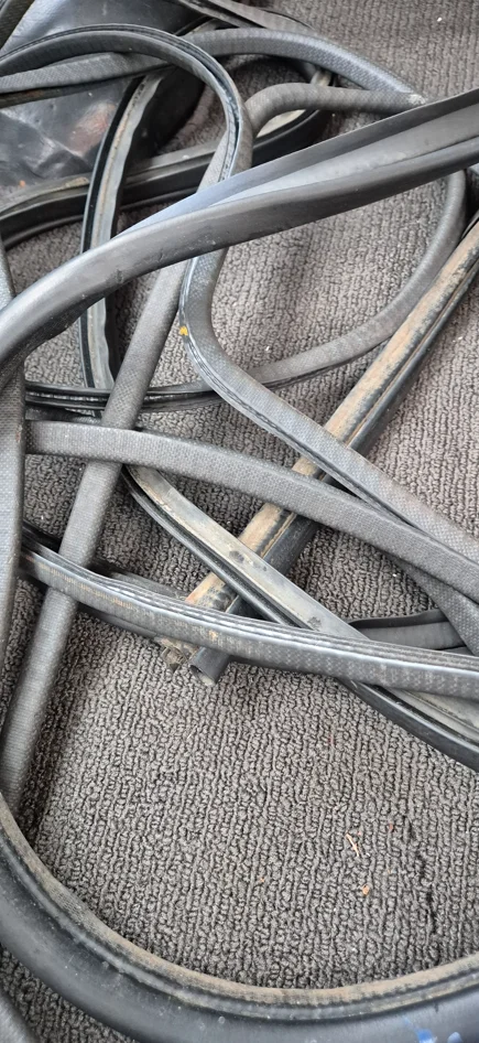

(I also have inside door/rear hatch foam strips that are gently used, if anyone needs any of that, I'd be happy to ship.)
