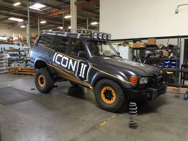

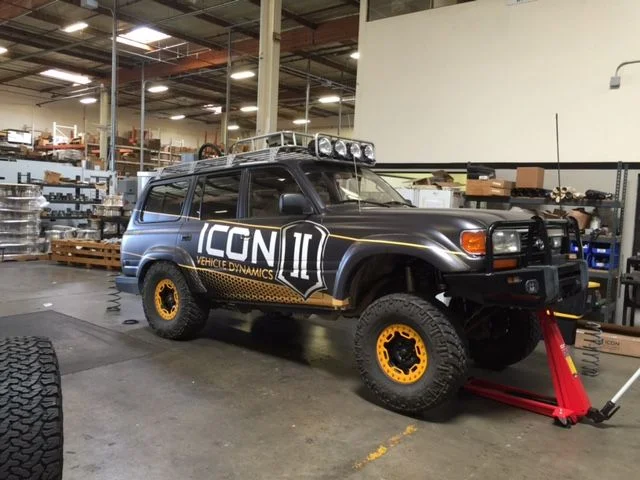

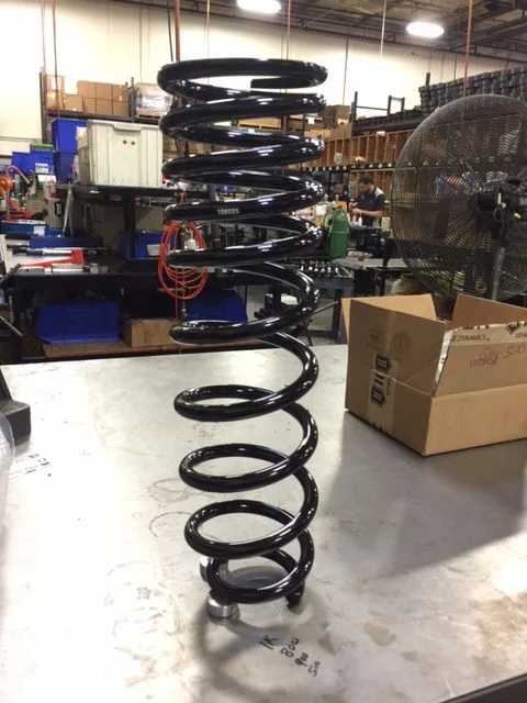

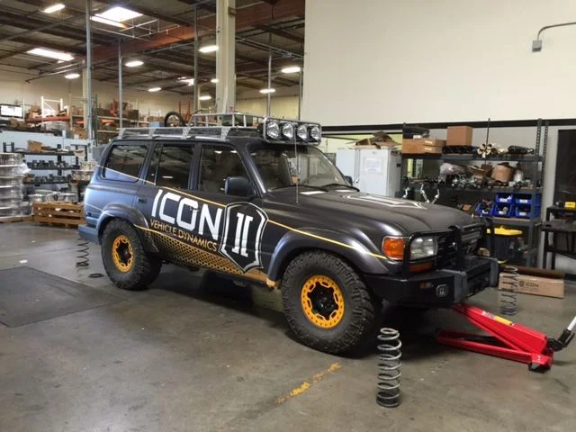

Darren and I talked about this when we first started working together a couple years ago
Eibach unfortunately is not interested in doing the tapered wire design. I’ve talked to some manufacturers state side that can but it takes some arm twisting. You see it more in the OE because it is a very space and weight efficient way of doing a variable but not low volume friendly or cost effective. Luckily Darren has gotten someone to do it.
To further add to what Darren was explaining: Even the 850J spring will be quite loose at droop with our 0-3” shock because the lift is gained more buy increasing rate than adding to the free length. Here are some pics of the vehicle with the springs removed but shocks connected sitting full weight on the factory bump stops then with the front and rear jacked up to the end of the shocks. It cycles over 12” of (strait up and down) travel front and rear.
To get the spring to not only stay seated but also make the travel you have perform fully you have to either: increase lift height or reduce spring rate. When we go dual rate you can make it so it droops soft to stay seated like the slinky coils or start softer and stiffens later like these coils
These are prototype coils I just designed. 3” lift and full usable droop travel.
