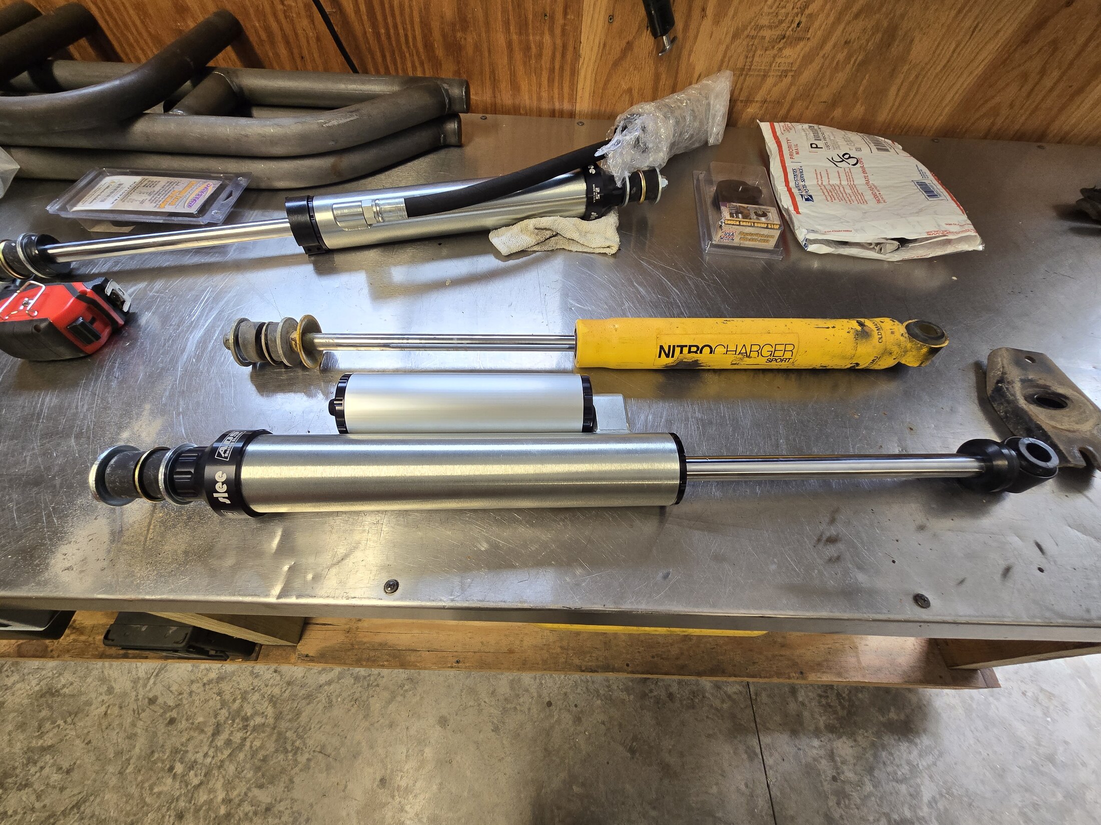

I appreciate everyone's input. After more research and talking to some reps, I decided to go with the Slee remote resi shocks (built by ADS shocks). These seem to be the best option for what I need for my rig.
New shocks are in. The test drive showed a definitive difference between what was on it (old worn out OME Nitrochargers) and the new ADS shocks. Very happy with the purchase.
