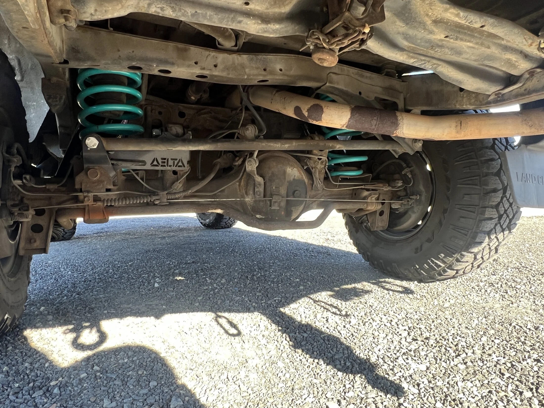

Hey peeps, doing a refresh on my suspension settings before a week of playing in the Oregon dunes.
What pressure are you guys running in your remote reservoir shocks? I've seen things ranging from 120-200 psi for Kings / Icons.
My rig is HEAVY and I do like to play hard / go fast over whoops / get a little air at times.
They shipped with 80psi, I bumped them to 120psi at the end of my trip a year ago on my last day and it made a HUGE difference. (I have a lossless chuck that can get them up to 180psi and wanted to make tweaks beforehand so that I'm not messing with it at camp. )
Just curious what you all are running yours at?
Also do you measure compressed or extended? I filled them while compressed last time.
(Pics for attention.)
