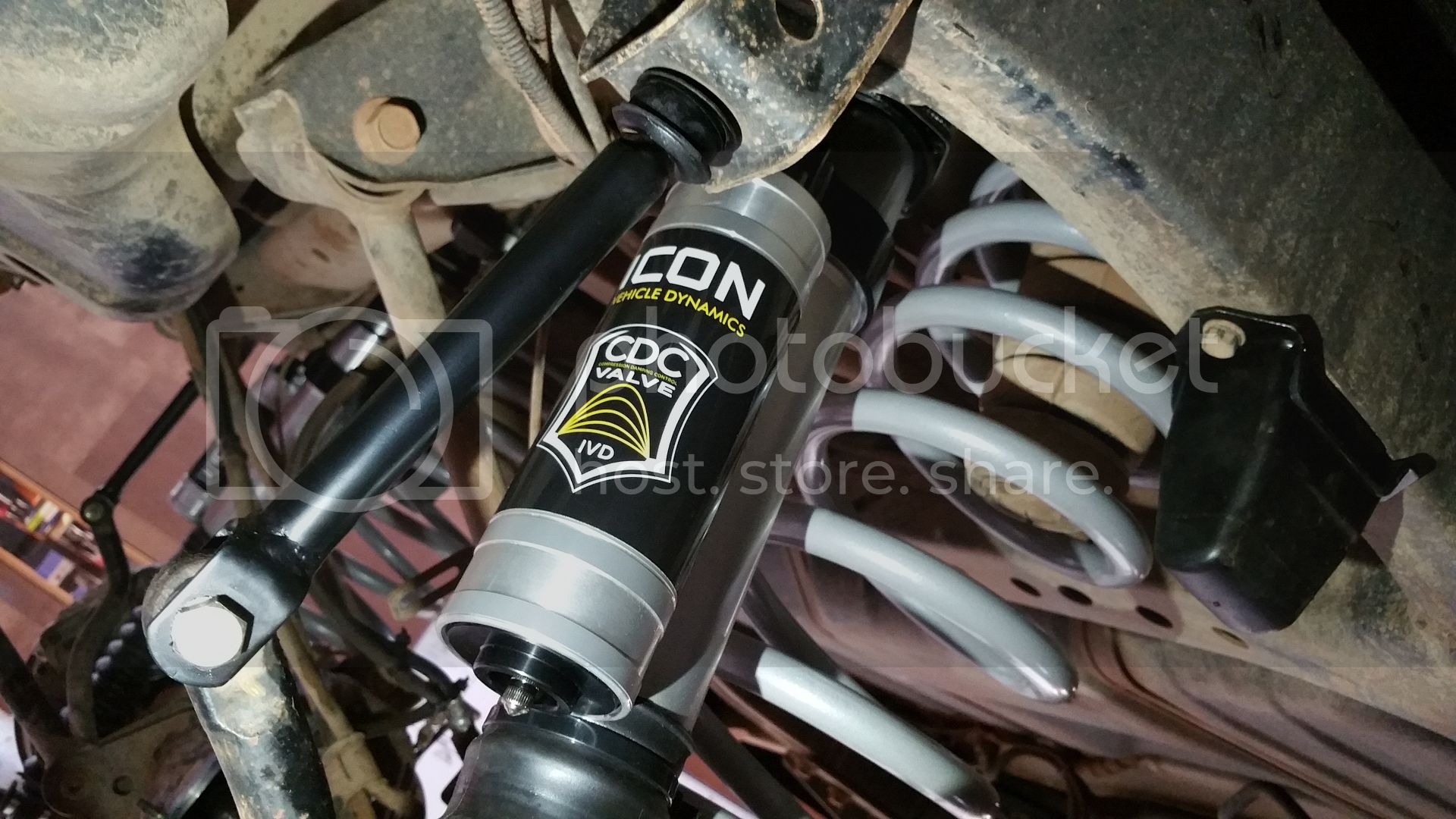

So, here is a pic that I have not seen anyone post yet. This is not completely on the bumps yet, It has approx 1" left to go. I counted 14 turns on these tall coils, its a lot of metal to fit within the confines of the stock bump stops. Hope this is helpful.
They fit .
Oh, I'm very sure they do. You have definitely done your homework. I didn't mean they didn’t. You wrote once that to make them fit you had to go to the thinner wire on top due to block height restraints.

In the rear we run a 30mm bump spacer, so theres a tad more room in the back. [pic is 100 but you get the idea]

For some comparison's sake, this is 10" of shock travel (Fox 2.0 remote res), pin to eye mount adapters shifting shock travel down, 4" lift. 5" up travel perfectly protected with 2" of bumpstop drop and 5" down travel. Rear coils at full flex.
The extended coil is still seated, and is probably within 1/2" of full extension.
Stock rear swaybar with frame mount drops, front swaybar removed (handles much better gone), stock brake lines.
This is what it looks like in practice (I have no new good vids).
That was about $1,500 in springs and shocks. Shocks are owner rebuildable and springs are true to the day they were installed.
