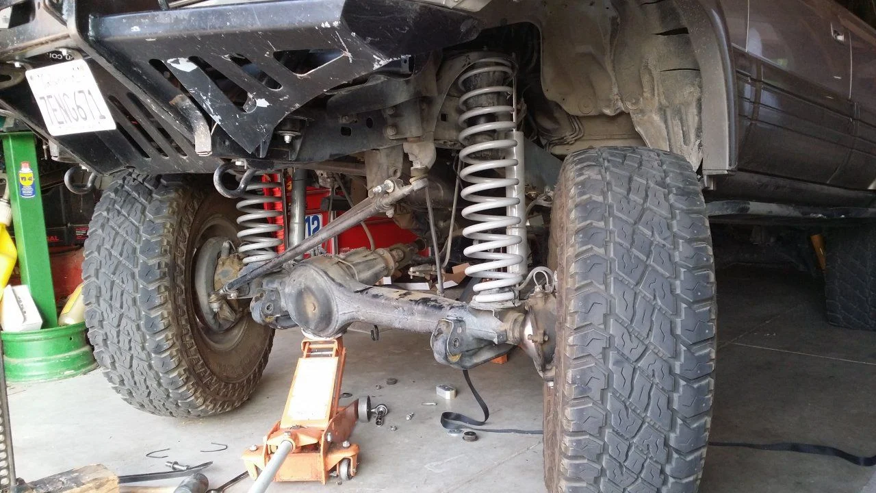

There is a LH & RH side ruffly 15mm in free height difference. These are the front Int. 75mm lift.
20160729_154516-jpg.1298458
20160729_155835-jpg.1298459
20160729_155829-jpg.1298460
20160729_155944-jpg.1298461
20160729_155929-jpg.1298462
They are for the loooooooong shocks ;)
They close up for the ride height though.
I would say, these are very long coils.
So how long are the long Icons?
I have them on order, but they are not in yet.

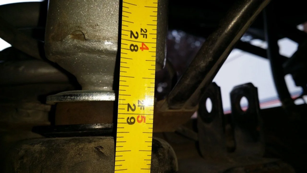

For now I have a set of 12" Doetsch Techs that measure 28.75"ish collar to collar.
With the longer DT shocks at full drop the drive shaft hit the sway bar & it groved the tube. Yes, I do have 1.25" spacers. I'm thinking the DT shocks are longer than the longer AC spec Icons which might be MY problem here.
