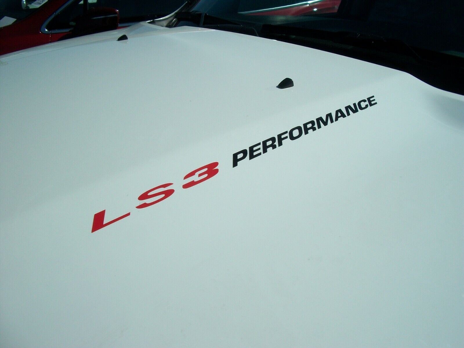

Dave one more thing.
I don’t care what anybody says.
My stickers added at least 100 horsepower to the 80. I know my truth. Hahaha
