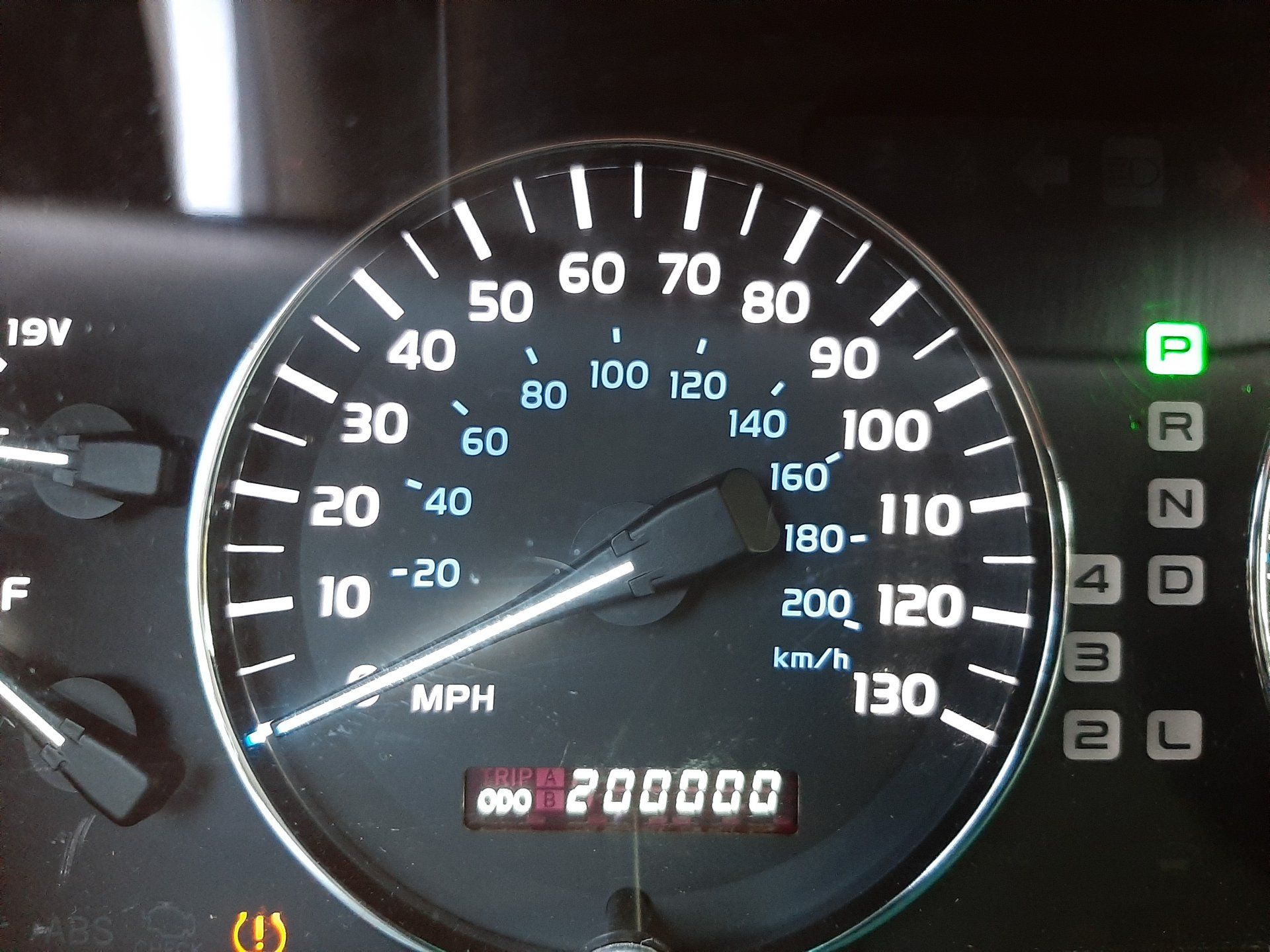

Haven't driven the LX since before Thanksgiving; went out the other day and it was dead. Couple of days of having to jump it off and it was apparent that the battery was beyond charging back up. It was a NAPA Legend and only 3 years old so I was a little surprised. I'm sure I could have gotten some money back from NAPA on the battery but 1. there's no NAPA near me and 2. they close at 6:00pm. For convenience's sake, I went with a Die Hard AGM from Advance. Advance is 5 minutes from my house which makes any warranty claims super easy to deal with.
Will be curious how the AGM handles the long periods of inactivity that this vehicle sees. I deal with VRLA batteries quite a bit at work and their lifespan is horrible, especially given the inadequate maintenance we complete on them. Fingers crossed that 1. no battery issues for a LONG time and 2. the next post is not some type of maintenance. Roof rack, sliders and bumpers are in the future somewhere, until then - this thing is a BLAST to drive
