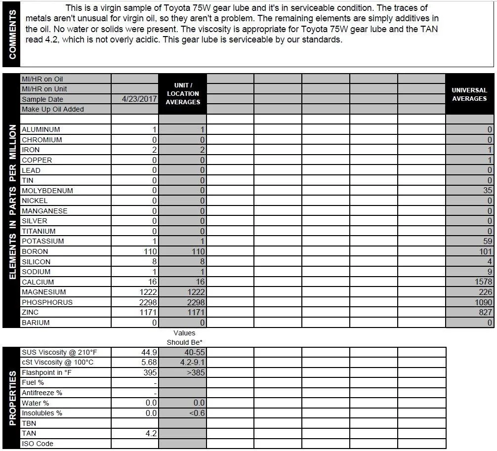

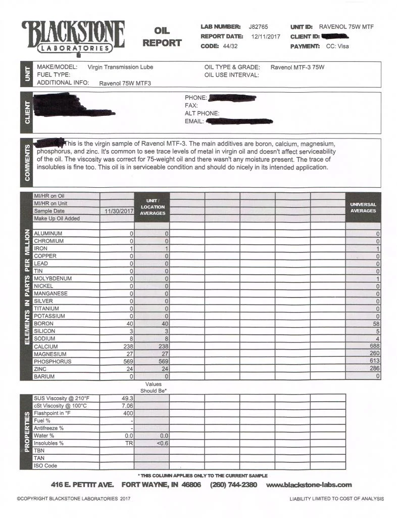

I have to wonder whether the odd smell of LF I described in the original post has to do with sulphur. Now considering digging into the VOAs of this stuff.. even though I’ve moved on to ravenol.
Stolen from BITOG - Toyota LF 75 VOA and a cut of the Ravenol flavor straight 75. It is a hell of an additive pack in the Toyota LF75...
Thanks for posting that! Can you describe what makes it a “hell of an additive pack?” Just the quantities compared to other fluids? Meaning it’s expensive? Or is something special about the ratios?
Guess I’ll start saving 20s for the official LF for next change.
It is a ton of Mg (detergent) and P (antiwear) in the results from Blackstone. I'd suspect the mothership knows something about what the center diff likes for dinner.
