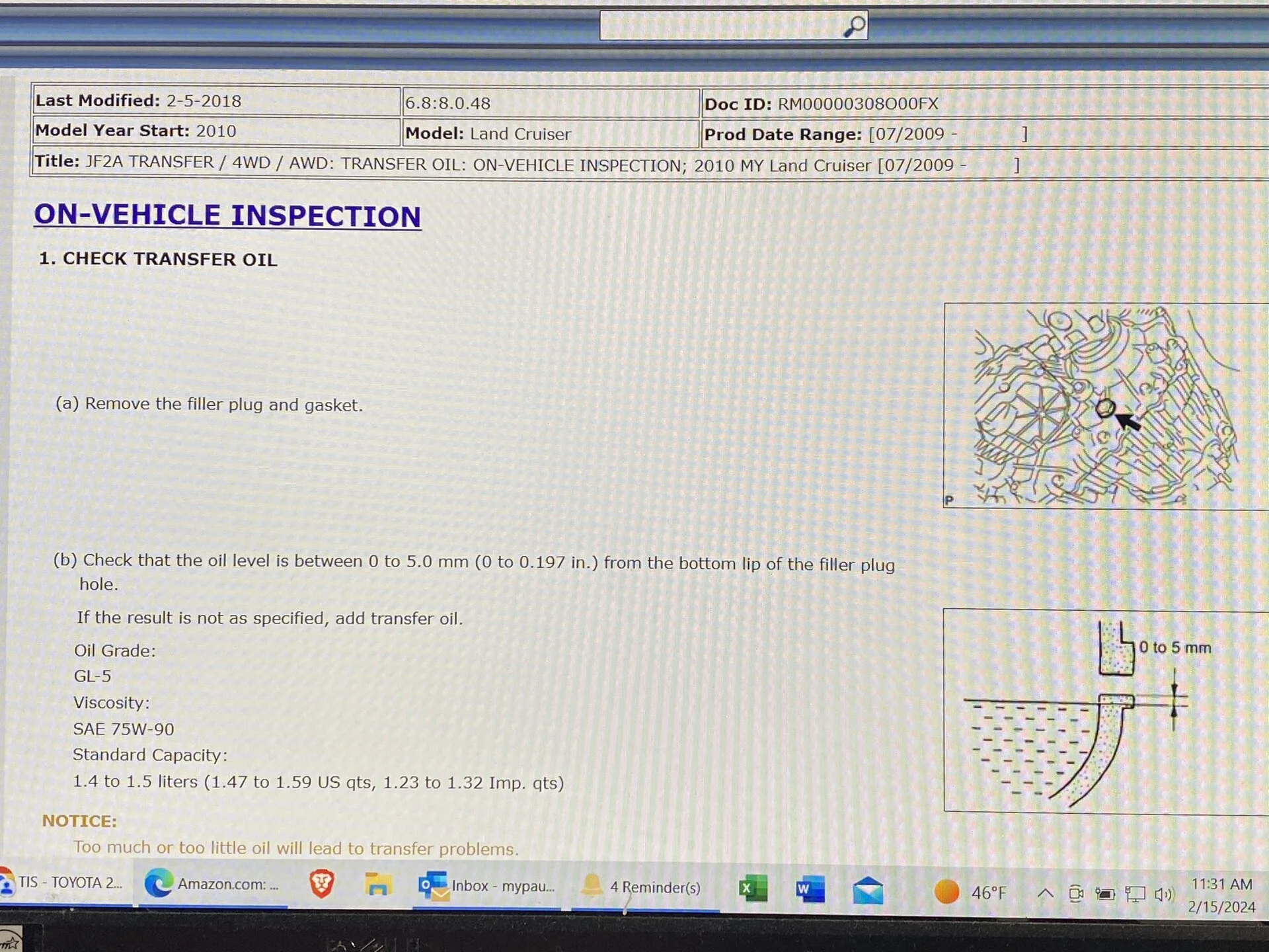

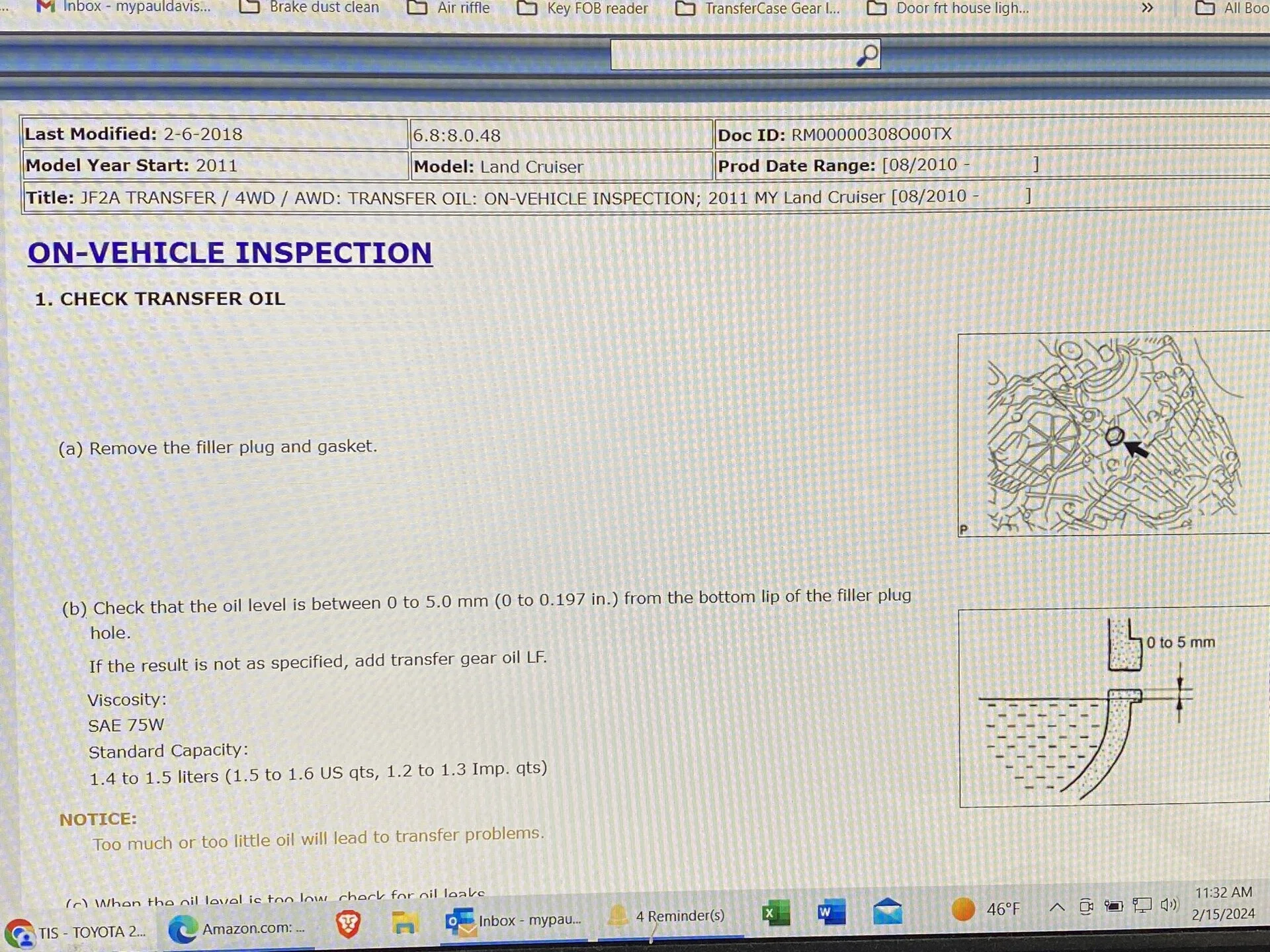

I use TIS more so, than hard copy FSM manual or owner manual. Toyota, once would mail update pages to FSM, for the hard copy. But they stop that ~20 years ago. So TIS is best to get latest info. Example: In TIS for 2004-07LC/LX, we see A/T fluid check level at, 97-115F (TSB, lowering to this new temp). In hard copy we see: 115f-130f.
TIS is updated periodically (modified) and noted as to date it was. This is what all Toyota & Lexus Dealership shops use.
This is as of Feb 2019:
TIS (Toyota Information Services), updated Feb 2019. TC fluid: Last modify 2-6-2018.
Repost what it states.
TIS/FSM:
TIS 2008- 2010:
Oil Grade:
GL-5
Viscosity:
SAE 75W-90
2011 - 2016 (last yr I looked at) :
add transfer gear oil LF.
Viscosity:
SAE 75W
ATF WS, is "separate discussion". I brought it up, just as a comparison foot note: To, why didn't Toyota make change to 2008-10 TC. Toyota did not, make a change from T-IV ATF to WS in the 2003, after WS came out in 2004.
So was it and oversight, "not" recommending LF in all 200 series TC.
Or
Did Toyota "feel" no need to change 2008-10. This would indicate a change in Transfer case in 2011. Like the addition of brass.
Prod Date Range [07/2009 - ] Makes one think, that date forward, it is NOT. See very next model year (2011) below

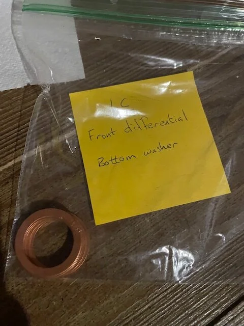

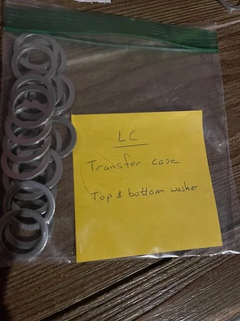

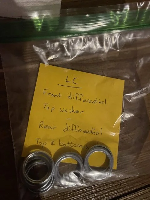

You didn't ask, but here are the washers I use for the differential and transfer cases:
I keep the washers separated in plastic baggies so I can remember where they go.

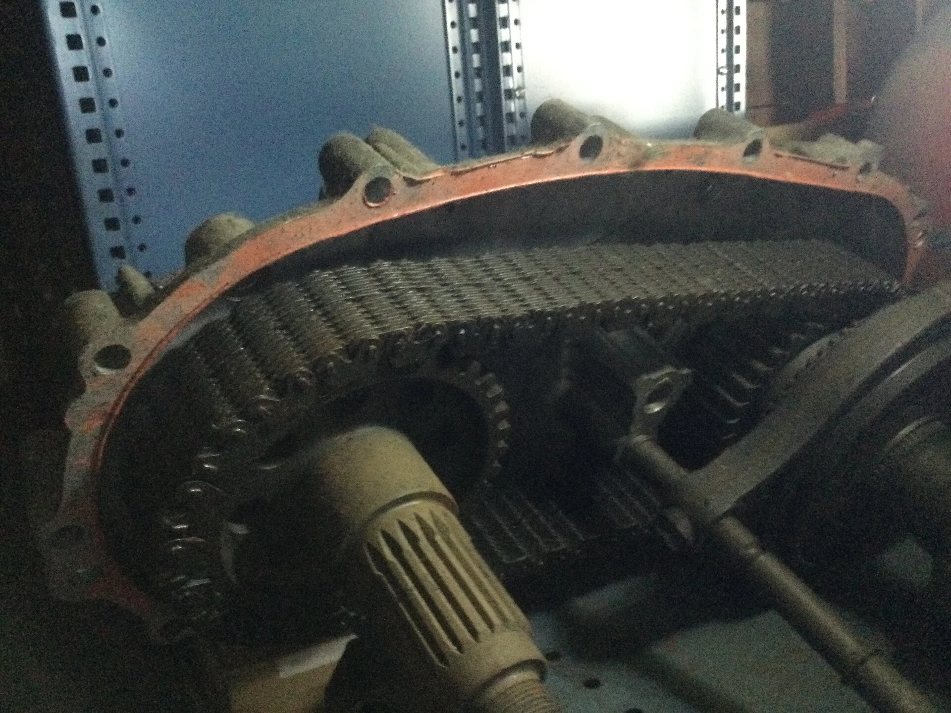

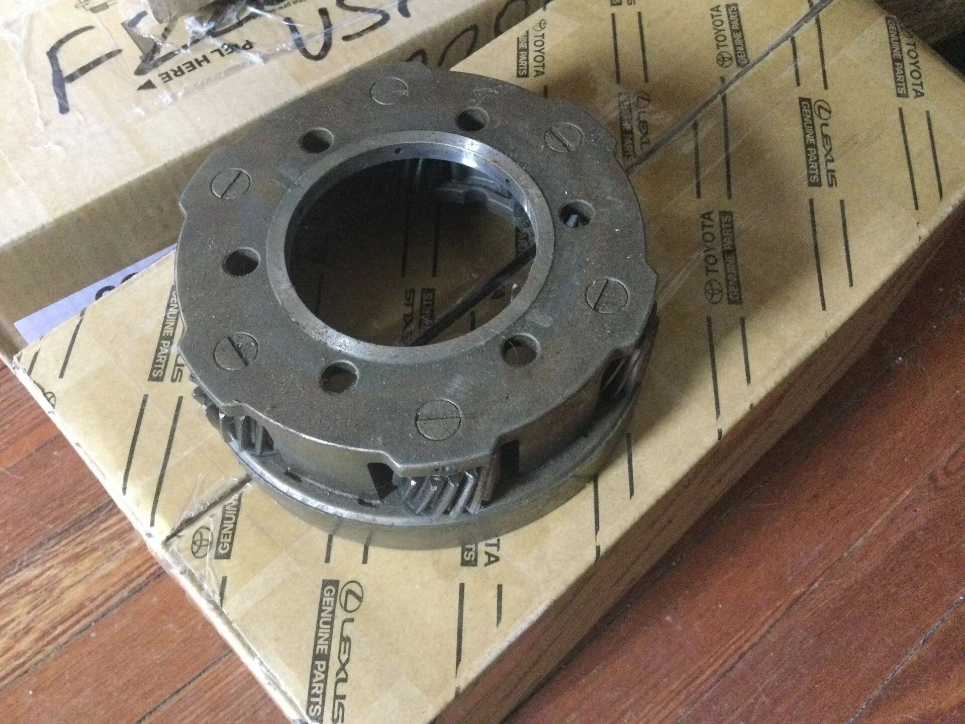

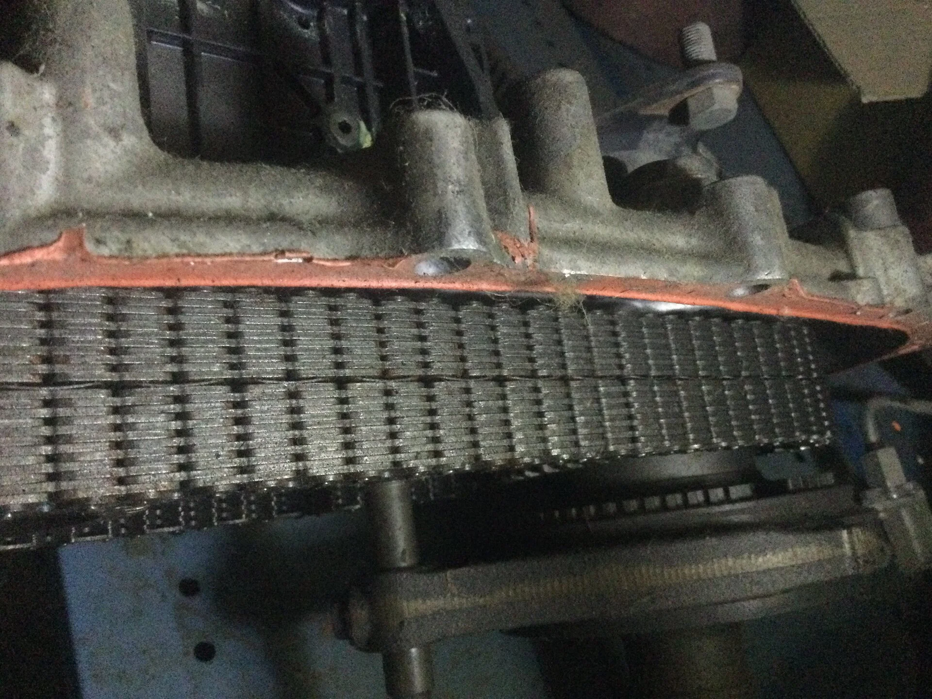

Nothing too special in those TC photos that would drive me to running the unicorn tears. I'm still using the $$ stuff on faith that the additive package has secret herbs and spices for the torsen (like all snake oils it could easily be placebo). If the fancy stuff saves 1% on MPG, it could almost make a case for it based on how long you run it.

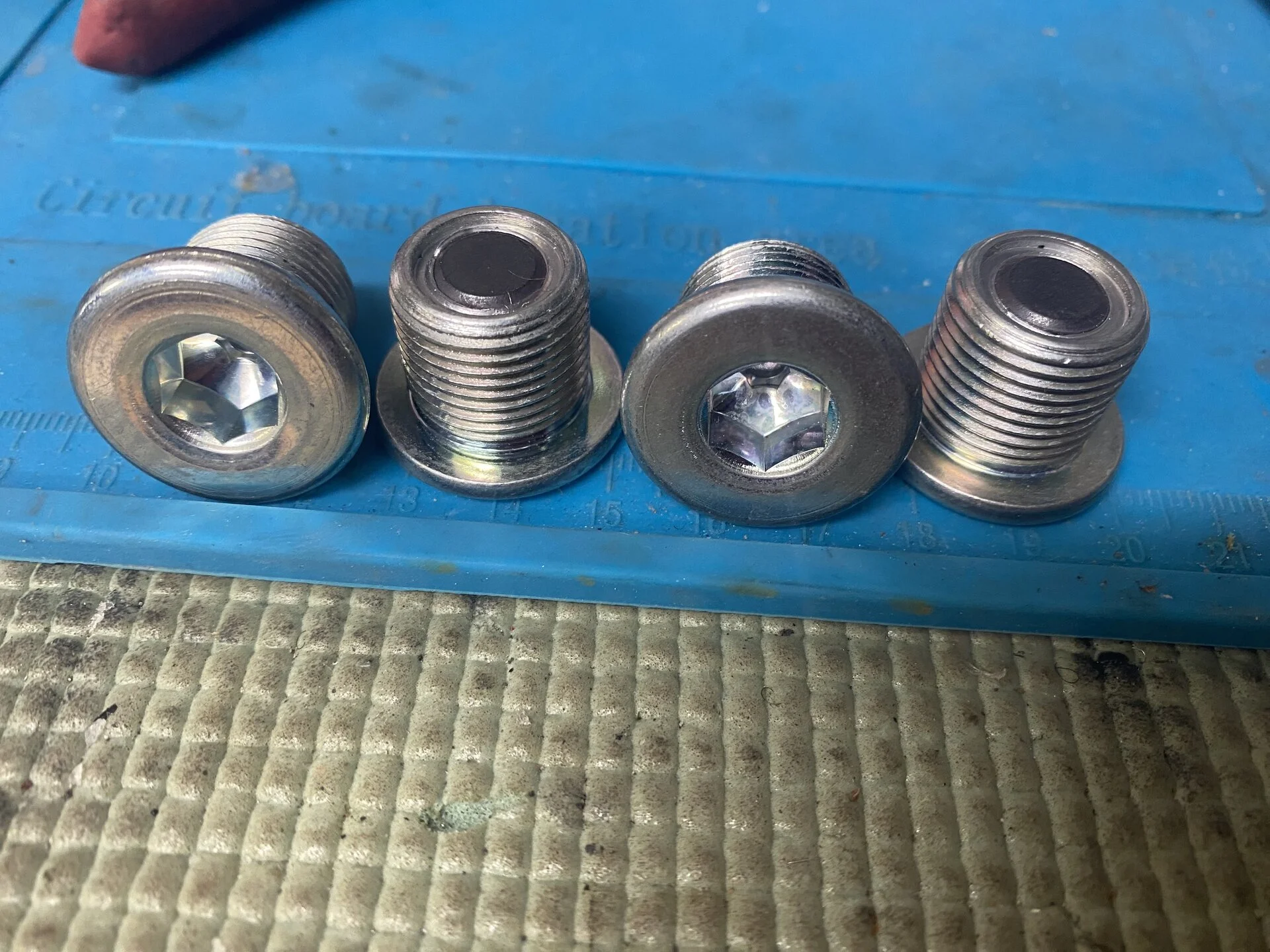

I had some of the hex drain/fill plugs from when I had my 80 series. Will those work with the 200 for the diff and TC drain?
