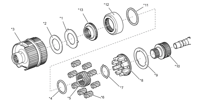

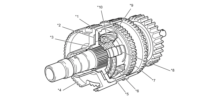

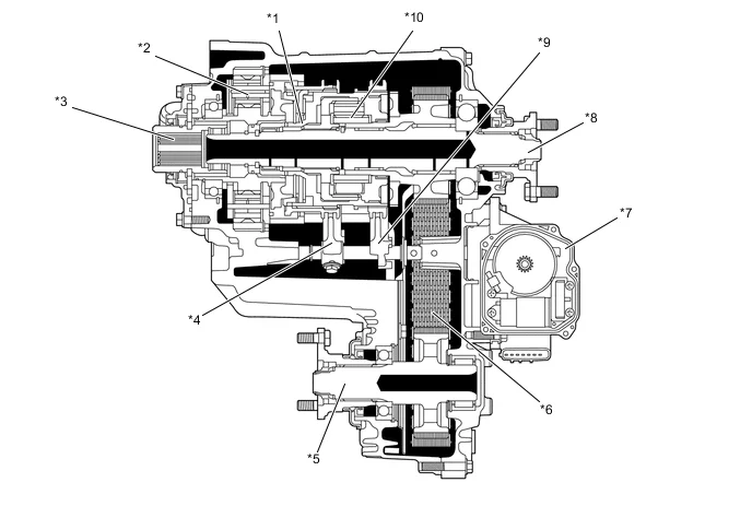

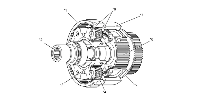

I'd love to see the H/L gear set and the chain configuration. Does the tundra part time unit spec GL series oil or the unicorn tears?
If that fiche is representative that could be a type c unit in the LC?
Those are accurate fiche/drawings of the t-case parts. First pic shows the low range planetary gears, they are lightly helical. I’ll get you the requested pictures tomorrow. Torsen is a Type C/T3. The Tundra specs 75W90, but may switch over to the LF around the same time frame as the LC. The chain has the same part number for all transfer cases.
