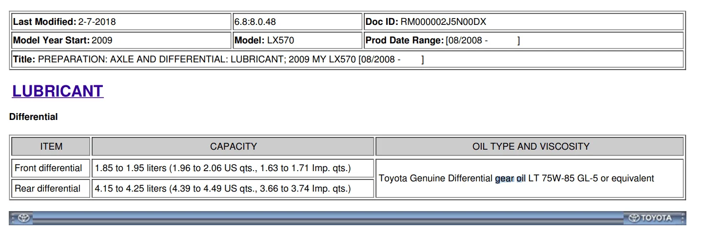

'Gear Oil' in 2009 Lexus FSM
Toyota Genuine Differential gear oil LT 75W-85 GL-5 or equivalent
Front differential 1.85 to 1.95 liters (1.96 to 2.06 US qts., 1.63 to 1.71 Imp. qts.)
Rear differential 4.15 to 4.25 liters (4.39 to 4.49 US qts., 3.66 to 3.74 Imp. qts.)

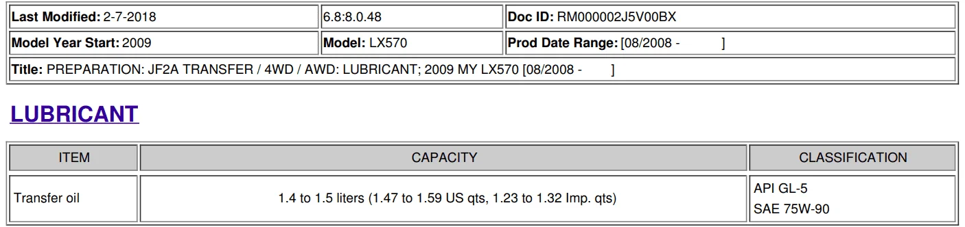

'Transfer oil' in 2009 Lexus FSM
1.4 to 1.5 liters (1.47 to 1.59 US qts, 1.23 to 1.32 Imp. qts) API GL-5 SAE 75W-90

Are you sure the FSM calls for 75w-90? I know for a fact my 13 specifies straight 75wt. Not that it's a giant difference in practice, just want to find out if 75-90 was called for in any 200s.
