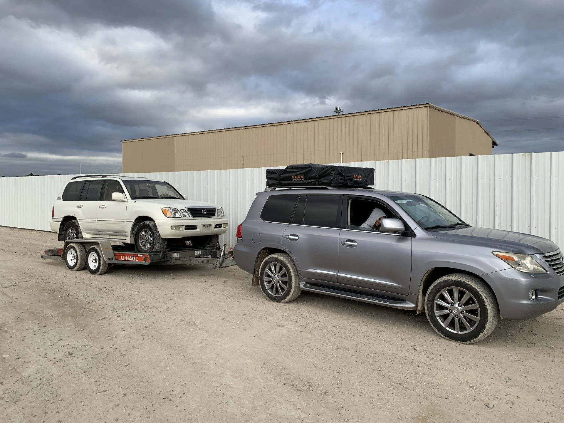

Well folks, can't say how thankful I am for this community... had a new battery and a fuse for the immobilizer waiting in the garage when I got home. Now an absurdly under-priced non-run/non-drive LX 470 is officially back up and running, drove fine for the 30 minutes I drove it (still a lot of baselining and diagnostic work to do to make sure it's not a polished turd, but couldn't be more stoked. Genuinely happy to keep one of these on the road.
The frame is SPOTLESS though. Like, less rust than my never-left-Texas 2010 LX 570. Unbelievable.
