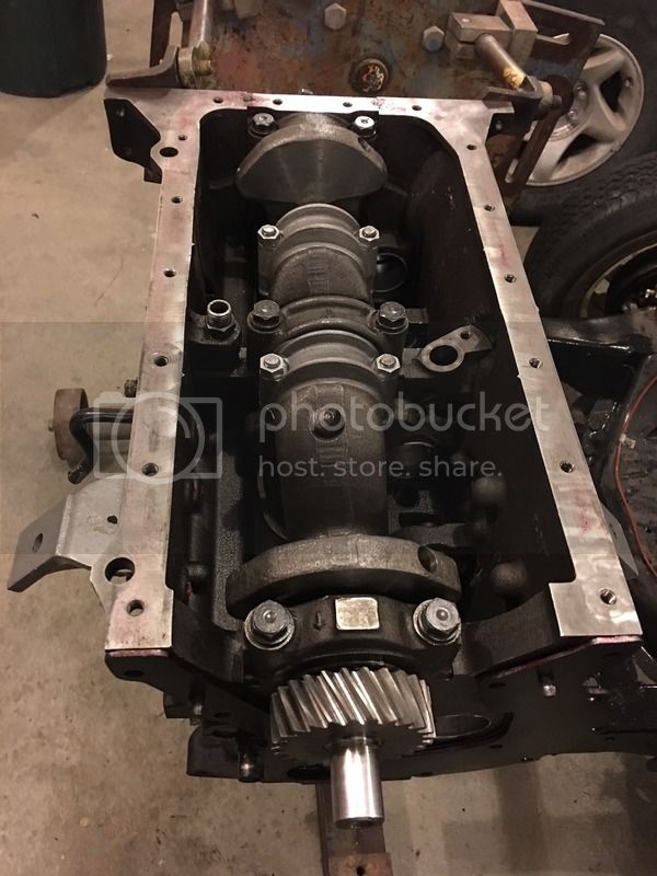

Alright I am working on the Stout after an extended break. Ran into a huge problem after the engine was all put together. One cam bearing has an opening that the distributor goes through and the re-builder put it in backwards.
So I am currently putting the whole engine back together and cleaning up a bunch of parts. The engine wasn't spinning that well because of a rope seal by the transmission so I am going to fix that. Pictures on the way.

Interesting, only three(3) main bearings? Much like the Hercules engine in my 151A1.

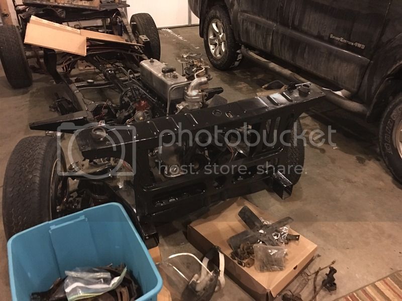

This is a slow process. I installed the front core support and I painted the sides last night.

Sand blasted and painted holders for small pieces in engine bay and Then installed horns, Coil, etc on them.
