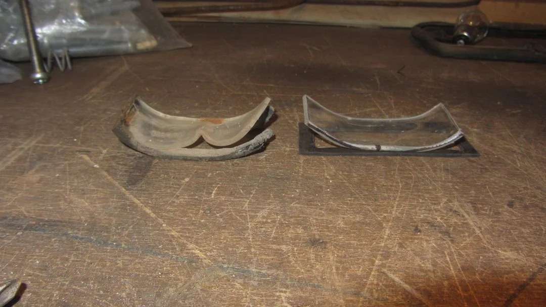

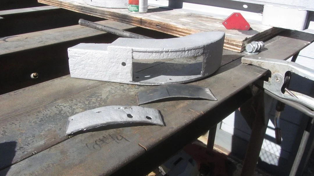

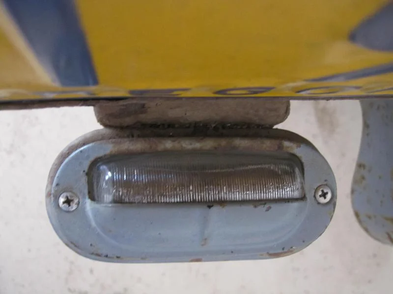

I was going to try some 1/8" or 3/16" plexiglass, heat it with a heat gun and try to shape my own light lens for the 25. ( and my LWB 45 license plate light as well)
Here is the best picture I could find of the only good one I have. Seems Eastman or something like that sells a kit to make a mold and then make repos out of plastic. I planning on going that route. There is also a rubber gasket that fits under it. The grey one had a lens cracked in pieces but no sign of damage to the housing. Guessing with a bulb replacement the cover was over tightened. In any case I would be afraid to run it with the glass lens. On my FJ45 LWB I was thinking of trying to cut down the lens from a 61 to early 74 FJ40 license
plate light. Heated it with a heat gun to form it. Then use the a cut down gasket from the same light to hold it in place.
