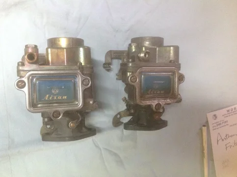

Blue times two!
A slightly older brother showed up between the last post and finally getting the replacement metering rod from JP. The cad is not quite as shiny as yours, but the blue paint on the throttle body was in better shape. It was in a lot rougher shape too.
