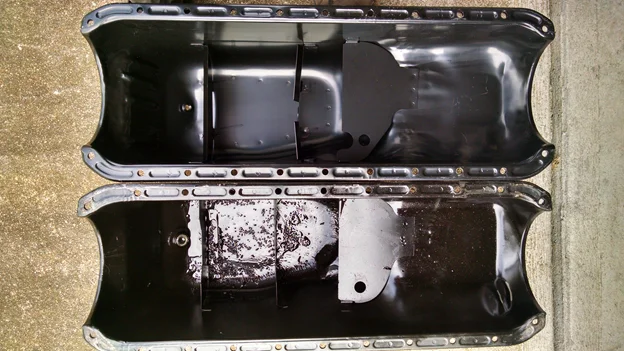

1976 2f oil pan to 1971 1F
I thought maybe there was an issue with an oil pickup?
Yes, the oil pickups are different due to the different oilpumps, which is why the baffles in the oilpan are different
Hello—as the title states. What mod do I need to do to make it fit? Doing some searching but haven’t found a step by step. Thanks-
I installed one on my stock 1973 F engine. Didn't trim anything. I've put on a few hundred miles, and everything is fine, no oil pressure problems, etc.
One of the baffles rubbed against the humongous oil pump suction screen housing, but not enough to impede the proper fit. The dipstick fits (and works) fine.
