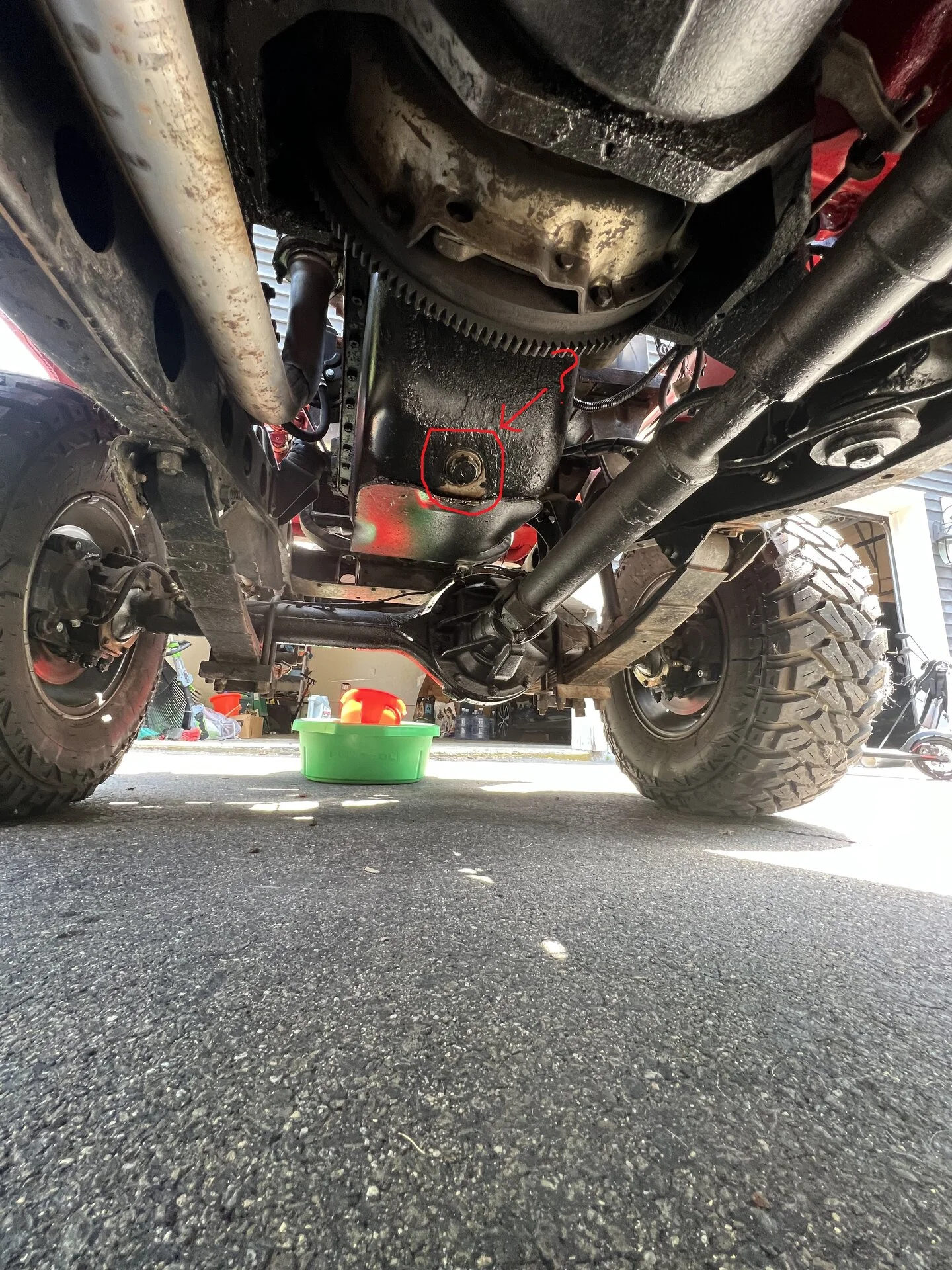

Hi forum people,
Haven't been able to do anything on my truck since last fall, outside of small jaunts around town. Just getting to my 1st oil change since I picked up the money vacuum last summer (yes, I know, I waited too long). I'm following the instructions but am not 100% confident I know where the drain plug is. I've got the manuals but just being overly cautious. I've got a picture of the undercarriage (I'm lying under the driver door, facing forward) and am wondering if what I've circled is in fact the drain plug for the engine oil. I don't want to drain the wrong fluid.
Thanks!!
There's a hard rubber washer that goes between the bolt and the pan also. Get yourself a few from Mr T. They are still available. It's a good practice to replace those every so often in general. Unless you are collecting oil leaks. In that case, ignore my advice haha.

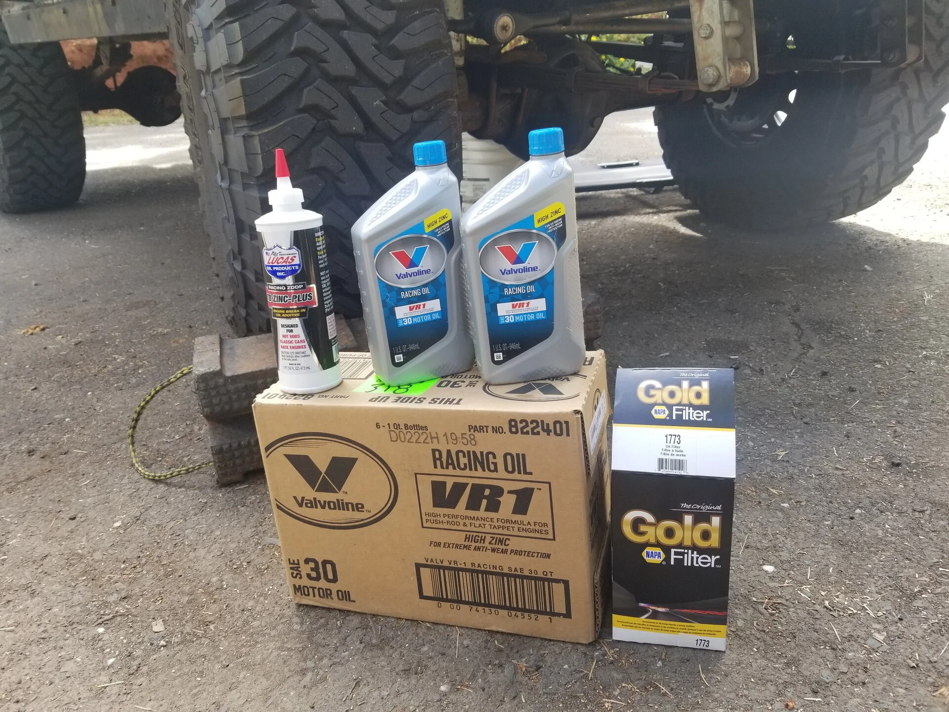

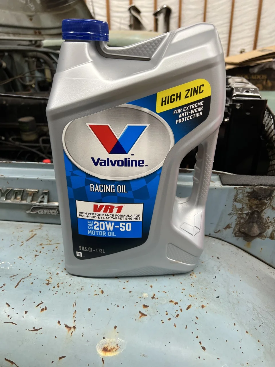

Recently went from 10-40 castrol plain GTX to the 20w-50 Castrol Classic with high zinc, read a few are running 15-40 Rottela diesel. I also ran VR1 Valvoline 20-50 in a 2F rebuild. You can likely find an opinion to support every oil on the shelf.

Thanks - I'll definitely work on the other fluids next. Since this is my 1st time going through this, I keep having to drive back to the store for things I don't have...like an oil filter wrench. Or, buying the wrong size of the tool and then having to go back yet again ... Hopefully next time I'll do even more research and actually get a list of the tools I still need to buy. :)
And thanks @South Texas 97 -- I did remove the fill plug first. It's not a screw plug - just a rubber stopper that I popped off. The oil that came out was exceedingly nasty... and not a lot of it, so I guess I was leaking way more than I thought.
