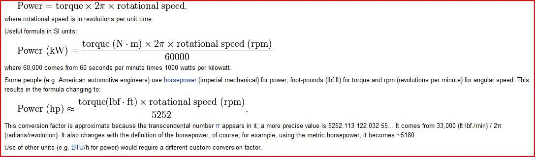

Torque and power are related by an equation so one can be checked with the other and a dyno result easily verified - well it would be easy if we didn't all use so many different units.
Doesn't help haking kph on the base, now gears and wheels have to be considered, particulary comparing one to another - assuming the calibration was done it 3000rpm=??kph.
Anyway - seat of the pants dyno must be a blast, well done, take care and have fun.
extract from below is wiki, not the best reference but easy to find.
