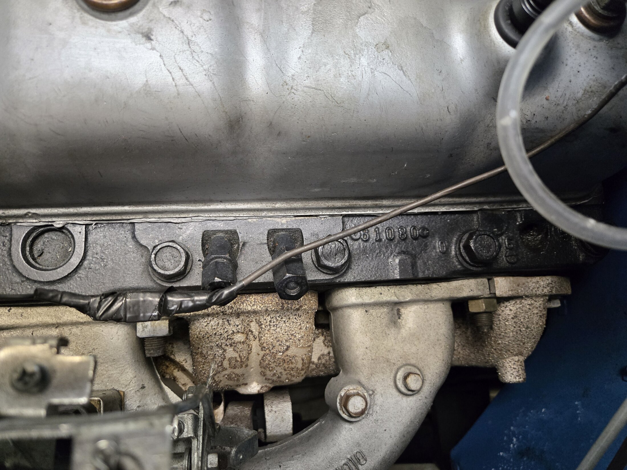

3F Engine in 1975 FJ40
I stand corrected. In looking closer, I think it is a '6''. I apologize. Picture enclosed.
