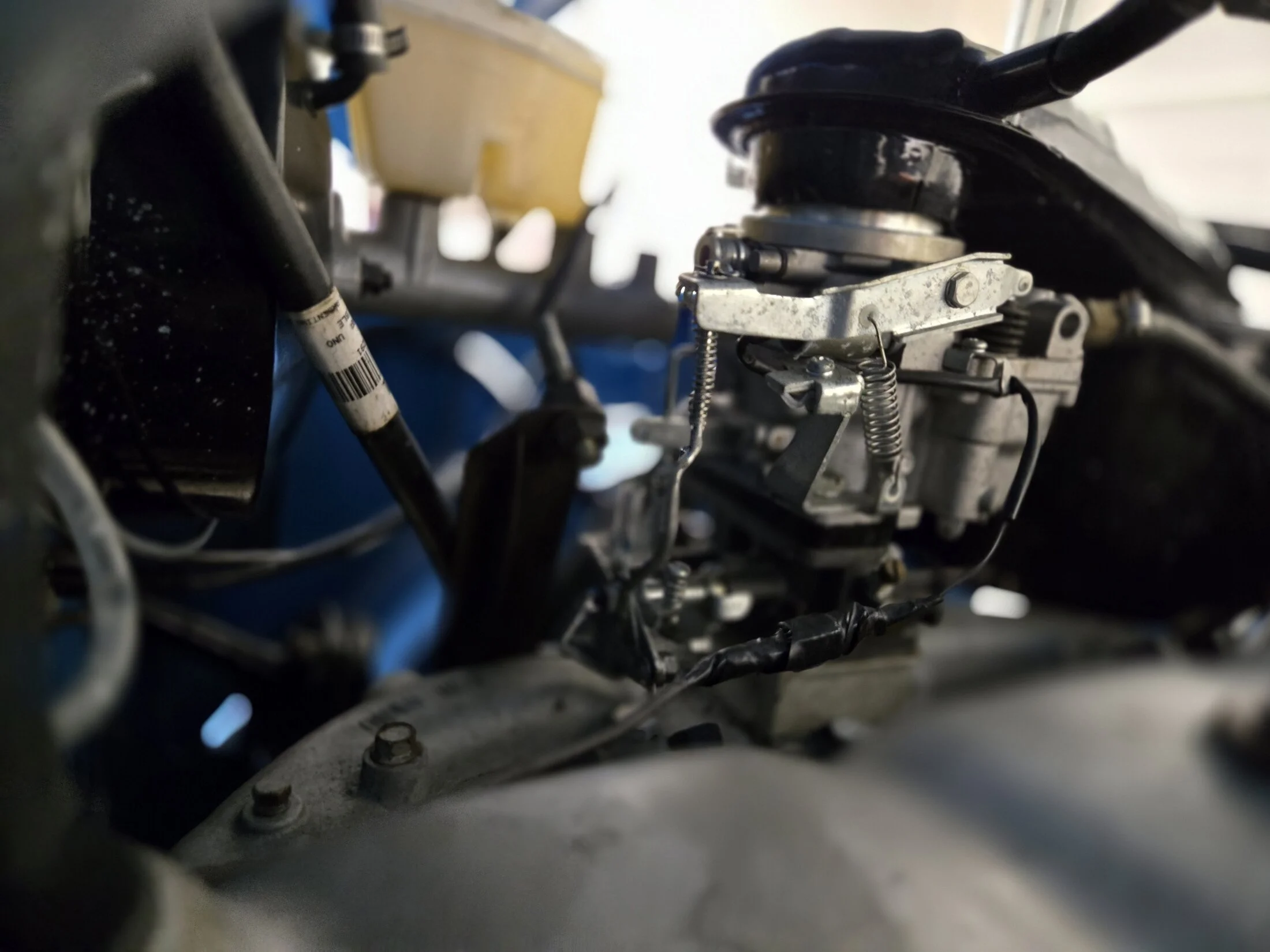

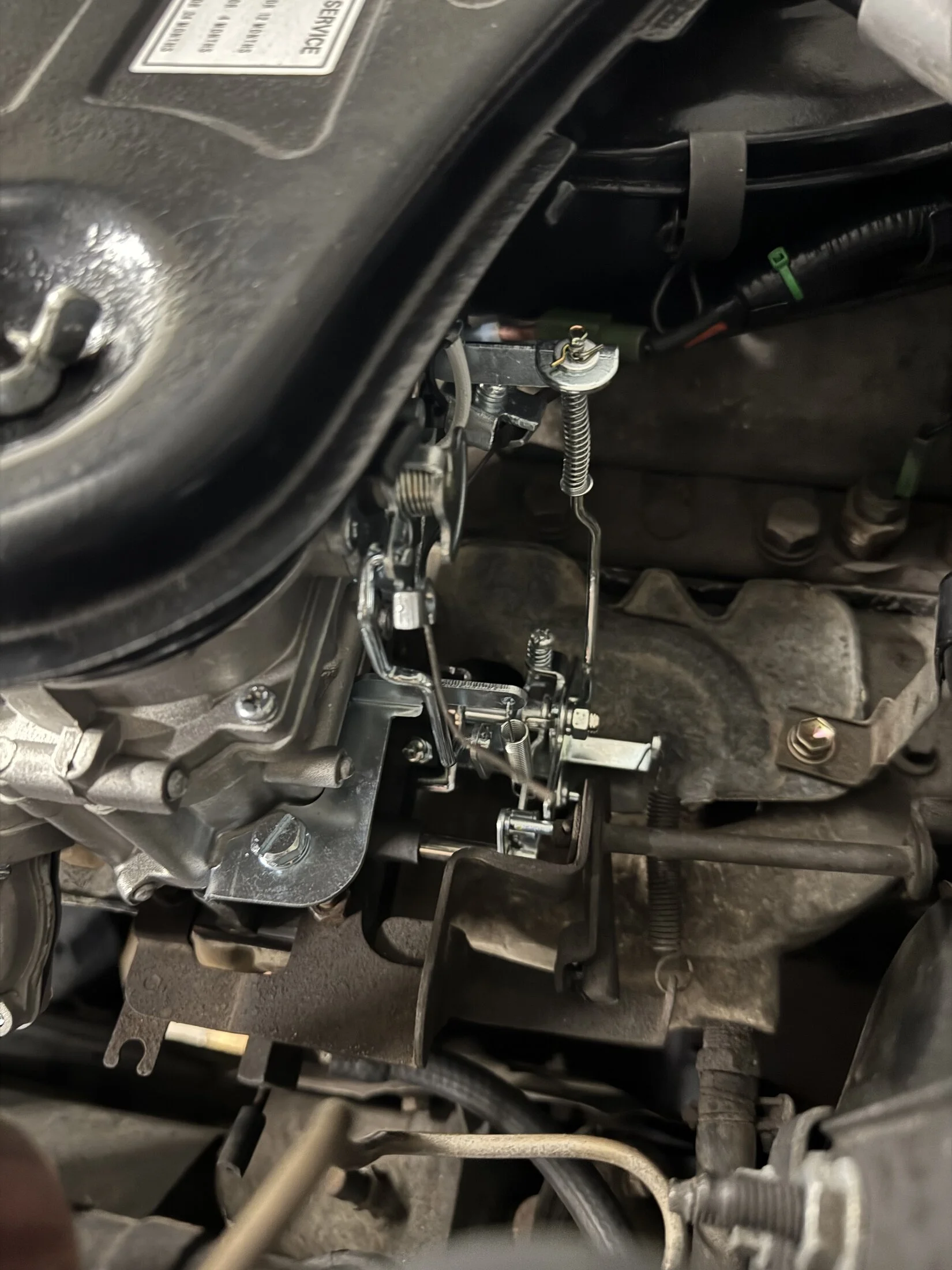

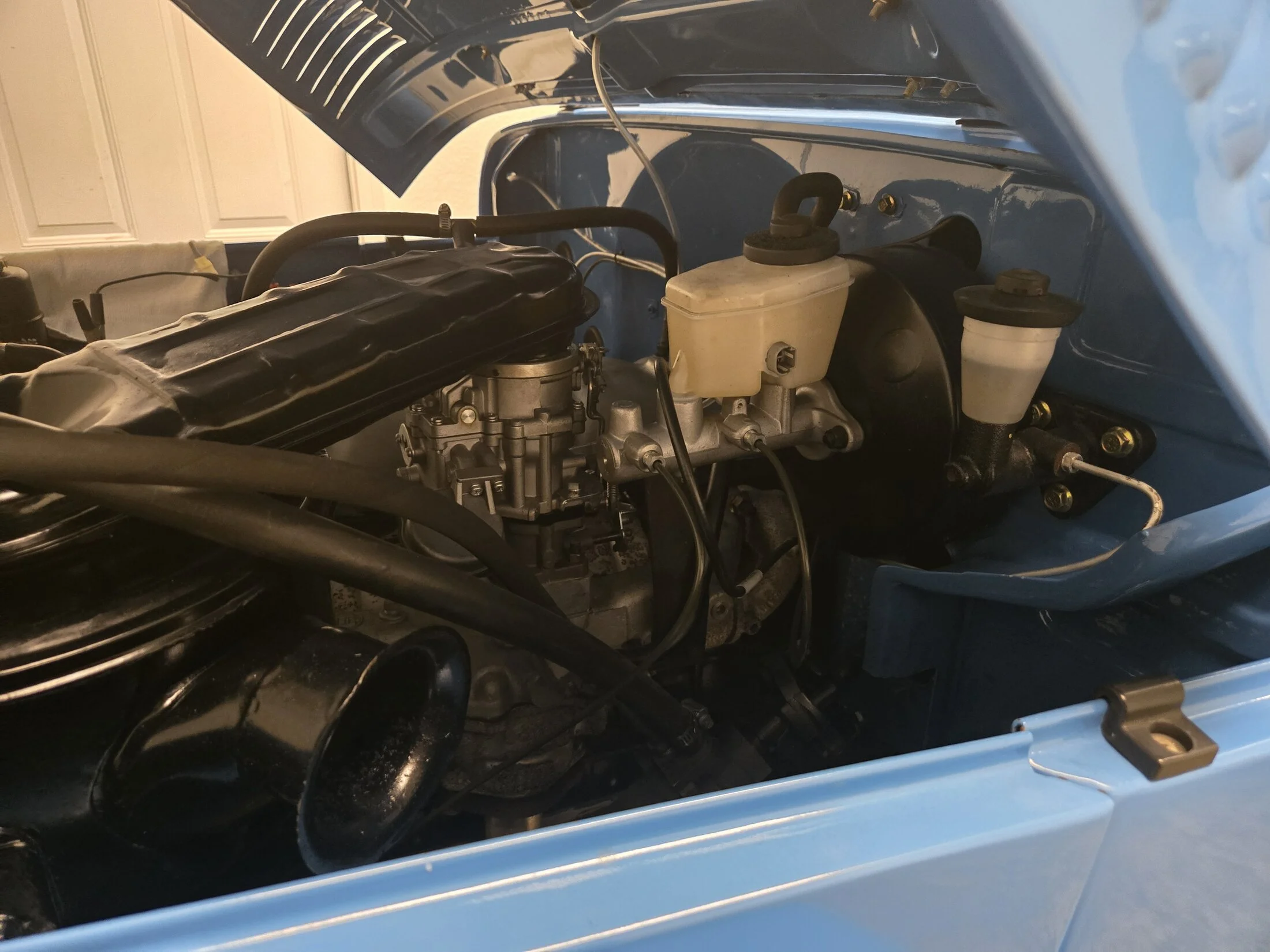

Attempting pictures now. Can only seem to get one picture to attach at a time. Here is the first one and I'll keep working on it.

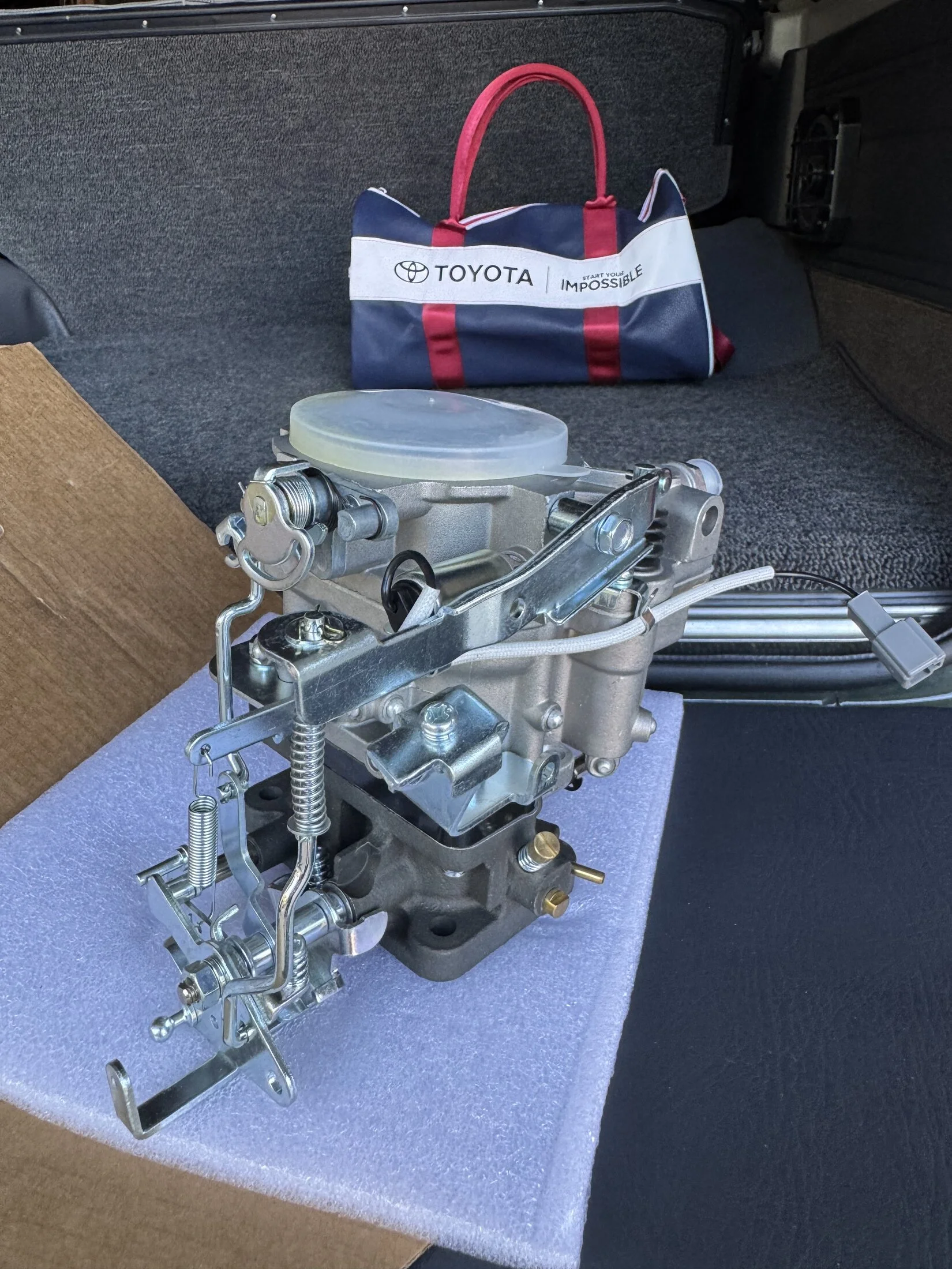

That’s definitely a 3F, block and valve cover, and it has has 2F manifolds and carb on it.

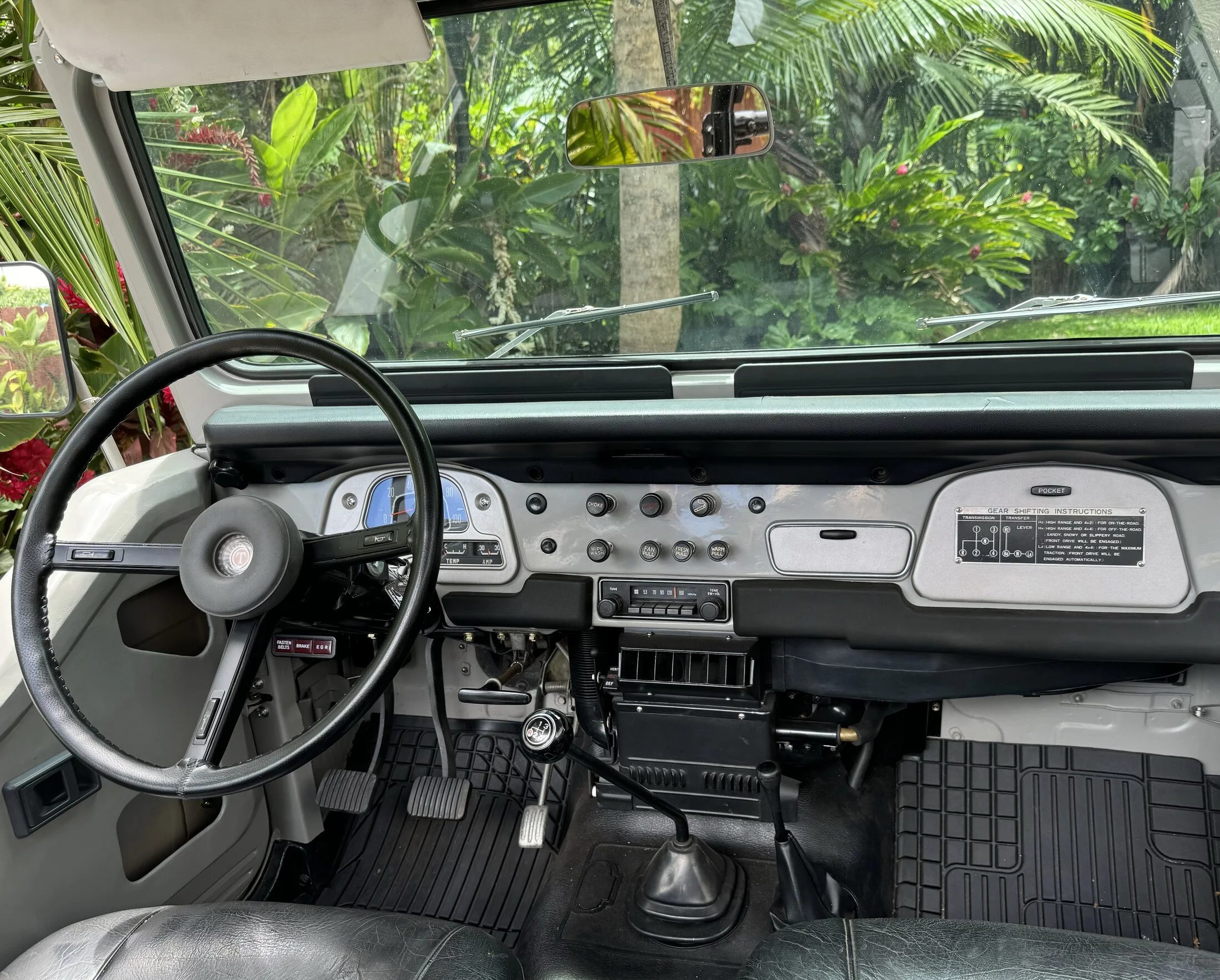

I think you may be overcomplicating this when it comes to installing a manual choke cable. If its a ‘75 dash, you should have a dash hole and then a fire wall hole right behind it for a choke cable (pictures of your dash would help). You could probably find a usable used one for fairly inexpensive, don’t buy a new OEM one since you made need to modify the choke cable wire length to fit your Frankencruiser.
From the photos you posted, It looks like you have a pretty standard Chinese carb copy you can get off Amazon for $60-80. I know this because it look just like mine I got off Amazon that I’m running on my ‘75 fj40 (plugged fuel return port, limited vacuum ports, no Aisan stamping and shiny new hardware and springs).

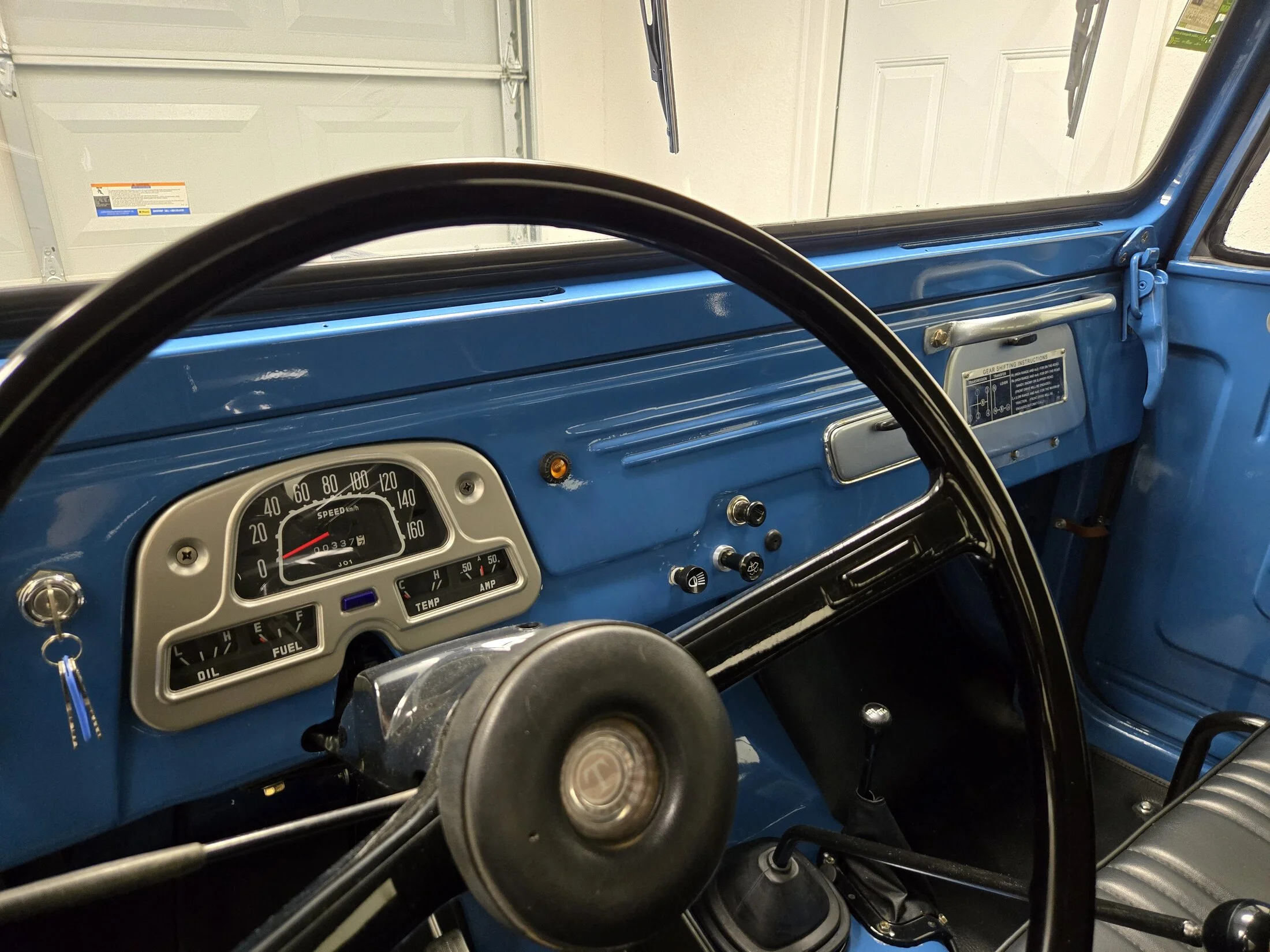

So you can just get a rough measurement from your engine Bay firewall to where it naturally would curve around to the little choke cable sleeve and then the short distance to the choke control mechanism and figure out a way to secure it. Should be very easy to do, I just had to do the very same thing, and then you will have a manual choke option. If you do a rough measurement that way and you buy a used choke cable, you can give at least a rough length of what you are looking for to the seller. But if I had to guess, it looks like you need a choke cable from a ‘75-78 fj40. You could at least start there. What a ‘75 dash should resemble:

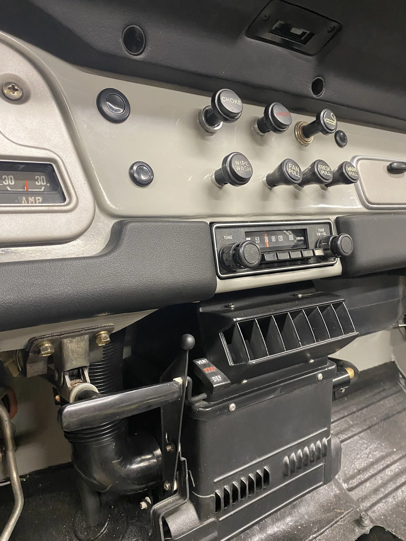

I a enclosing a picture of my dash. Given that this IS a Frankencruiser, it actually has a very sparse,probably pre-1970 dash, so I've been told. I only wished my dash looked like yours. I didn't buy from someone. We (3 friends) had two restored from scratch. Unfortunately, my in-country person did an abysmal job of making sure things were done right, and commensurate with what a US buyer would be looking for. Anyway, it's been a disaster for sue. It's analogous to thinking you can remotely manage a rental property; it doesn't work! It doesn't work because you don't have eyes-on and ability to walk around and see what's really happening. I would never allowed for a Kilometers based panel be used given the platforms were destined for the States. Language difficulties and differences in "what's important" get swept to the wayside in these remote arrangements. Anyway, I've got more money in this thing than I'll ever get out. I'm pretty happy with most of the restoration and paint, minus one glaring unforgivable aspect which I won't go into here, so I think I'll just hang on to it and tinker my way through the myri
ad little issues, maybe until the market improves, and then sell it. Or, just keep it. Attached is a picture of the dash.
