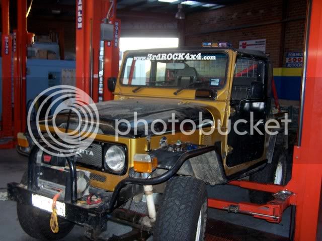

Thermo fan and Craig David water pump now come on with the ignition. Just have to zip tie up a few cables to make it neat.
The ECU is now calibrated for the TPS
Boost is calibrated too and working now though I can only blow 1.5 PSI on the gauge :D
So just the fuel and power steering hoses to hook up :steer:
LAP TOP AND FJ40, SUREAL
Matt - OK - I think your ready for he next FAST AND FURIOUS!!
Ok Sony DVD Handycam on charge :rolleyes:

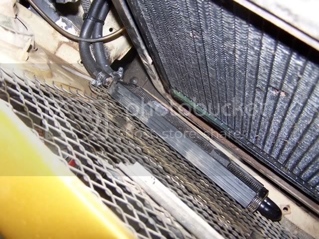

Water pump bypass hose ready to be fitted tomorrow along with all the power steering hoses/cooler, now the steering box is back on after been full rebuilt.
Have to remount the washer bottle, radiator over flow and both horns and reconnect the head lights.
Fingers crossed Wednesday sees the surge tank arrive, Thursday at the latest. If it does transport to the Dyno will be booked for Friday and Dyno on Monday, if not it will be the week after at the very latest as Monday is my free day

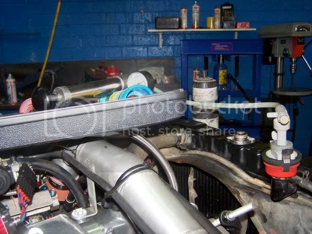

Bypass hose connected water filled and pressure tested.
NO leaks :bounce:
Power steering hoses and cooler fitted and filled.

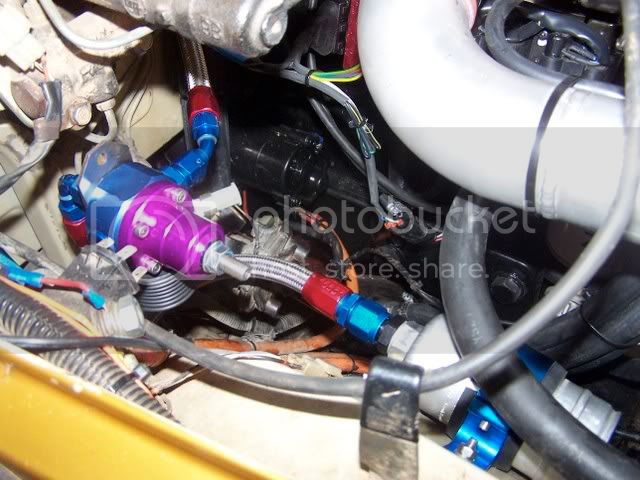

Fuel pump mounted along with the pressure regulator Surge tank comes in lunch time tomorrow. Fuel lines to connect once in place.

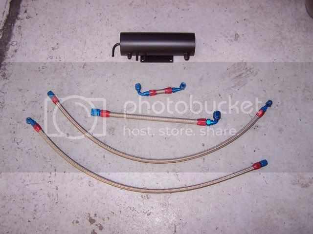

Fuel lines made up.
All connected

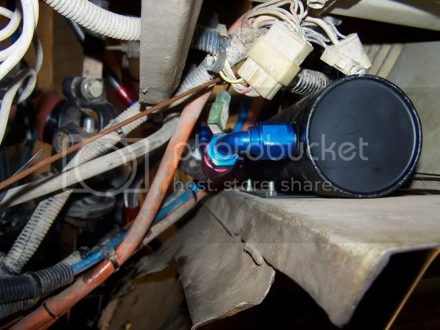

Surge tank mounted.

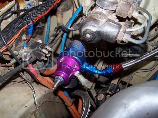

Just need to make a bracket to suit the fuel pressure regulator but still connected up.

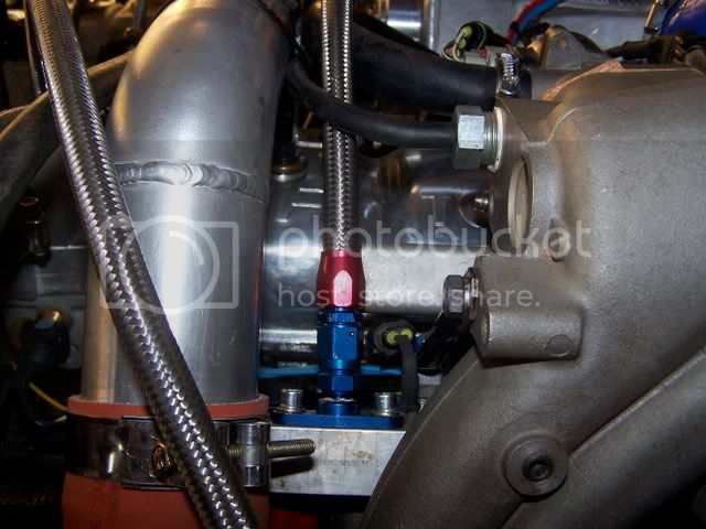

Are you concerned about the stainless hose rubbing on stuff under the hood? I heard it wears-down everything that it touches.
It is a concern but a few choice clamps and zip ties once I have time will suffice.
Things only rub if they move.
