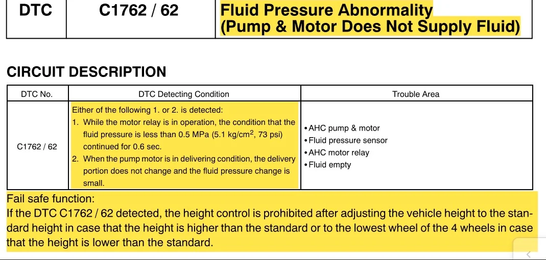

The pump is controlled by the AHC ECU which monitors pressure changes carefully. If the pump runs and detects no increase in pressure, the pump is immediately disabled. To my knowledge, you cannot burn out the pump by running it dry. They system is smart enough to avoid that. What you will create, however, is an annoying level of air bubbles in the system that then need to bled out. You certainly don't want to have a line rupture, but it's not really from a pump health perspective, IMO.
You absolutely can, and my dealer did, burn out a pump by not manually priming it (as the pump is not self-priming). Whether that's the same thing as an already primed pump detecting an issue with pressure and turning itself off is a technicality I can't speak to. But from the AHC nightmare I went through with my own dealer, I wouldn't take the slightest chance with causing AHC problems again.

Did they burn out the pump or did they introduce more air into the assembly than they could figure out how to eliminate and therefore resorted to replacing the pump?
The 100 pump will not run unless it registers immediate pressure increases. That fact tends to make bleeding the system annoying, but makes the pumps pretty hard to kill.
I'd be perplexed if they removed that feature for the 200, but I suppose I could be wrong.

I'm no AHC guru but have read about people getting noise and strange behavior from what turned out to be a clogged filter screen on an otherwise working pump.. fix the clog, problems disappear. Which suggests to me the pump will run even if the pressure doesn't respond as it expects..
When the sludge/gel clog occurs, I think you typically still get *some* flow and pressure, just not much. The 100 pump will also run loudly with a *little* entrained gas or with the gel problem. Once you get a lot of entrained gas or the reservoir runs dry though, the pump shuts off so fast people often think the pump is just dead. It's 0.6 seconds for condition 1 and condition 2 doesn't mention a time, but I suspect it's also very fast. Again, this is all 100 related so surely there are minor differences for the 200. I think there's a wide range where you're building pressure fast enough to avoid the pump shut-off, but there's enough entrained air or pump cavitation to make unpleasant noise.
