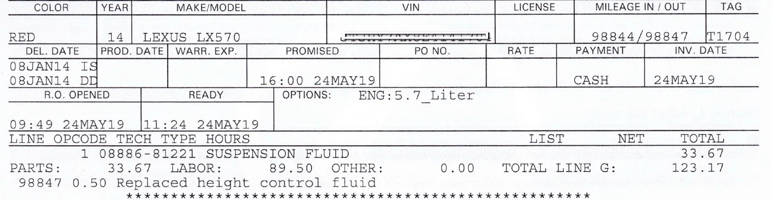

My dealer charged just a 1/2 hour labor, had it done last year when it was in for the seatbelt recall.
My dealer charged just a 1/2 hour labor, had it done last year when it was in for the for the seatbelt recall.
I doubt this was a full flush. It takes 4 liters at $20/liter. Access is indeed in the rear passenger tire well; absolutely no need to remove the bumper.

Does this look right to you guys?
$45 CAD seems like an awfully low amount of $$ for the AHC fluid.

You need a good 4 liters to fully flush it @ $20 usd per liter.
