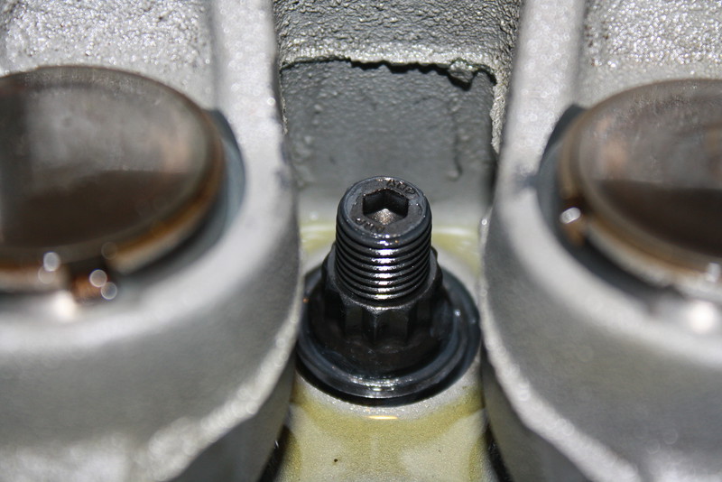

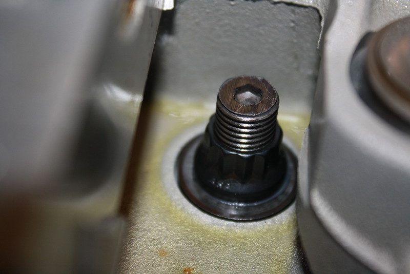

I fitted a stud from the paradise kit on a main cap. It fits nicely. I'll torque to 80 with the ARP lube. I'll check the oil pan clearance carefully, the studs do stick out just a bit more, it looks like there is plenty of room though.
Then I'll use the Opel kit up top @ 80 ft lbs as well. It will be here tomorrow. $400 worth of bolts. I was getting concerned about the bottom end bolts anyways. When I measured them they were nearly at, but not quite at the 'replace' spec.
Very recently I ordered the same kit from Paradise Racing. I installed an OEM HG which is approximately .050 thick maybe a little more. I ended up with two threads above the nut. How thick is you Cometic HG? How deep is the stud in the block? Not necessary to bottom out the studs because most of the holding is done by the first 10 threads, that is why Toyota says to measure their bolts where they do. These studs worked very well for me.

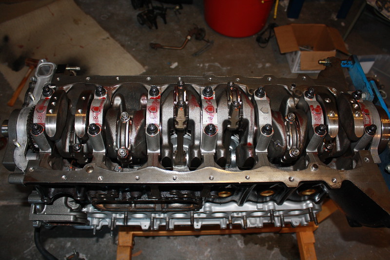

Before you get ahead of yourself and me being lazy not wanting to scroll back to page 1 of this build thread. I hope you plastigauge your main bearing and thrust bearing for the proper oil clearance.

All of the above. I used a Turlen precision dial indicator on the thrust and have my torque wrench certified for aviation use. Plastigage was laid down a while back...

So there they are. All 14 paradise studs mounted and torqued.

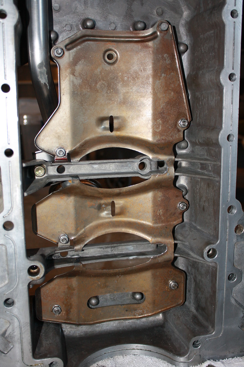

They stick up a bit higher than the OEM bolts so I started test fitting the oil pan. I had to modify the windage tray to get four bolts to clear near the rear.
I used a die grinder to grind out some clearance on the windage tray and then cleaned it up with a file. Came out OK. I'm not saying you should do this, but it's what I did. Keep reading to find out what went wrong, it had nothing to do with this.
