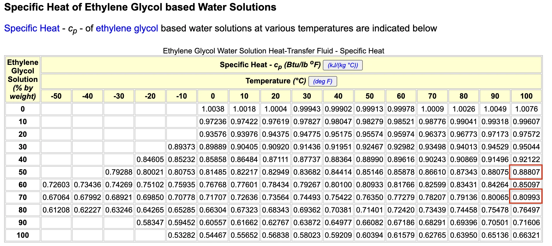

Looking at the heat transfer properties of ethylene glycol / water mixtures, it looks like the specific heat of 70% glycol mixture is about 10% lower than that of a standard 50% mixture:
So that makes sense that this will increase the delta T across the radiator and engine block / head, leading to higher peak temperatures.

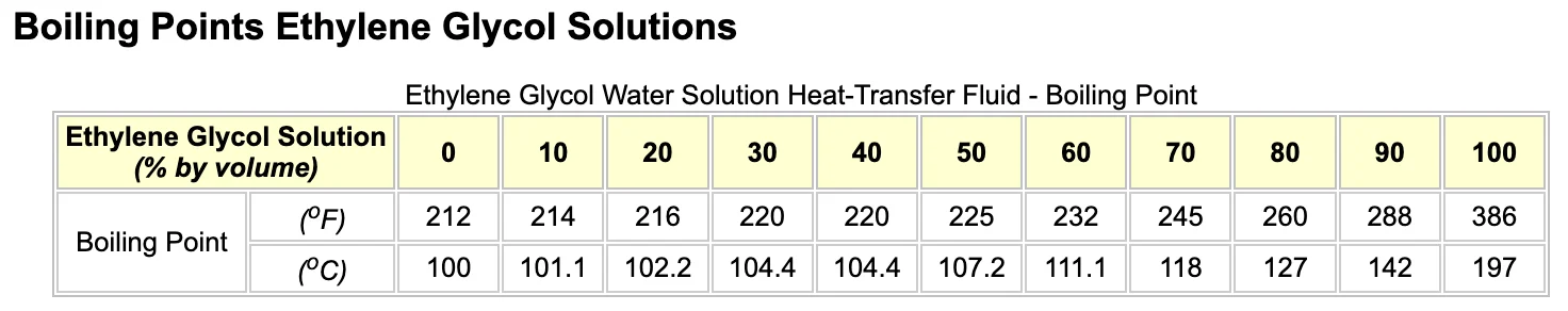

At the same time however, the boiling point of the coolant increases as well - from about 225F / 107C to 245F / 118C.
(In addition to that, there is the coolant system pressure induced boiling point increase, which is at least 20F above atmospheric even in higher elevations. This effect should be similar for both mixtures)
--> So with going from 50% to 70% glycol, cooling system loses about 10% capacity. However at the same time, the boiling point increases by 20F. This means the system can run 20F hotter before it boils over and really any damage is caused. A 20F hotter coolant system will increase the heat transfer across the radiator at an ambient temperature of say 80F and coolant temp of 220F by about 20F / (220F-80F) = about 15%. So it should about compensate for the lower heat capacity of the coolant.
Altogether, I would expect a system with a higher glycol % to run hotter, but not boil over sooner than one with lower % of glycol in it.
