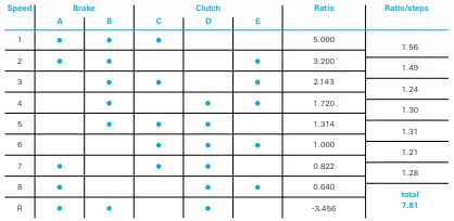

Some interesting stuff off the brochure:
https://www.zf.com/products/media/en/product_media/cars_5/zf_pkw_getriebebroschuere2017_de_web.pdf
shift table:
