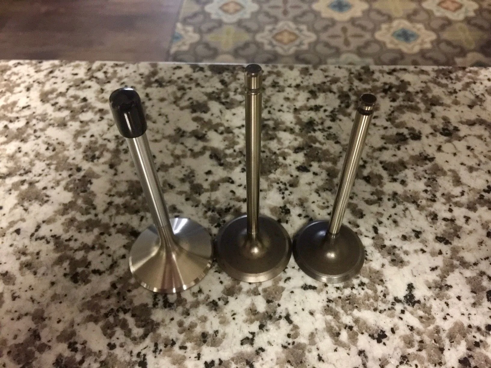

Just to throw this out there. I ordered a Lexus GS-F valve (part number 13711-38050) because I heard it was titanium and I didn't believe that you could buy a Ti valve for $14 from Toyota when they are like $140 from Ferrea. But sure enough it is a 38mm titanium valve which is the stock cruiser diameter. It does have a smaller shaft diameter (5mm vs 7mm) so you would need custom guides and is a little longer so would require machining but it is crazy how much lighter it is than the 41mm Ferrea valve I have for my truck. I haven't put them on the scale yet but I bet it is 1/2 the weight.
L to R
41mm Ferrea LC valve, 38mm GS-F Ti valve, 34.5mm 3UZFE valve.

The 38mm Ti valve weighed 29.7g on my scale and the Ferrea 41mm LC valve was 74.6g. Huge difference.
And yes Hazard they are longer. The Ti valves are 105.84mm and the Ferrea valves are 98.88mm, so you would need to have them machined, but at a price difference of $14*12= $168, vs $140*12=$1680 you should be able to have them machined and DLC coated and still have a bunch of money left over. lol.

Great guess on the weight being 1/2!
Also, the stems are 5.5 mm... 5 mm would be pushing it on the durability side of things! I suspect the valves are already coated, so you'll only need to recoat where it is machined. They utilize, at least on the intake, the same guides and seats as the steel valves.
Here's the big secret with these valves, they are sinter forged/powdered metal. There's a paper about them floating around out there. Toyota spent a big chunk of the 90's developing them, and I'm sure they've improved over the years as they see use, as mentioned above, on the exhaust side now. They material first saw use in the 1998 3S-GE BEAMS Engine valves.
Yep you’re absolutely right. 5.5mm, they just felt pretty tiny in my hand after holding the much bigger 1FZ valve.
That’s interesting that they are a sinter forged titanium. I didn’t know such a thing existed. But that would probably explain some of the surface patterning I am seeing.
It seems like a very interesting piece. Even though I am mentioning it here for a 1FZ all out build my idea was originally to use them in a 3UZ. And even when compared to a 3UZ valve that has the same diameter stem and an even smaller head (38mm vs 34.5mm) they weigh much less (29.7g vs 46g)

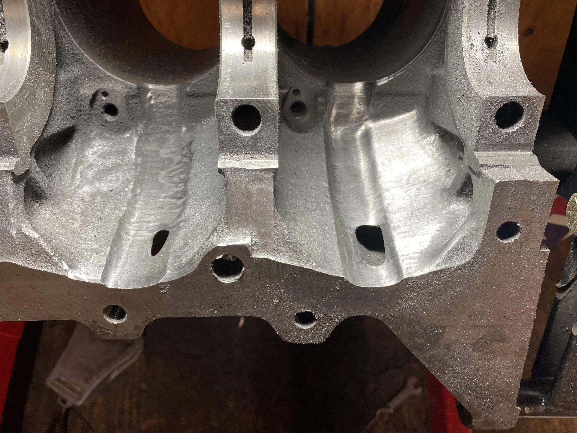

Mounted a piston so I could clearance the block for the stroke. This is what a stock piston look like hanging on a 114mm crank. Stock length rod, 14mm longer stroke than stock. New pistons will fix that.
Clearancing all done. Just going to polish it up a bit then next stop machine shop. I have purchased a torque plat for boring and honing, $600.
Many holes in block but I know how to fix. All feeling a little scary now, lot of bucks this thing better run. Probably another year yet the way I am going. Gotta leave now, back to my 80 in Baja for a couple weeks.

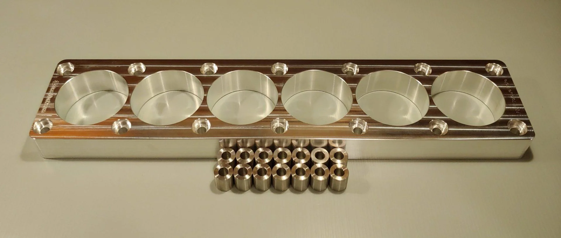

Torque plate
I found two places for torque plates, one was DeeWorks in Quebec Canada. $600, its in transit now.
Torque Plate for Toyota 1FZ-FE Engine 103mm Max Bore
https://www.deeworks.ca/wp-content/uploads/2018/10/DSC_0138-e1539115604771.jpg
Torque Plate for Toyota 1FZ-FE Engine 103mm Max Bore quantity
Description $460.00 USD 4 in stock
If you are here, you know what these are for. Most serious engine rebuilder will use one of these plate when boring a block. It is easy to see if a block has been honed with or without a plate just by out of round the bore can get once everything is torqued down. These plate simulate the stress of a fully torqued head when doing the cylinder bore honing. I make a lot of torque plate for different engine and got asked to do the Toyota 1FZ-FE torque plate. I now stock these from now on! These plate will fit on all 1FZ-FE Toyota Engine with a maximum bore of 103mm.They are CNC machined out of 2″ thick 6061-T6 aluminum. Stainless steel insert are included so it can be used numerous time without damaging the mounting hole. They also give you close to stock height of a head so you can use your old head bolt to torque down the plate.It is suitable for bore up to 103MM for those seeking maximum displacement on these engine, but they obviously can be used on smaller bore too.
I can make custom bore at no extra charge!
