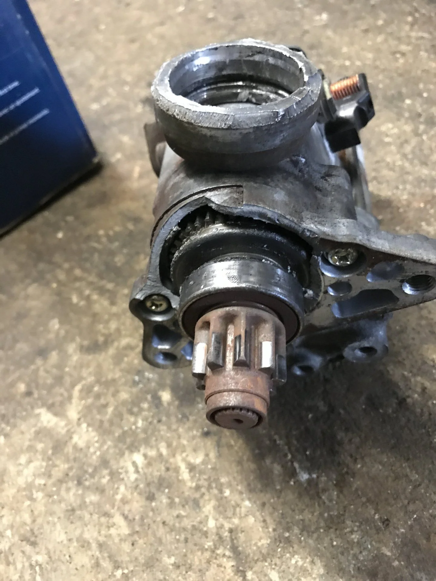

The engine did run...it was still warm when I got there...and the fact that it pushed a rod through the oil pan is not lost on me. We ordered a used motor and will begin the replacement on Monday...Here is a pic of the starter...the housing broke upon removal. @flintknapper, yes, tons of unanswered questions. Once the motor is out, I will take a look inside the cylinders...hopefully that will shed some light on the situation. I am still not too happy about the motor being blown up...so I just have to grin and bear it. I guess IF there a silver lining...it makes baselining the new engine easy...
That looks to me like the housing was over stressed upon installation, like it was put in and torqued to force it to seat, maybe at an angle. Or perhaps it was left at and angle binding the gear to the flexplate where it then over stressed the housing causing the failure. Sounds like he should stick to working on tractors.

Was that the starter picture before or after rod broke?

@2001LC, The starter damage was pre-thrown rod. We found a 99 LX470 that was rear ended...motor has 124K on the clock and the seller will provide VIN with motor. And I think you hit the nail on the head...moving forward is the best way to maintain my sanity. I will see what the motor will forensically tell me and go from there. Dropping off the TB kit tomorrow...should have the truck back by the end of the week.

@ BillZ260 - the starter flange broke during the removal process (the original gripe that had the LX in the shop)...not associated with the broken rod directly.
I'll assume they broke starter more less accidently after removal, knowing they were replacing.

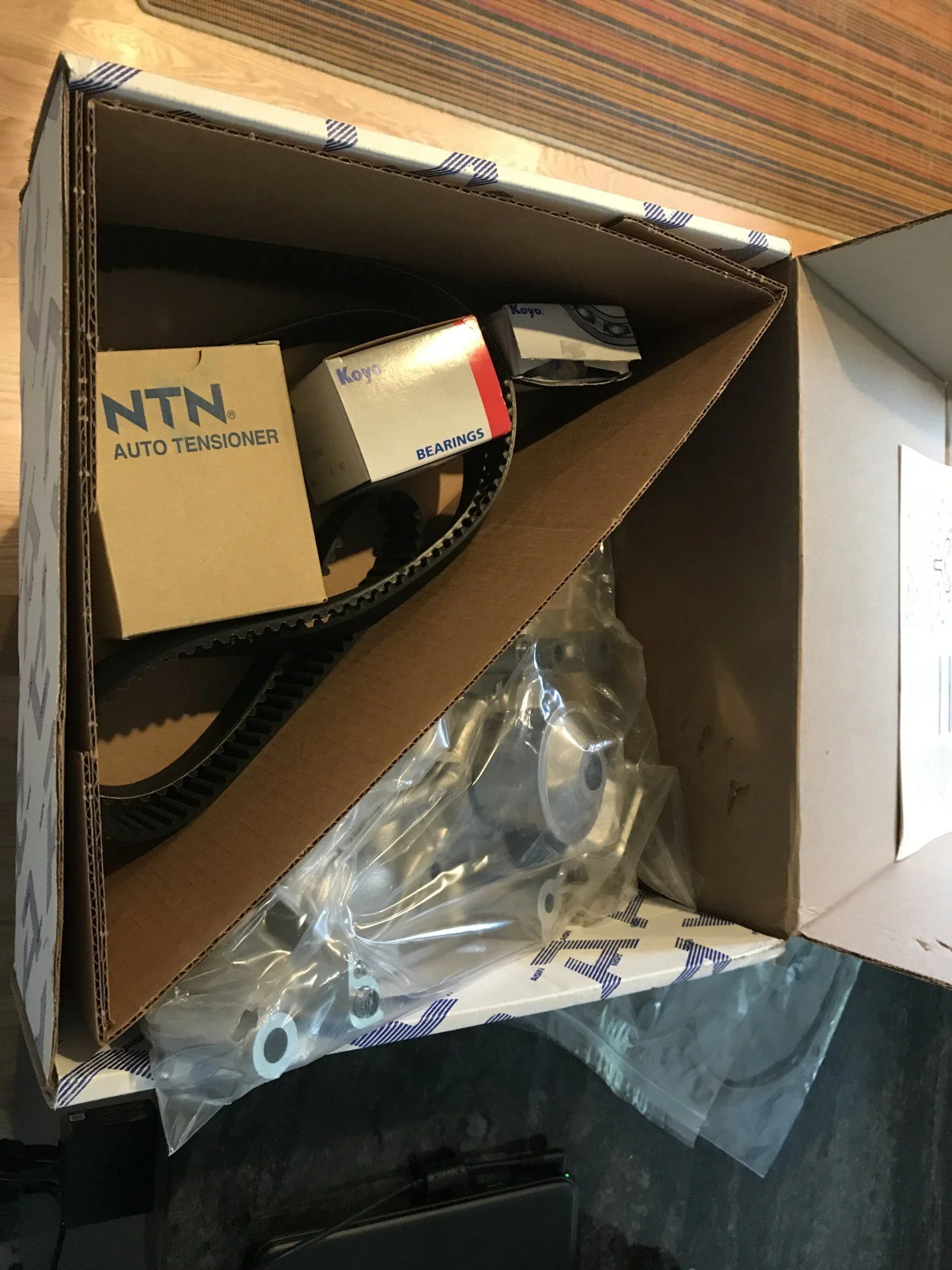

Got the TB kit...Mobil 1, and Toyota Red Anti-Freeze today...motor arrives tomorrow...
