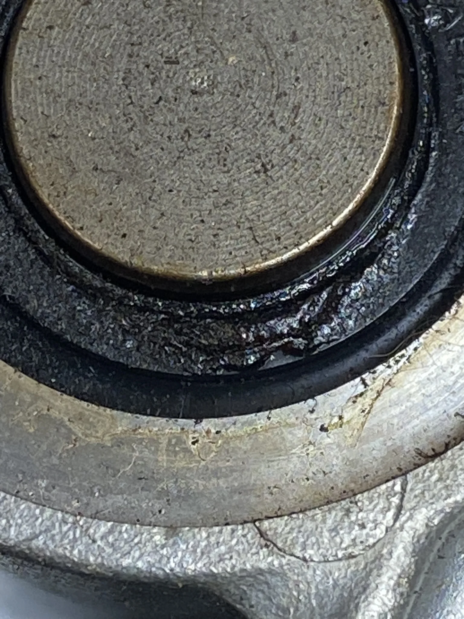

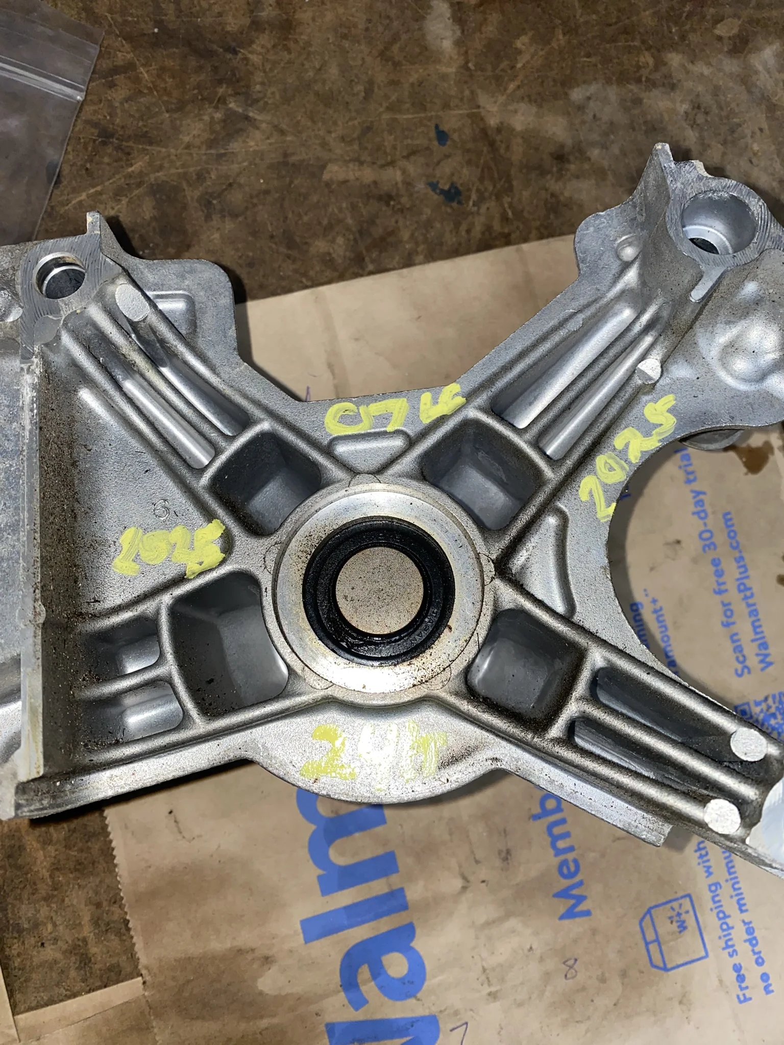

The 24k 07LC I'm doing a baseline on now. Had great looking fan belt. But due to age, I replaced it. I also found fan bracket bad.
