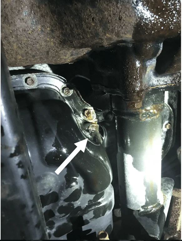

I went over to look at the vehicle, it sucked. It appears there is a broken connecting rod (broken at the wrist) and it punched a hole in the aluminum oil pan. I am screwed...the motor had 121K on the clock, and was running perfectly until today. I don't know what my options are...I am not really comfortable just replacing the offending rod and piston.

As for pulling the pan...agreed...but you can see the snapped rod through the hole (not in the pic though, crappy cell phone pic, and I was mad)...

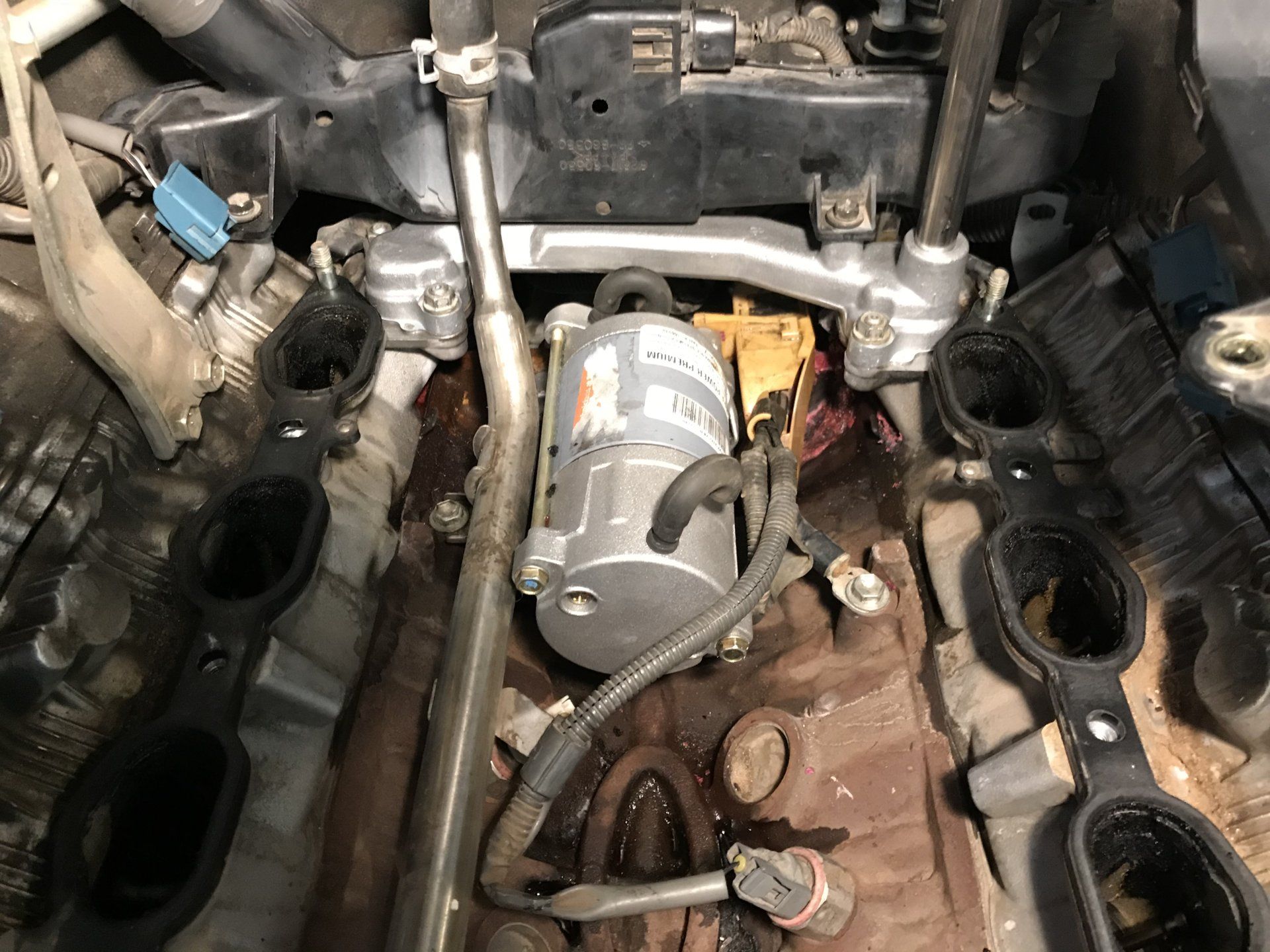

Yeah...trying to figure out how to approach that aspect of it...I need to find someone with a bore scope. He did mention there was some issue getting the starter off (he showed me a piece of the starter that broke off during the replacement). I am also trying to be reasonable as a consumer...I just bought this beast (In Nov 2017) and paid quite a bit for it because it was rust free, blah, blah, blah...not really thrilled at having to drop another $5K for a motor replacement. I guess if I had to find a silver lining it would be I would hope that we can find a low mileage motor that has already had the TB replaced...I am still in a mood about this...I need some good news today.
@Flintnapper...thanks for this photo...seeing this, and hearing my mechanic say it took him 5 hours (after the intake was removed) gives me cause to believe something might have made it's way into the cylinder or flywheel area.
Yes, look in the spark plug hole with a bore scope. Maybe a nut or his missing socket fell in there thru the intake runner and jammed the valve open and the piston crashed.
