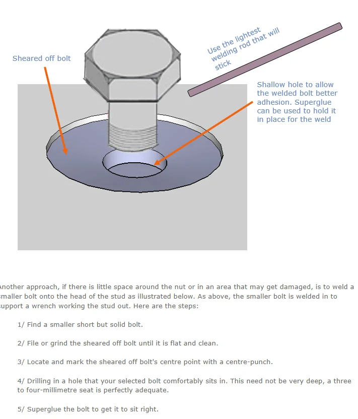

It fits perfectly, but I need to figure out how to get this broken M8 bolt out so I can mount it.
Weld a smaller bolt on what's left (if there's room) and unscrew it.
I agree with what he said, but I think he meant weld a Nut on it....
Someone did not do you any favors with that off center drilled hole. Big chance of welding what is left to the side.....
Maybe get some round stock and push in that hole first... Then try to weld the nut on there. I typically use a nut a little smaller than the bolt.
I'm with 2fpower welding a not on there. with a nut you can rosette weld the center of the nut.
With a bolt in the application I see to much of a chance of welding it to the frame. JMHO ;)
You can try drilling that hole a little more, being VERY careful to not get into the threads in the frame. You are trying to weaken the sidewalk of the bolt.
Another option is to punch a starter as centered as you can and drill a new hole. You will need to be very careful as it will want to catch on the edge of the existing hole. If you can get a more centered hole, you can try an easy-out/extractor. I find that pb blasting helps before you drill as the heat can sometimes help break up the stuck threads.
And I am assuming that you are not like cky enough to have a cutout on the inside of the frame where you could reach in with some vise grips (needle nose). If you can, you can actually turn it to goo deeper and come out the backside of the hole.

Part of what the welding does is heat it up to help break it lose. but if you don't weld then that not going to help.
The only other way I see like others have said is drill. I'm thinking a series of small holes around the edge of the bolt tell you can get it out and plan on drilling a overs sized hole and tap to the next size bolt
