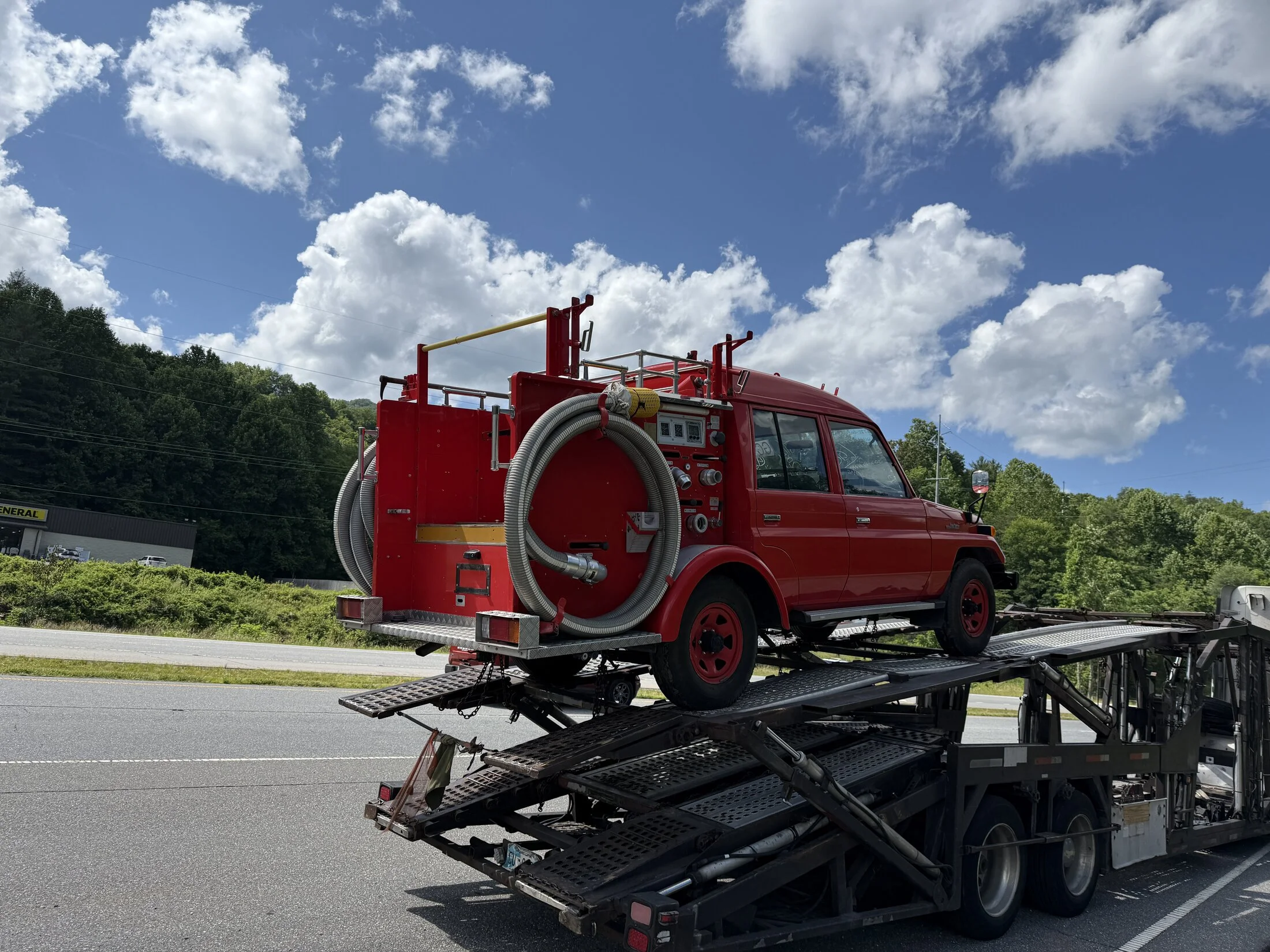

Truck arrived today from Jacksonville port to Western NC. Progressive won’t let me add this since it’s a “fire truck”. State Farm has a good policy with these kinds of things, so I’m switching my other cars over.
Hopefully that’s smooth. Then it’s registration and starting work on the pump pto. Needs some sound deadening and hood lifts asap.

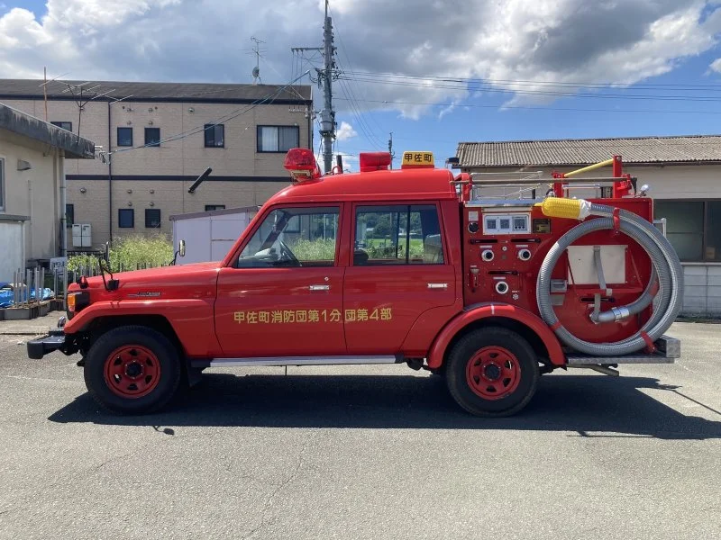

I'm curious what everyone is doing with the "fire truck" piece behind the cab where a new bed or tray back goes?
Seems wasteful to scrap it, but I don't know who would be able to use it or who would be a buyer.
Another guy in here said the mechanic took it in exchange for removing it. I don’t know what I’m going to do with it, probably scrap it. Chatting with a few local folks I’m hoping somebody can let me use their shop and pay them for a dozen hours and let them take it and do as they please with it.
I have some friends who are wild land firefighters but they didn’t want it, they want the whole truck lol.
It will be a fun ride. When you are finished you will love it…not much use for the box on the back. Really just a shell and all the piping hidden. I gave mine to a friend who did most of the work. Not sure what his plans are for it….I do know it was lots of weight… I think it was around 2300 lbs. can’t remember for sure but its in my thread…I drive mine everyday.

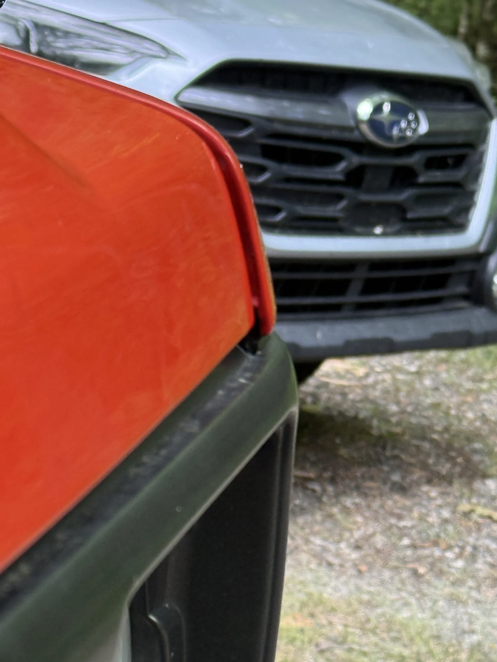

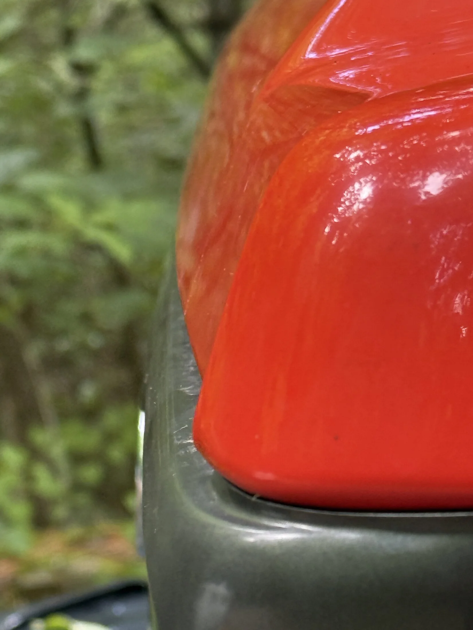

bonnet had some play and was vibrating like crazy, so increased height on the bump stops. It appears that the passenger side is not aligned perfectly, l will get new ones but for now the vibration isn’t visible.

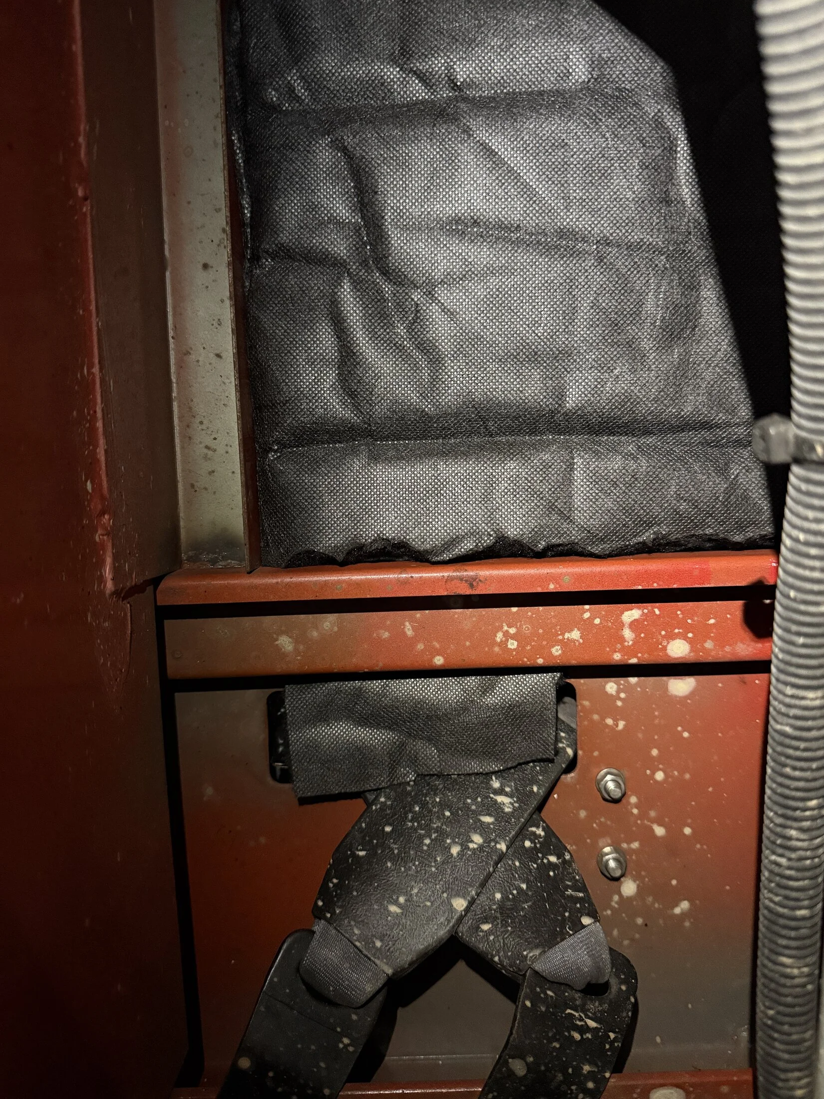

Temporarily added some Dynamat plus 1inch Dynacore glued together to take the pups for a ride around the property, didn’t want them having a traumatic experience lol. Noise from back is almost gone, I can just hear engine noise now.

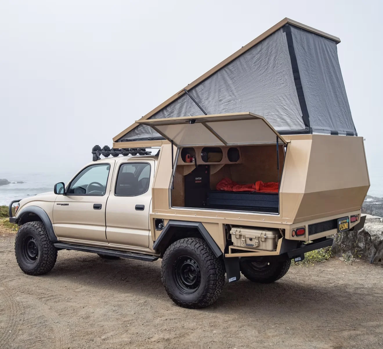

I’m pretty sure it’s a uteltd tray. SET one would be great but I think they are too expensive. I plan to throw a OVRLND flatbed pop-up on there once I figure out the flatbed part.
I’ve thought about custom camper that’s a cross between ellieoverland x overlanderunderbudget but I’m too much of a noob for that and none of CAD friends live near me to help. Truck is already big project for me and way over my head but all the build threads here makes it feel slightly more doable and interesting.
