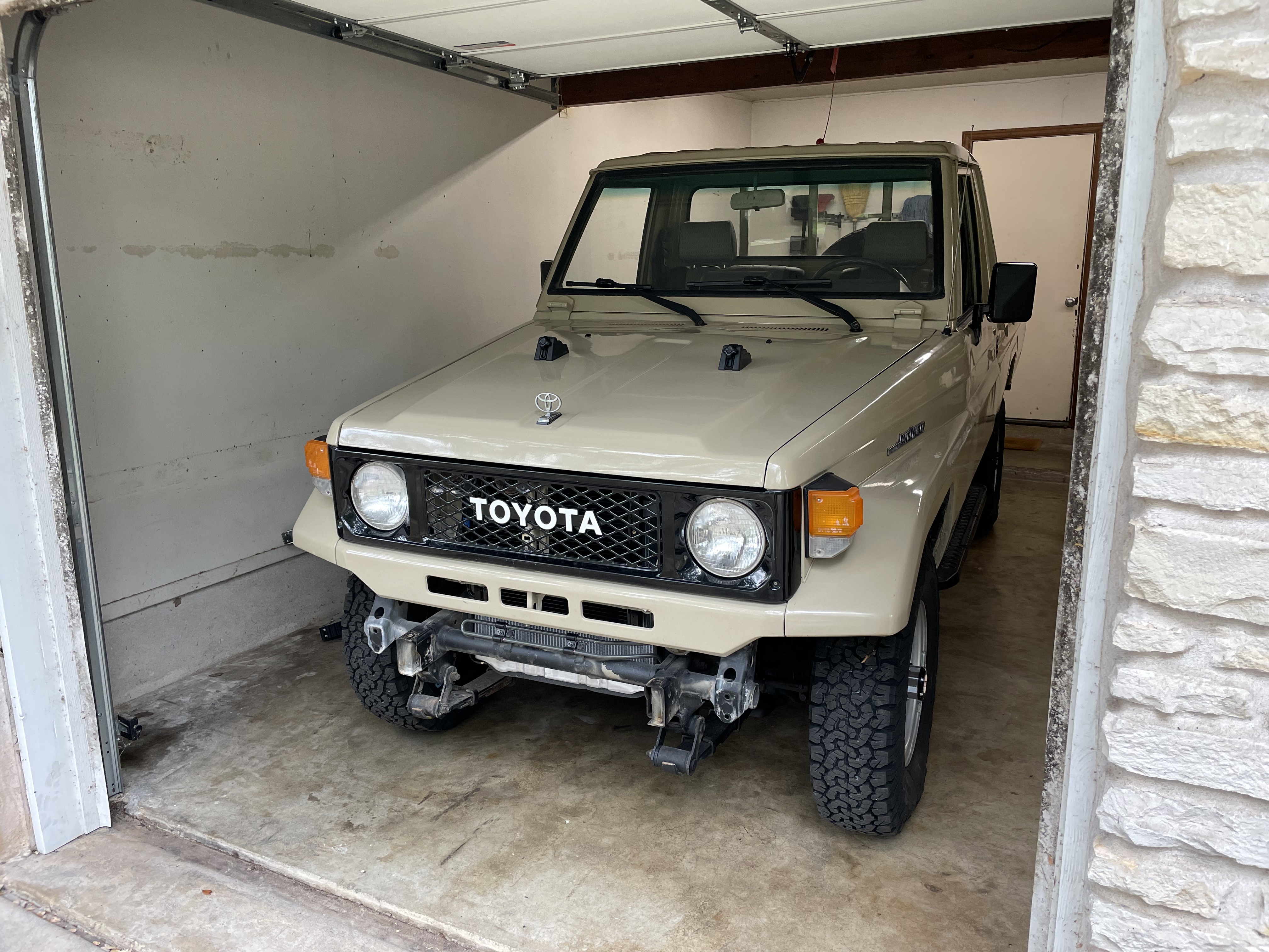

Milestone Day. It left the garage under its own power!
I’m still waiting on the hood from the body shop.
Lots of little things to do to get it road worthy.

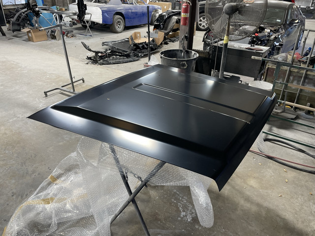

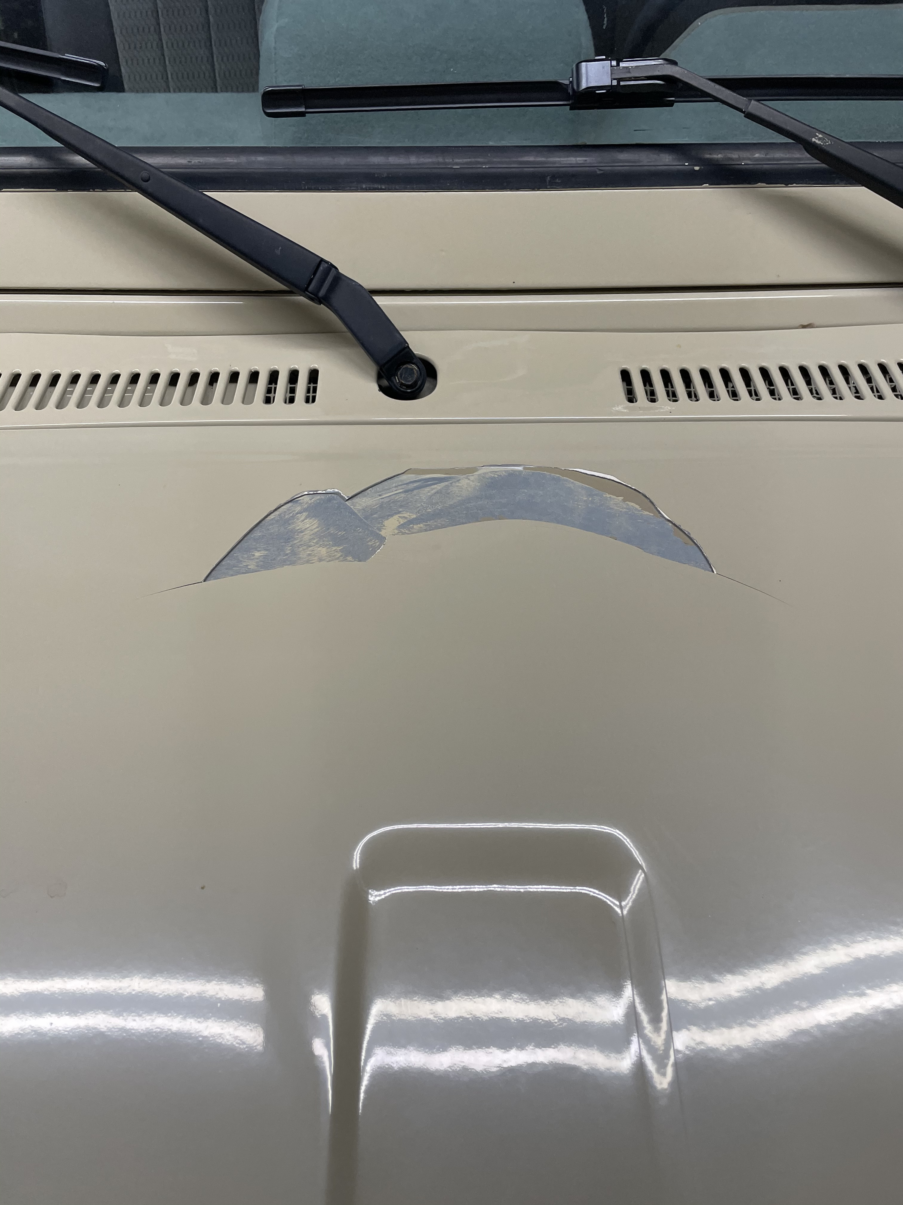

I think I mentioned earlier in the thread - Prior to my ownership, it appears the hood came open at speed. The original sellers from Qatar bondo'd the hell out of it before repaint. Then it started cracking/flaking in big chunks. I took the hood to my body-shop, but it was non-repairable (or they simply didn't want to repair it).
I ordered a new hood from PartSouq, and it came in this week. I was very impressed with how they packaged it. Only minor cosmetic damage at one of the corners that can be easily repaired. Not bad considering it came all the way from Dubai! (As an aside, I love PartSouq).
I convinced the body shop to paint-match a different donor panel so I could take my old hood back and temporarily install it on the truck for further shakedown.

Then I took the truck for a quick spin around the neighborhood.
Overall I am very pleased with the truck. It's actually surreal being able to drive it again. I am super-grateful to be able to own such a piece of machinery. And also very grateful for all the the friends and acquaintances (and the Mud community in general :flipoff2:) that has helped me get to this point. Land Cruiser people are really special and I am grateful for that.

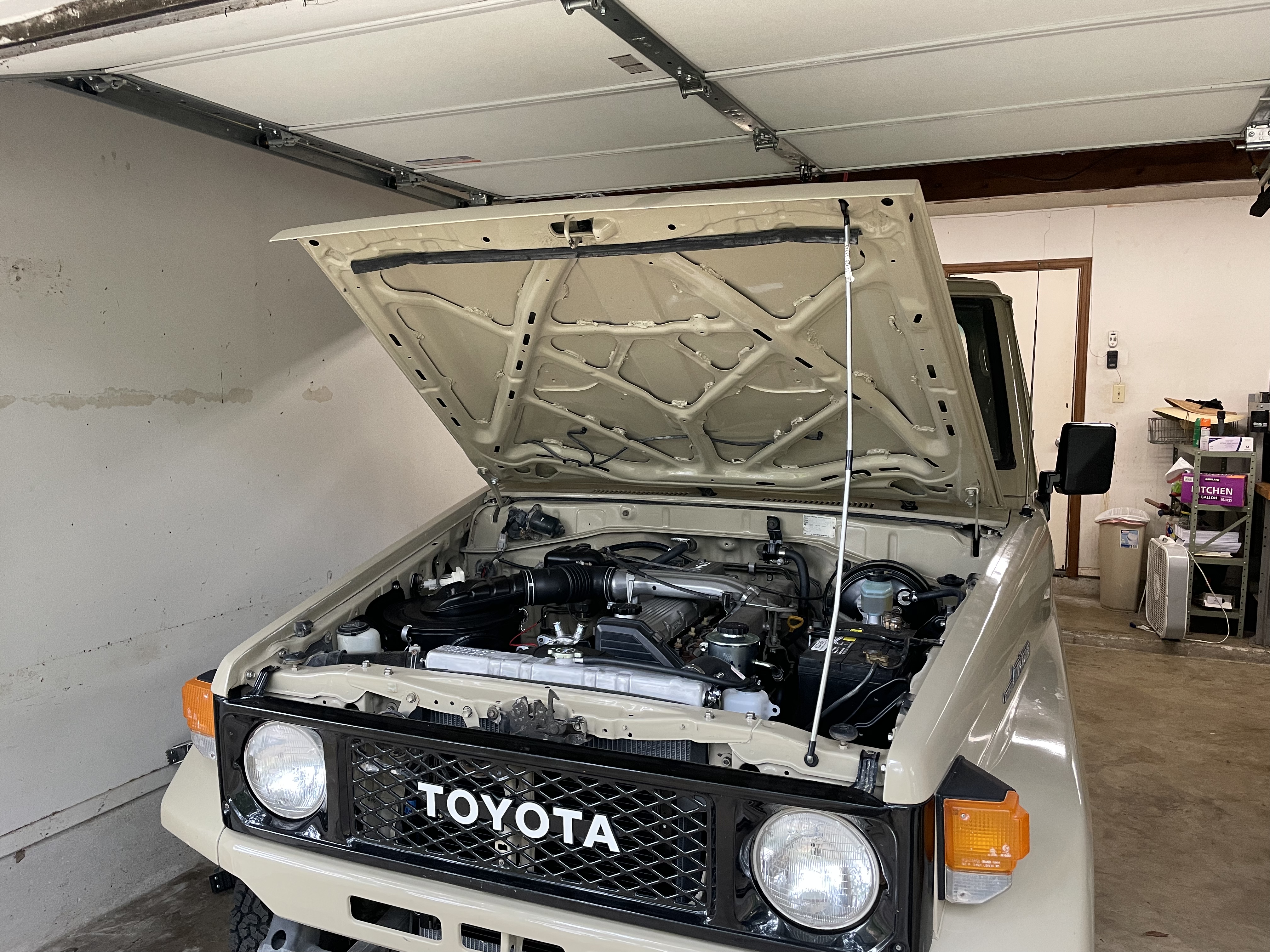

So it looks like your new hood does not have the holes for the windshield frame bumpstops or is that just not showing in the pictures ?
That is correct. The new hood does not have the holes or reinforcement for the fold-down windshield cradles or the provision for the Toyota Ellipses hood ornament. I am keeping both hoods. But for now, the new replacement hood will remain unadorned.
