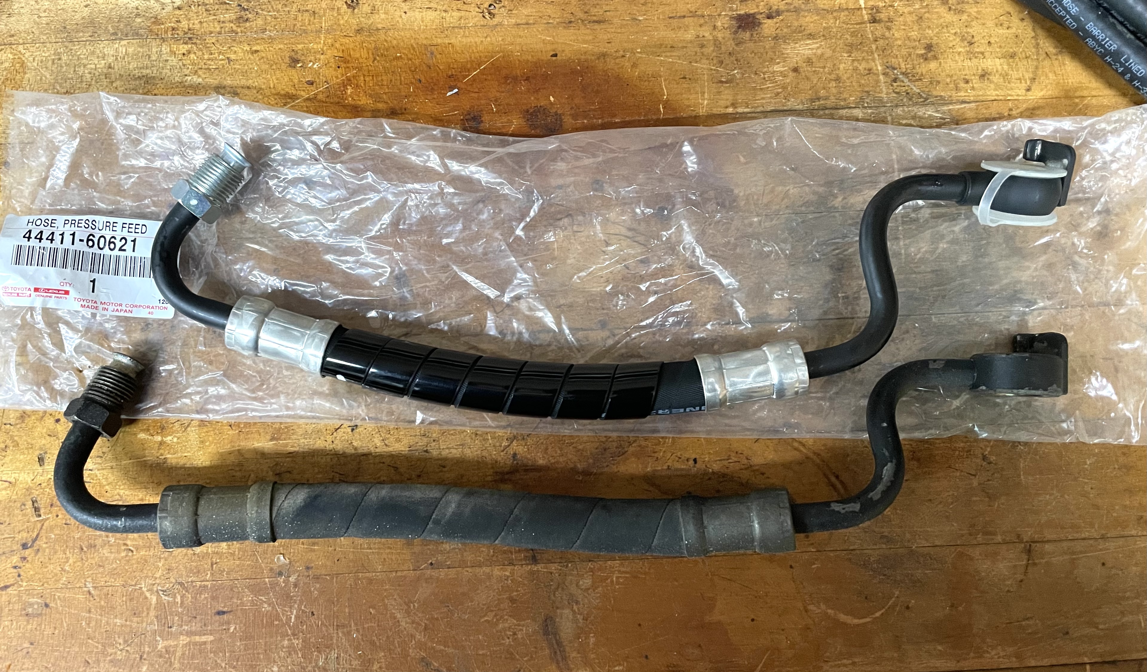

The high-pressure power steering hose for my HZJ75 is NLA, so I took a gamble and ordered the HZJ79 hose. They are identical.
Thought this might be helpful for someone else in the future.
Toyota PN: 44411-60621
Don’t forget the copper crush washers. Add a dab of grease to them and they’ll stay in place on the banjo fitting while you thread it on.

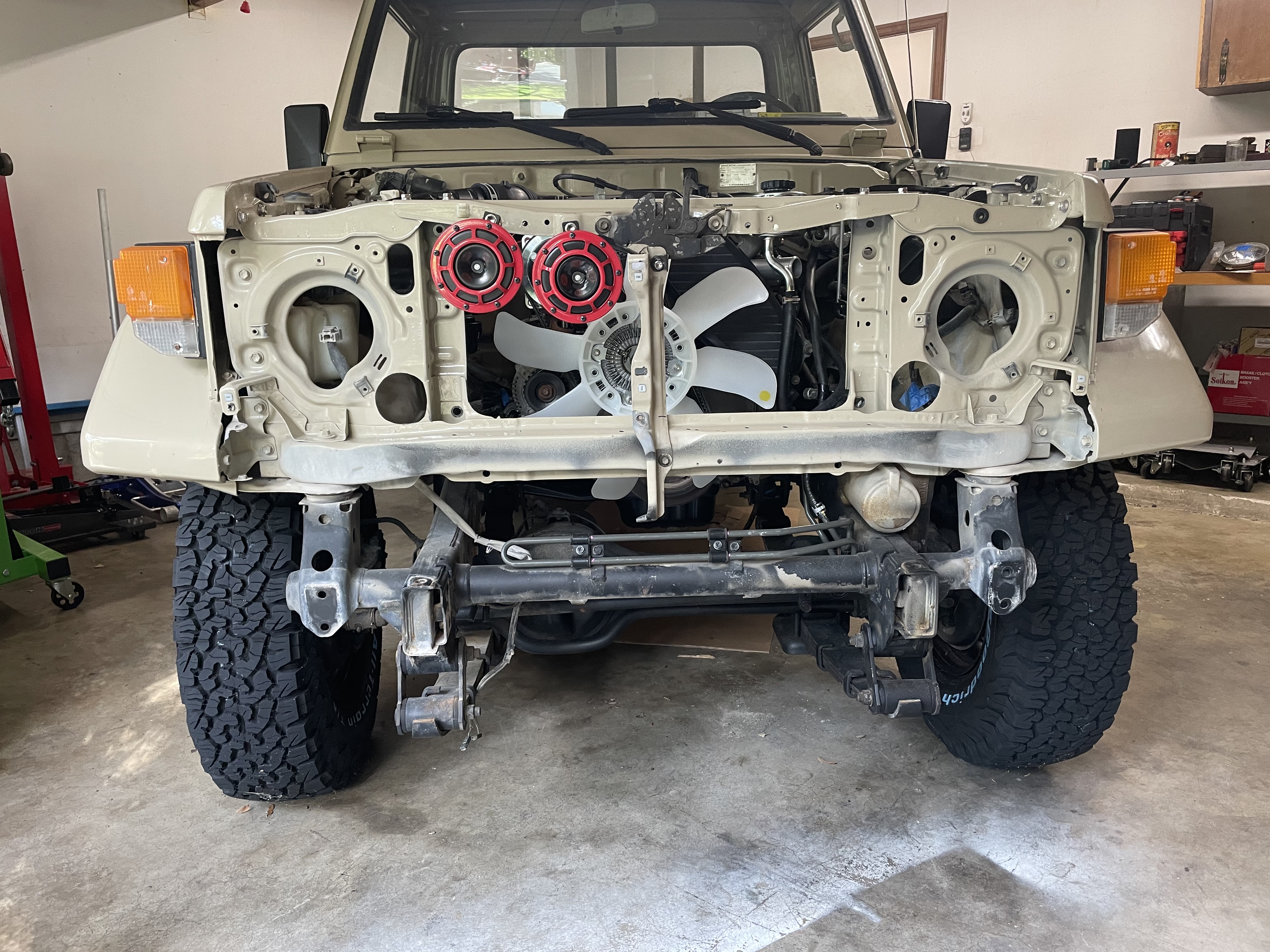

I got the radiator, hoses, fan shroud, and overflow tank installed.

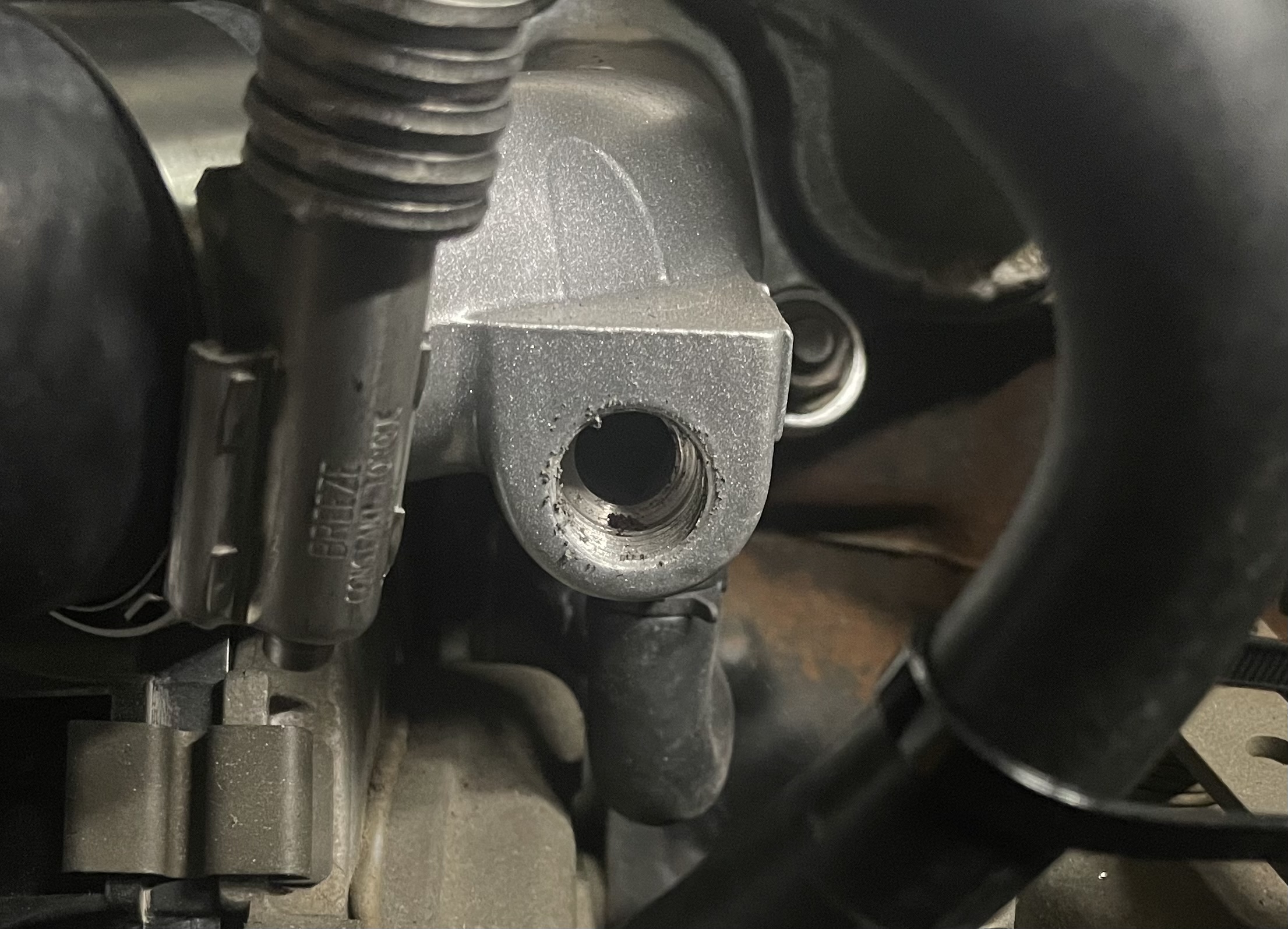

I had planned to install my water temp sensor in this outlet. I had the plug drilled and tapped for 1/8” NPT. Unfortunately, they didn’t run the threads deep enough and the sensor won’t thread properly.

i think the last tap handle i bought came from Lowe's and it's pretty nice. I usually use a crescent wrench anyway lol. How much deeper does it need to be tapped?
Because it’s tapered, probably another 3/8”.
