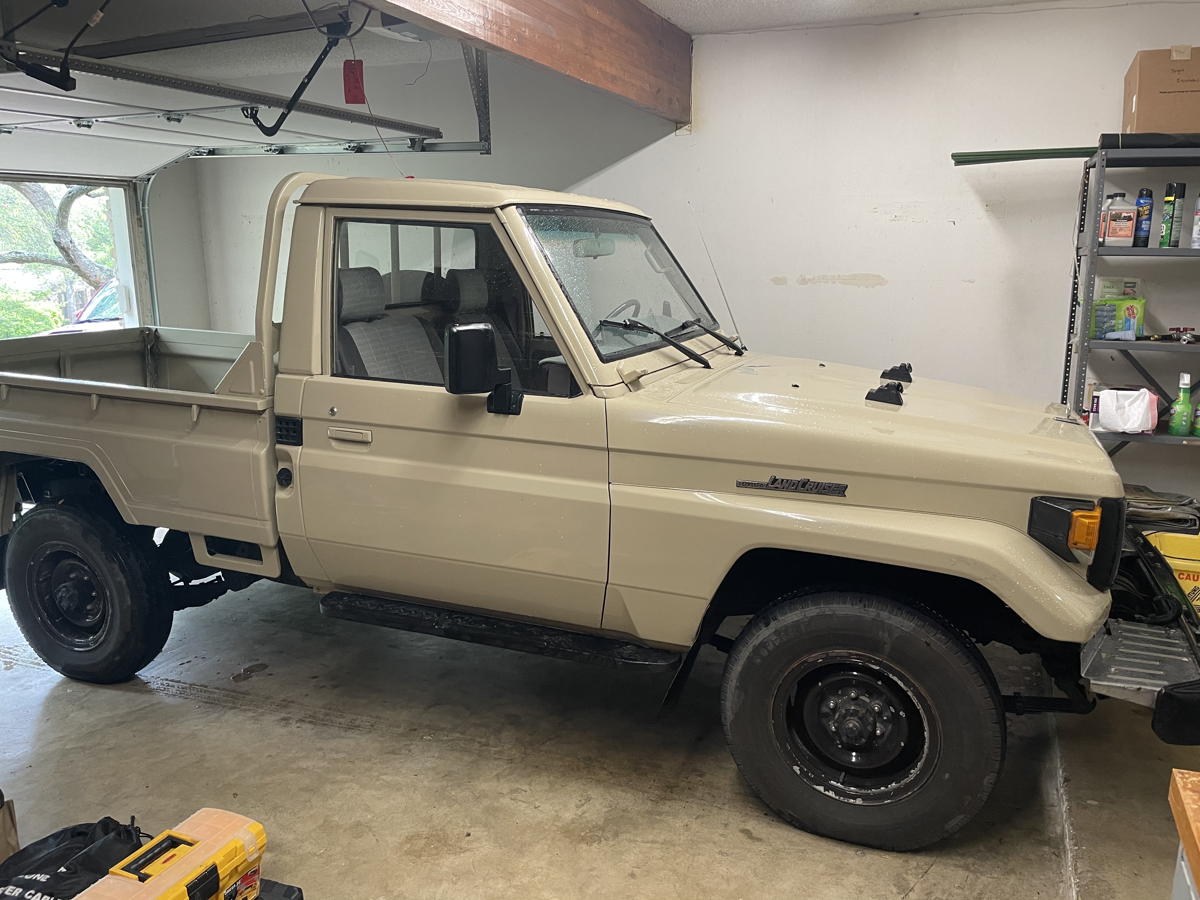

This is my 1996 HZJ75 Land Cruiser Pickup.
How the truck looks now:

Obviously some things were upgraded already? I'm noting the new style side mirrors that I don't believe were offered in 1996?
I'll let Will fill ya guys in, but they can't sell military trucks with insignia or military colors, so this one got a quick spray in standard beige.
It's a great truck, be interesting to see what Will does with it.

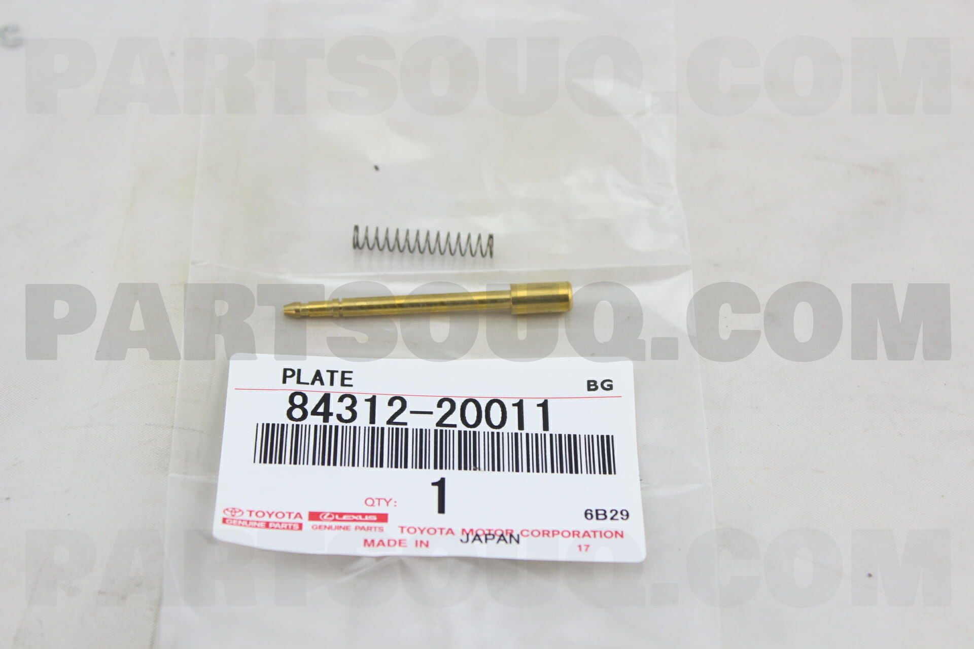

Also, the horn isn't working. Is this the correct pin plate kit for my steering wheel?
