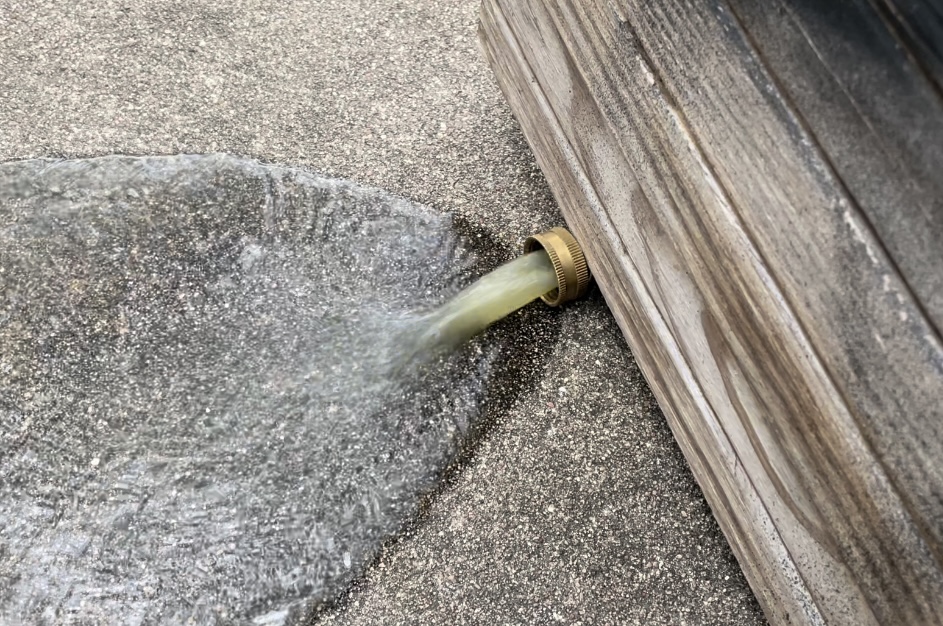

I had put about 50 miles on the truck over various conditions. So today I decided to drain the old distilled water and flush the cooling system.
This is the state of the water during the flush (I recaptured the majority of the old coolant).

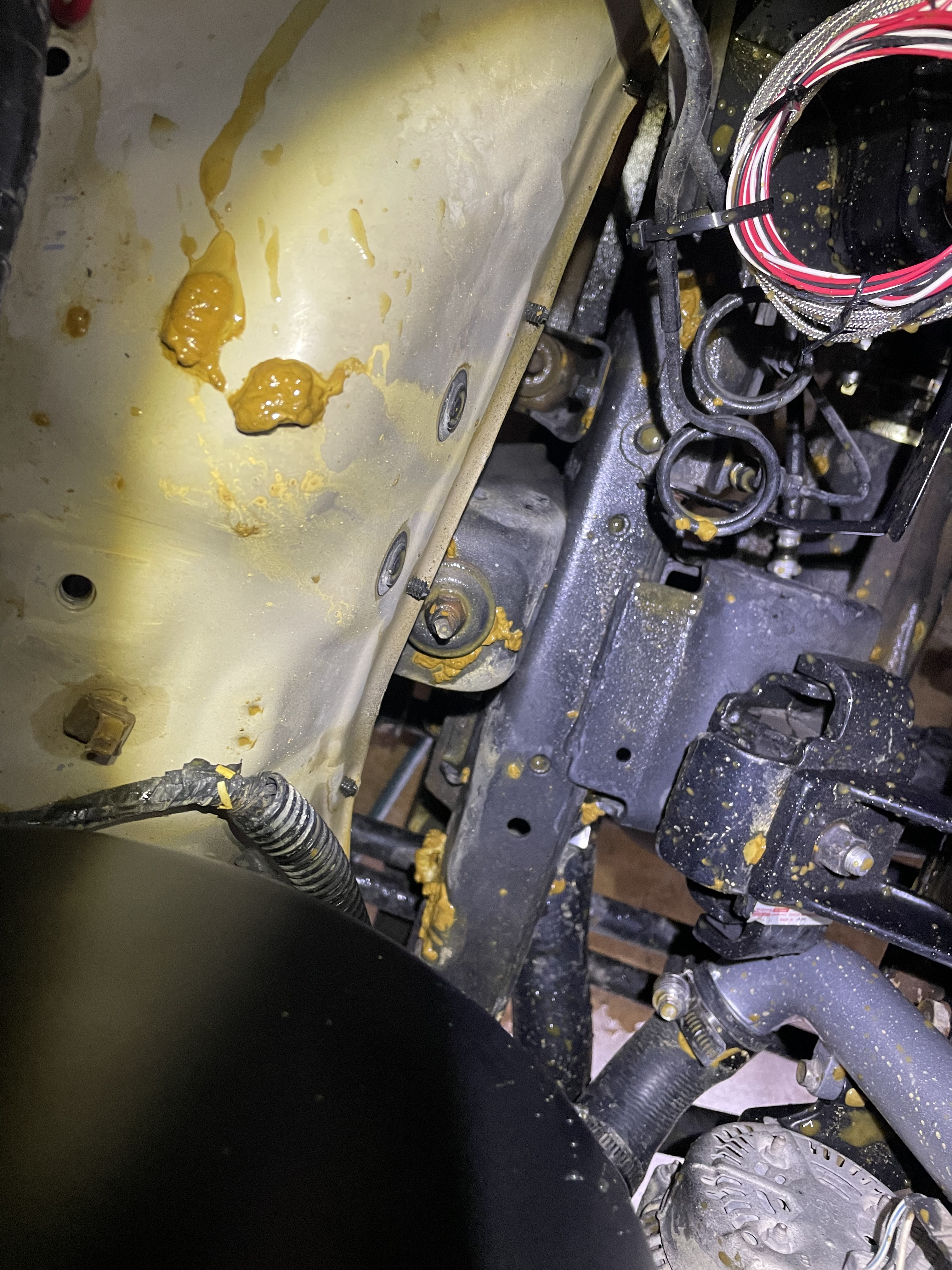

I also forgot to tighten one of the hose clamps on my flushing setup. When I (gently) turned on the water pressure from the garden hose, it blew this crap all over my engine bay. It was about the consistency of bubble gum (tasted like Juicy Fruit). I cleaned it up as best I could. Luckily I didn't get any in my eyes. And that crap is no longer in the cooling system.

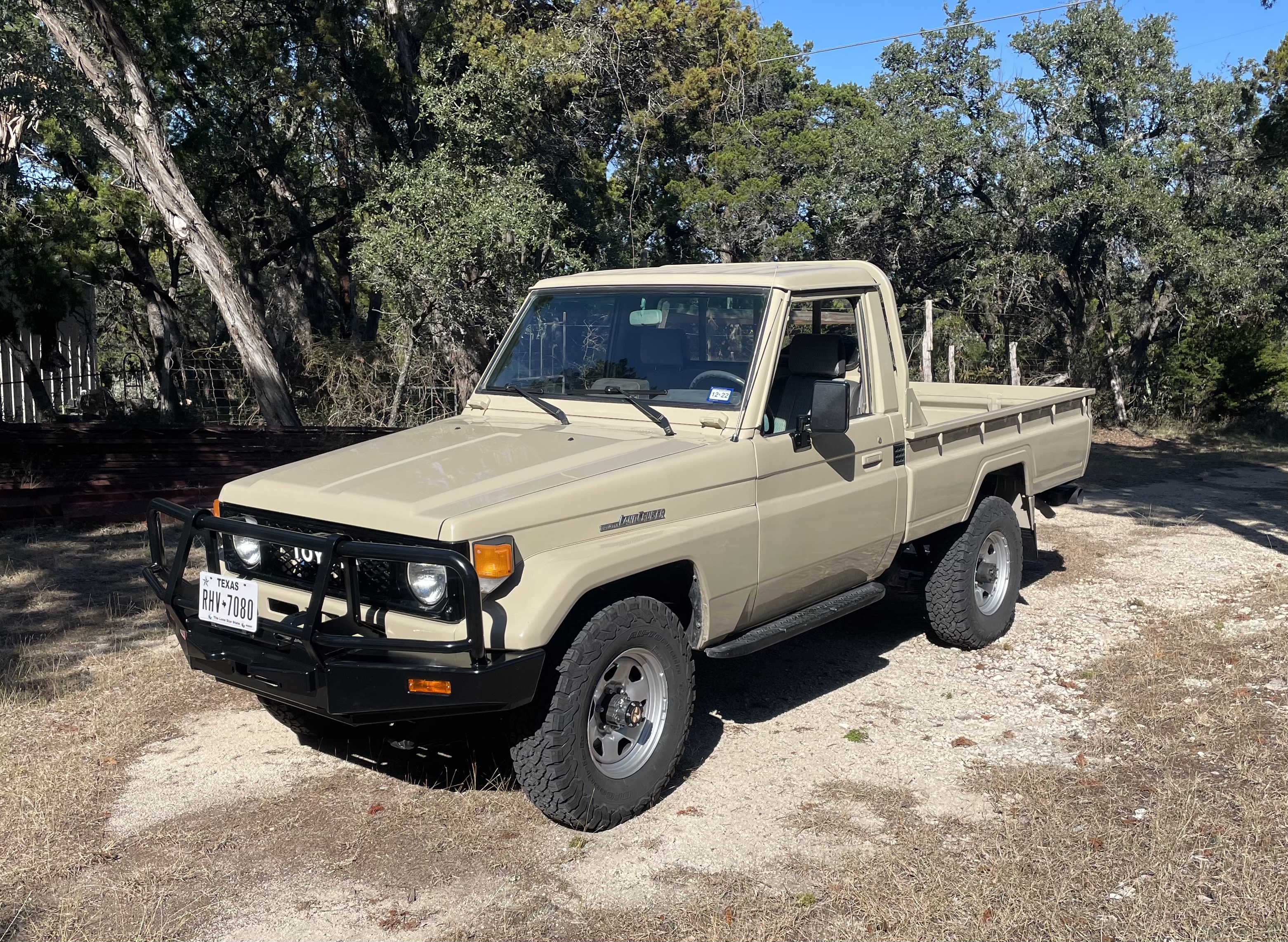

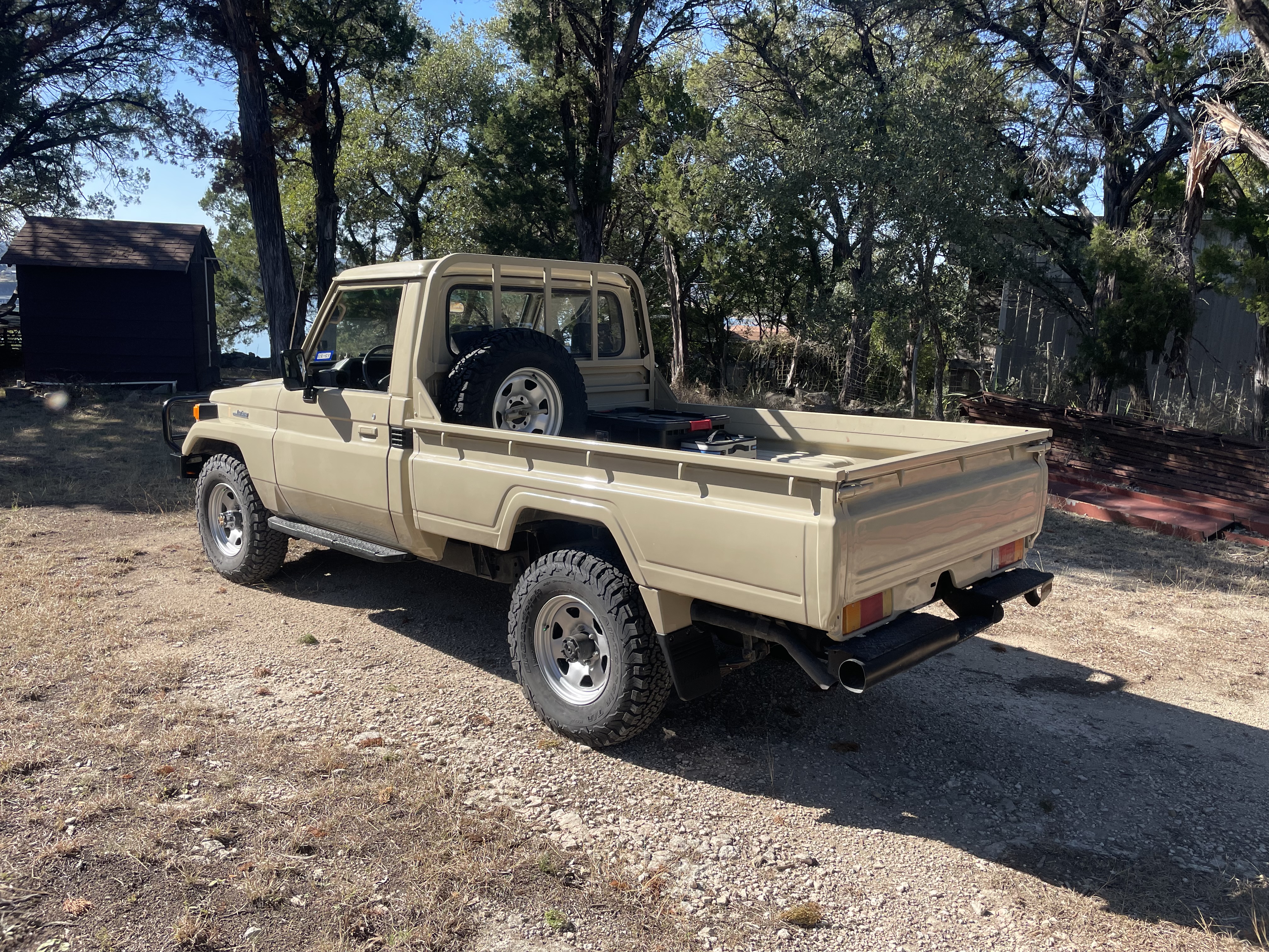

It is spectacularly beautiful in Central Texas right now. I was going to wait until this weekend, but today was too pretty. Took the Cruiser out for a spin to our lake property. The truck did great and was a pleasure to drive. No issues and lots of attention. I was only able to snap a few pics before I needed to turn around and head back to work.
After spending a little more time in the truck, 3.7 diff gears are high on my priority list. It will only do about 60 mph before it starts screaming.
But for now, time to just enjoy the truck!
