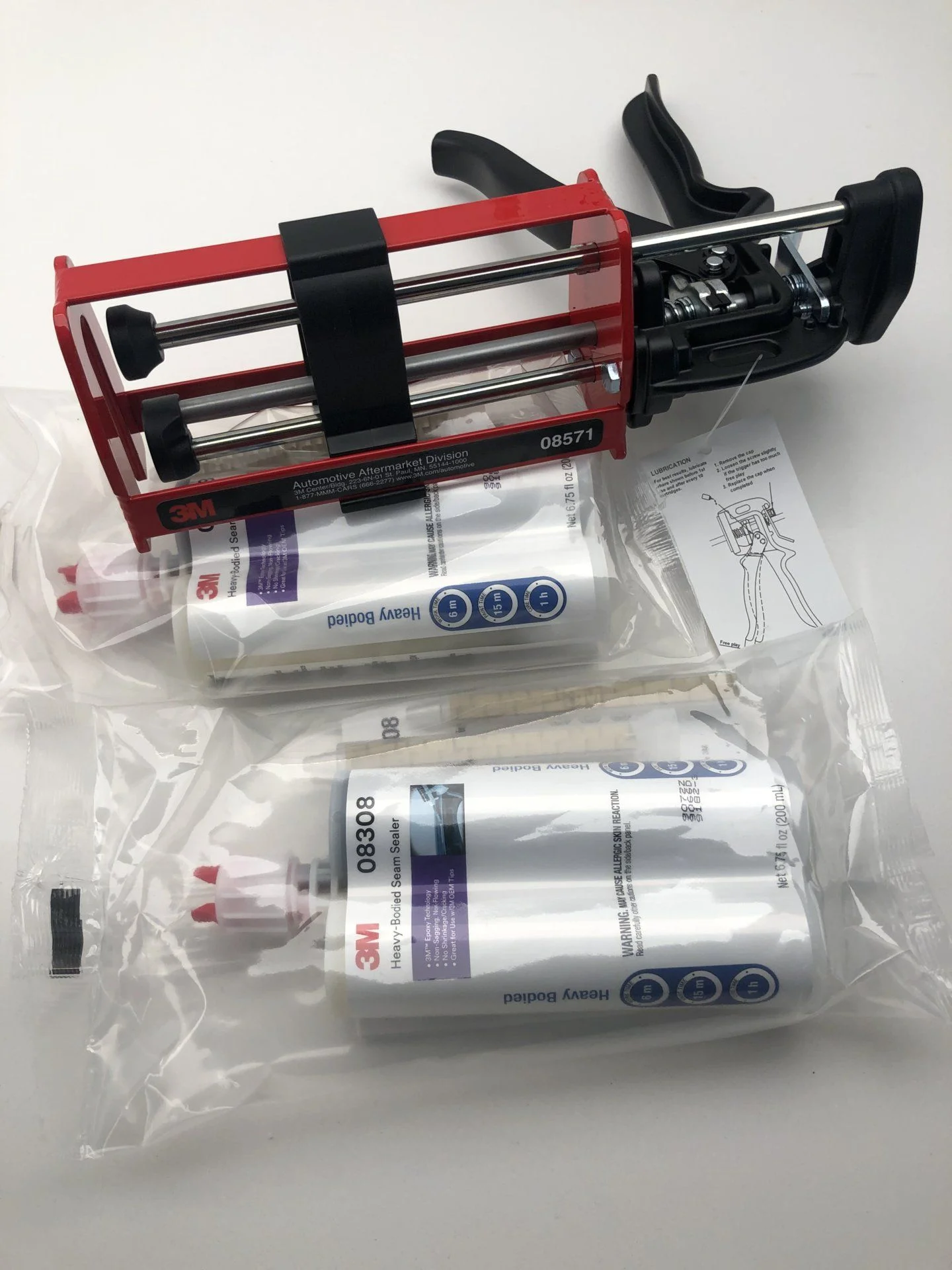

I also don't like 3M seam sealer. It drys out and cracks, too. I'd stick with Sikaflex or an equivalent. I think thats what all the half-tub makers advise. HTH

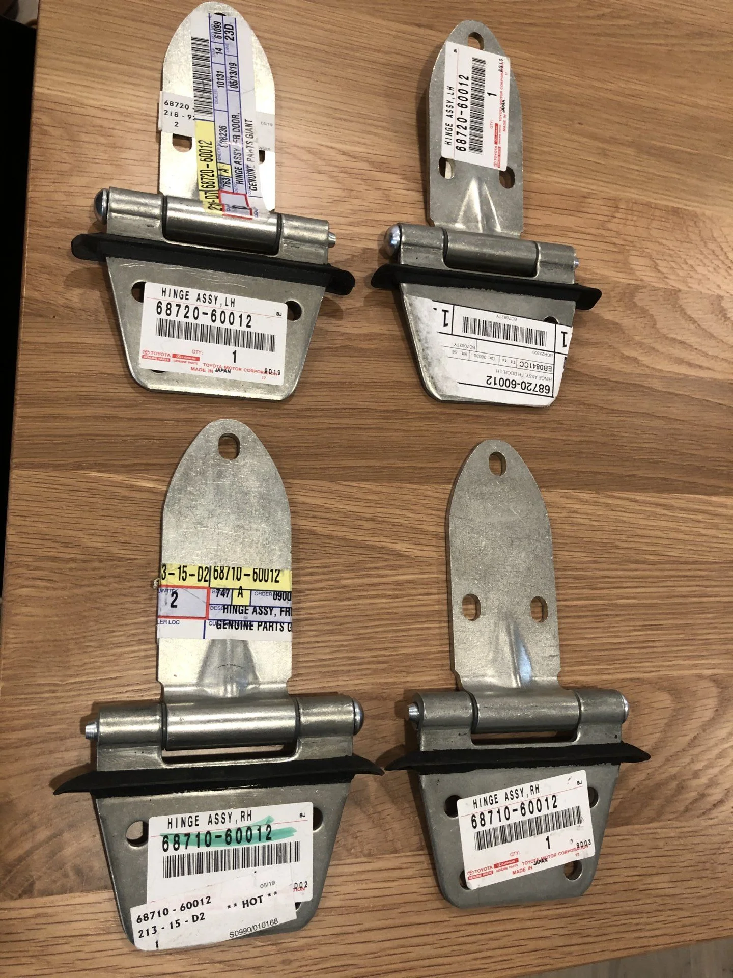

I have a question in regards to the door hinges.
the black “gasket”, if you will, is affixed/glued to the hinge. I am wondering about how they were painted at the factory?
there are also nylon? bushings in there. This all can’t be just hosed over with base/clear, right?
im attempting to do as meticulous as within my power and funding restoration.
thanks.
Paint away!
Afaik they were all painted over...

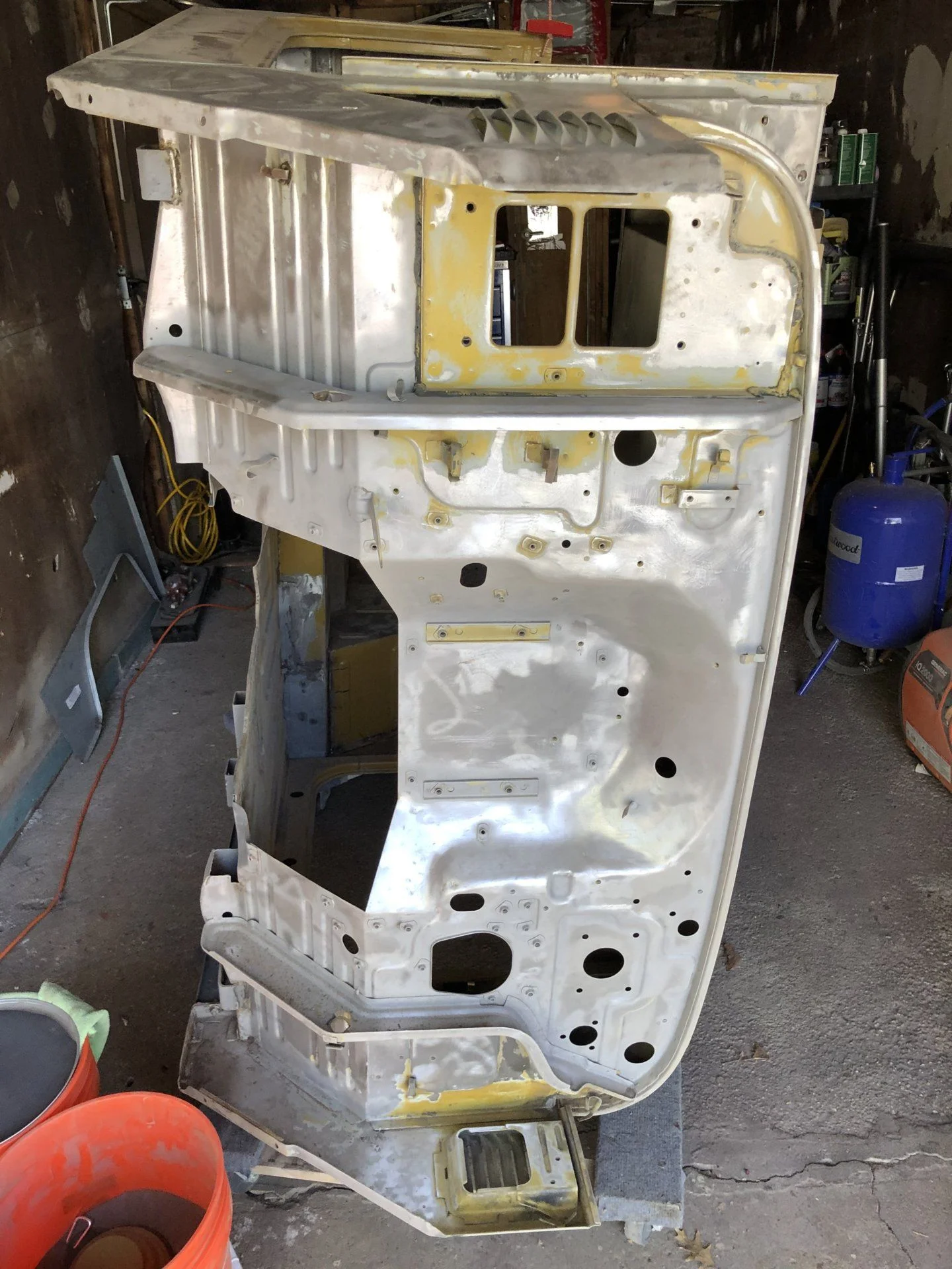

meh...thanks. The removing of the paint has revealed quite a bit of rust as you can see; along with garbled up welds, cut-in steel of various thicknesses and all manner of body repairs from who knows when.
Once down to metal on the tub, I'll get it back up right and begin (again) correcting all of these issues best I can.
I will add however, that the bed is fairly beat up, but at least "good". So, I am going to clean it up best I can and leave it in.
I would de-sticker them, lightly scuff, prime/paint/clear - nylon bushings and all.
Because you'll be tightening bolts down on them, I would not apply a ton of clear coat - plenty, but not like they are candy-coated. This way, the clear should survive the bolt tightening without wrinkling or cracking.
I'll use my "1978th" message in ih8mud to say "thank you!"
The main reason I ask is I would rather the black rubber gasket be left raw, rather than painted over. I think it looks cleaner, but if Toyota from the factory just hosed the whole thing, that is what I'll do. I mean - the option is to meticulously tape-off the rubber portion, but it would never be perfect.

Speaking of products, after extensive research, phone calls and the like, this is what was recommended as a seam sealer. Have any of you used this on a cruiser?
I think this is what our mutual friend used on the Pig! I will have to go back through my thread to confirm...
