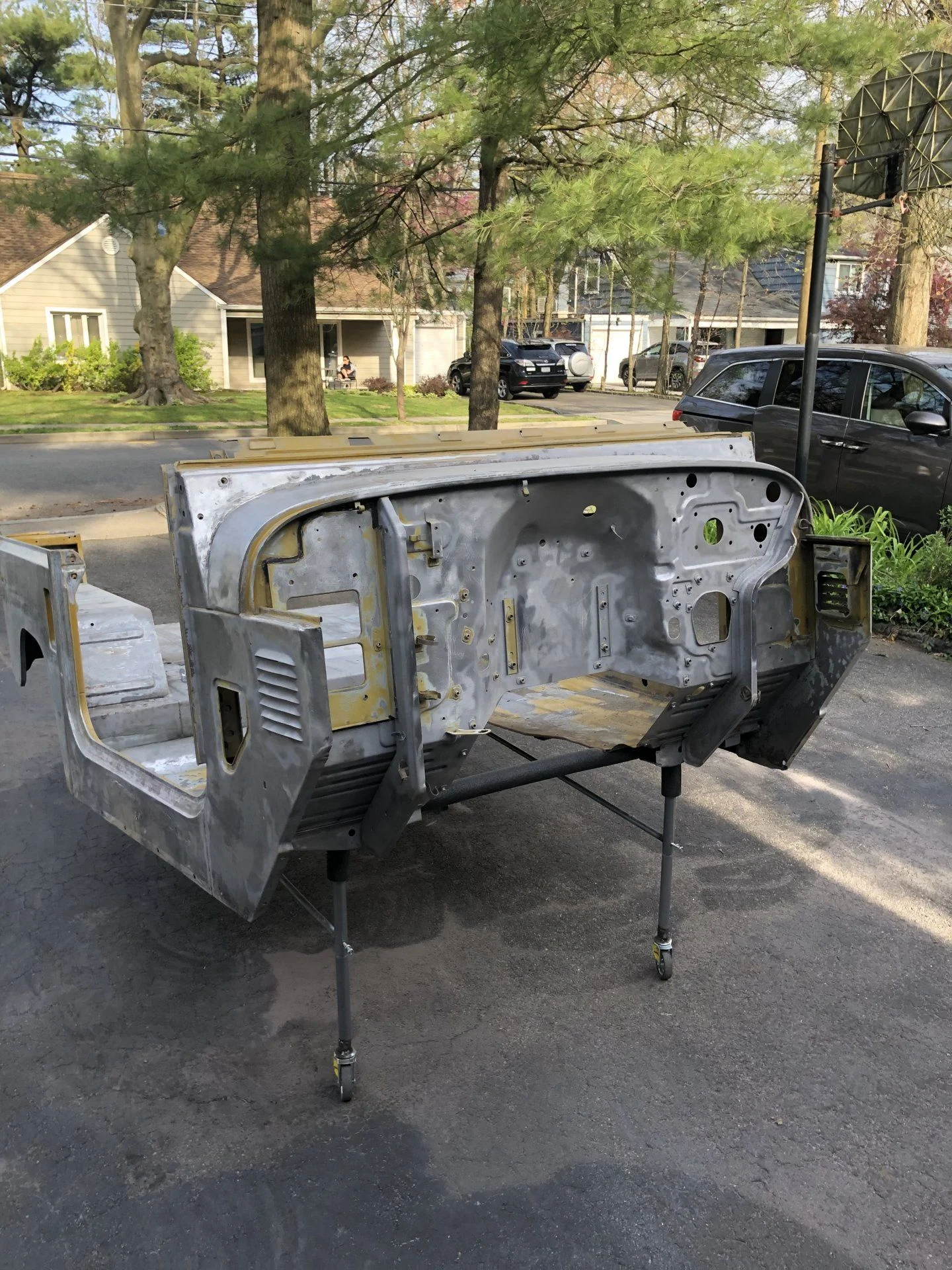

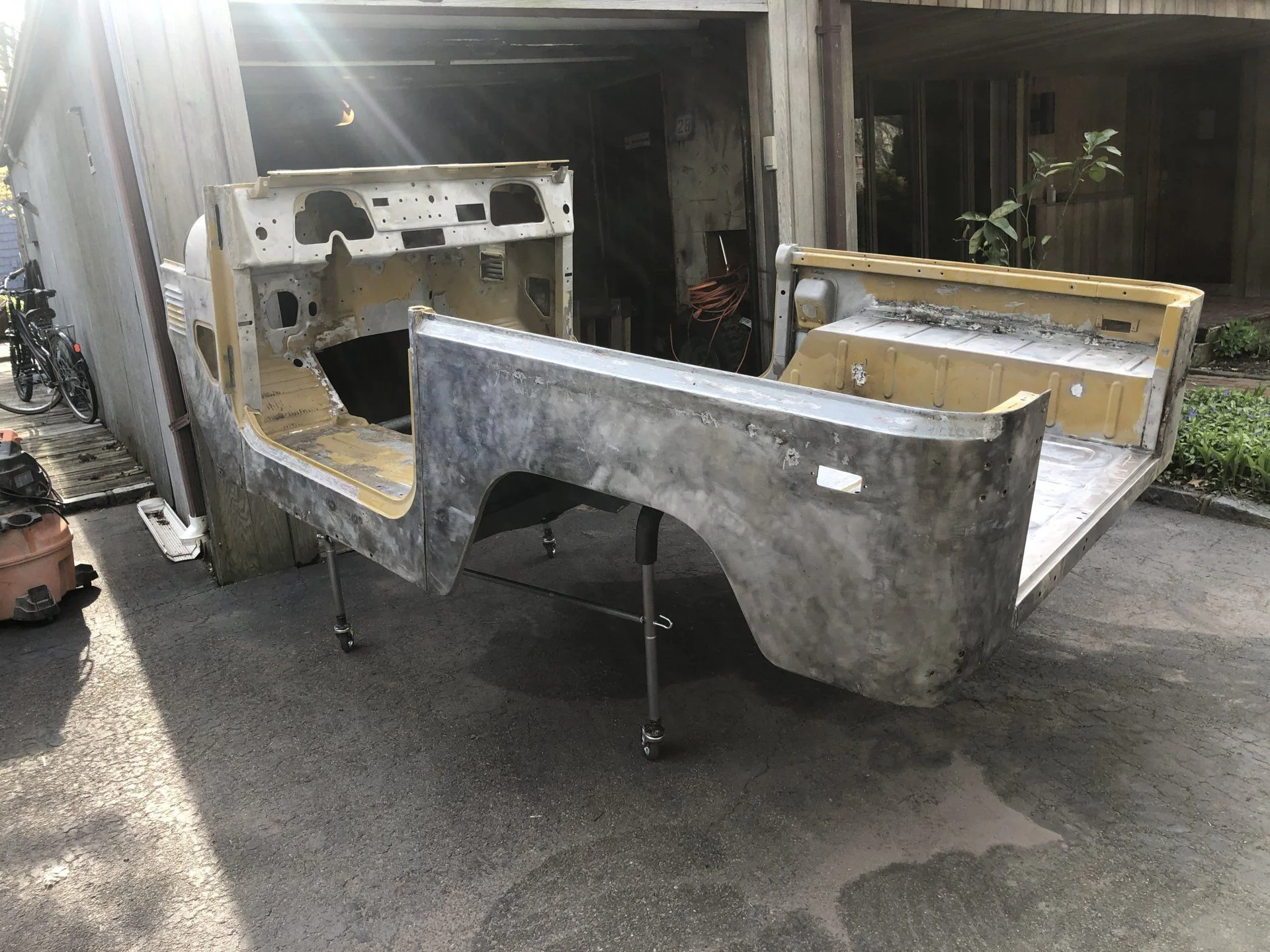

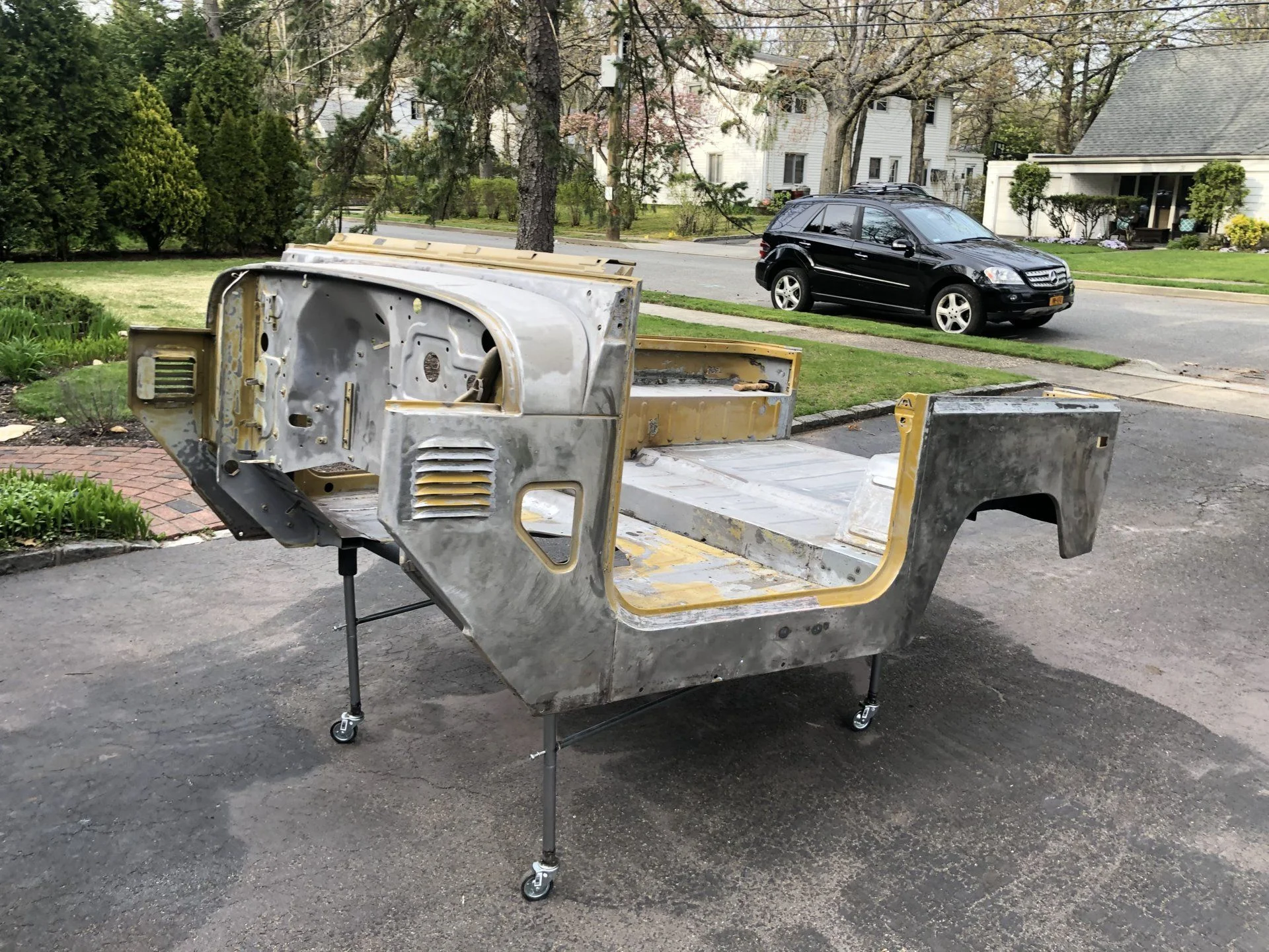

Ive called a few places, no one wants to touch it right now, so I am slowly section by section blasting. It will be correct when I get done with it.
What is sad is the number of previous owner:
  • Broken bolts left in the hole.
  • Tacked in sheet metal and buried in bondo
  • Stripped mounts (for example, roll bar nuts very difficult to remove) that they just drilled out to slip a 3/8" SAE bolt through with another nut on the bottom.
  • JB weld slugged in a hole
  • Fiberglass slugged in a hole
  • Surprising levels of bondo and filler, six layers in some areas.
  • Wiring hacks so numerous I have to rebuild most sections of the harness
  • non-Toyota parts too numerous to list (quality would be another thing)
  • Outright destruction to the body and fragile bits that compromise the safety of the truck.
I have HOURS into just the bare tub alone to repair and correct the structural integrity and return the cruiser back to original. I am truly trying my best to "restore" this cruiser. I hope you guys are not cringing at the weld-work. I am going to ensure its all sound before I apply any primer to begin applying fillers of any sort.
Anyway - during this pandemic, it is therapy for me to right all of these wrongs. If not myself, someone will thank me later!
