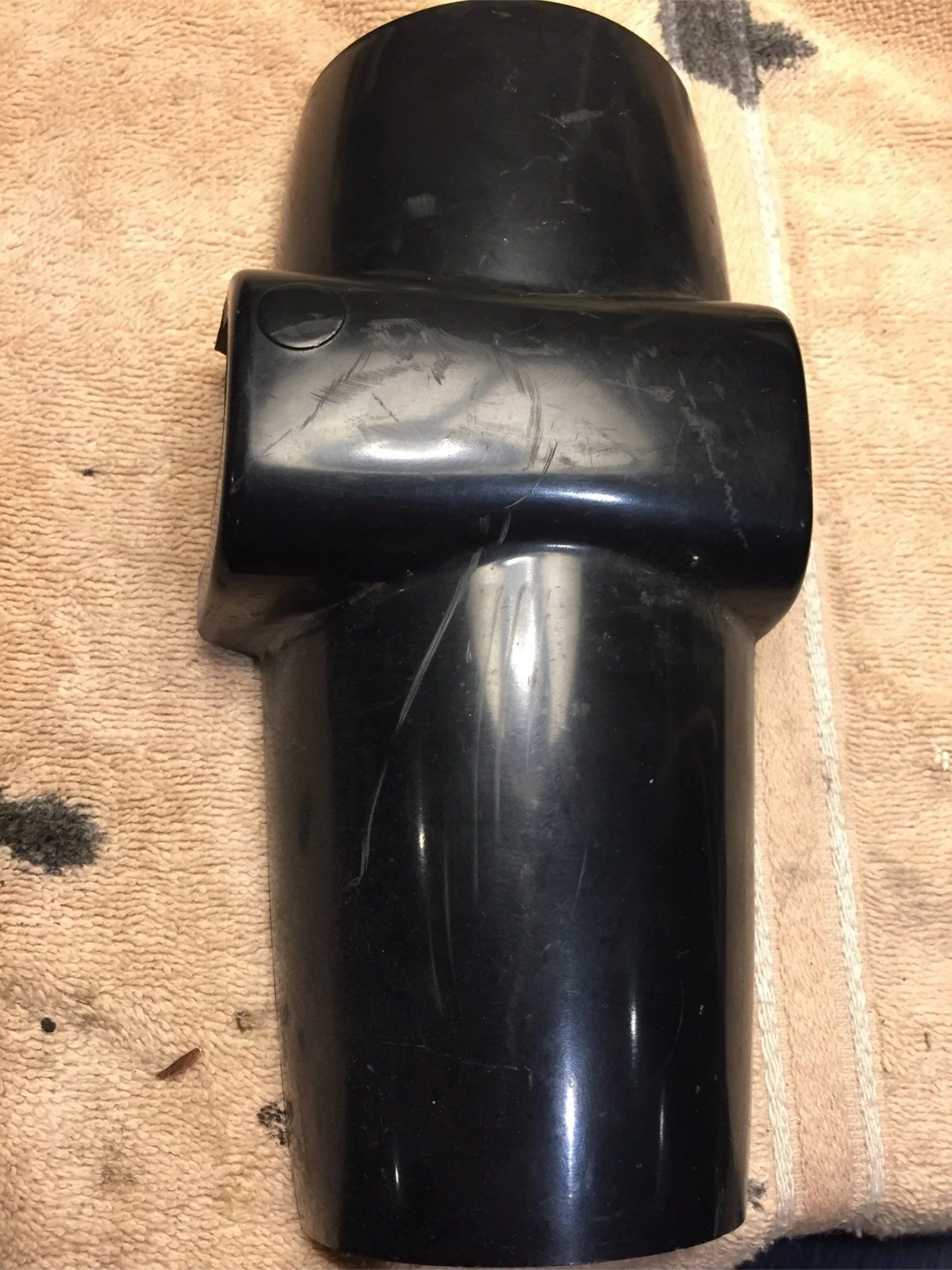

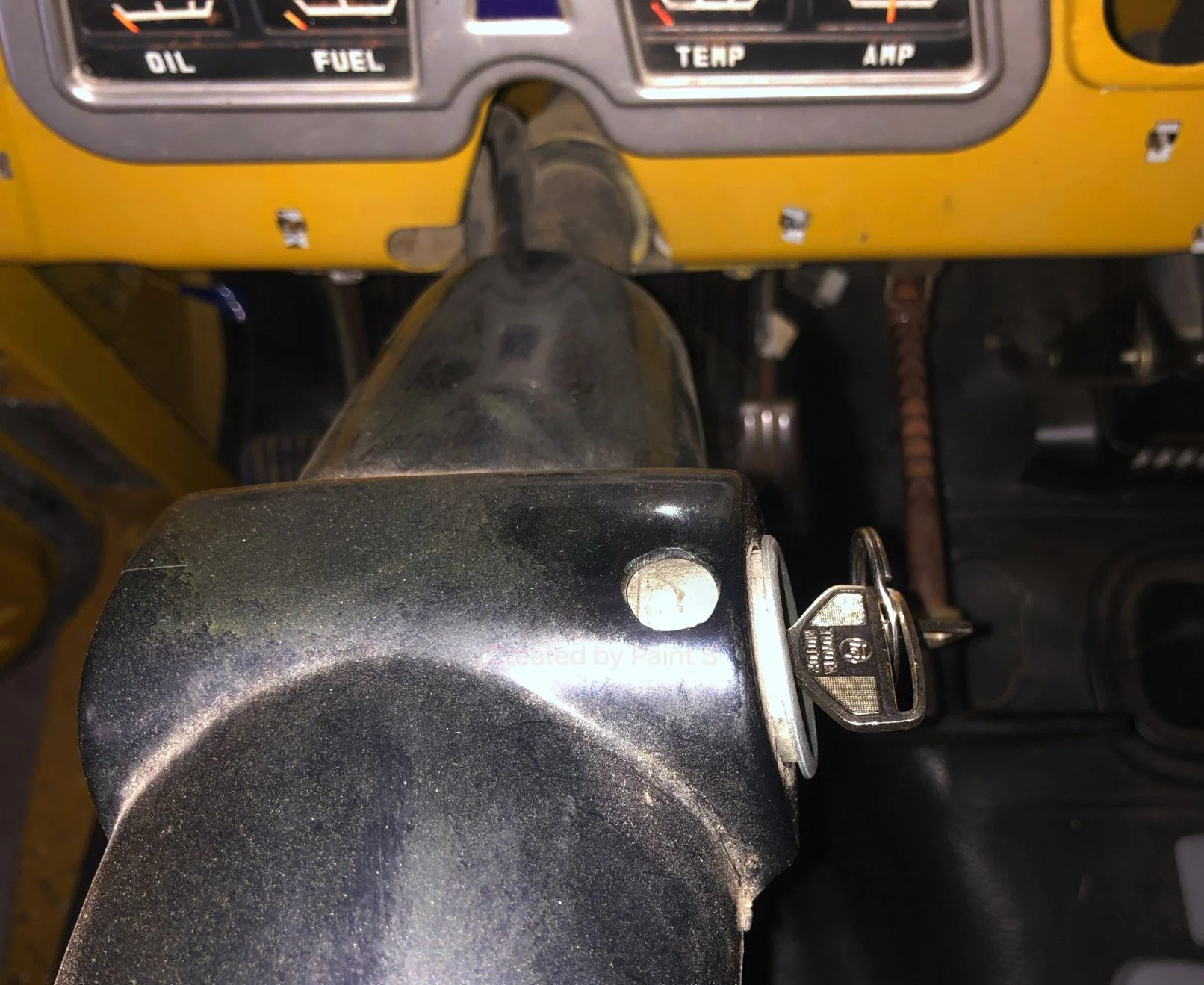

Is this hole (looks factory), stock on a Jan/78 cruiser?
I assume an ignition release. As sloppy as this clam shell feels I can’t help but think it’s wrong?
Thoughts?
My '78 has what appears to be a plug. Just like the photo thebigredrocker posted.

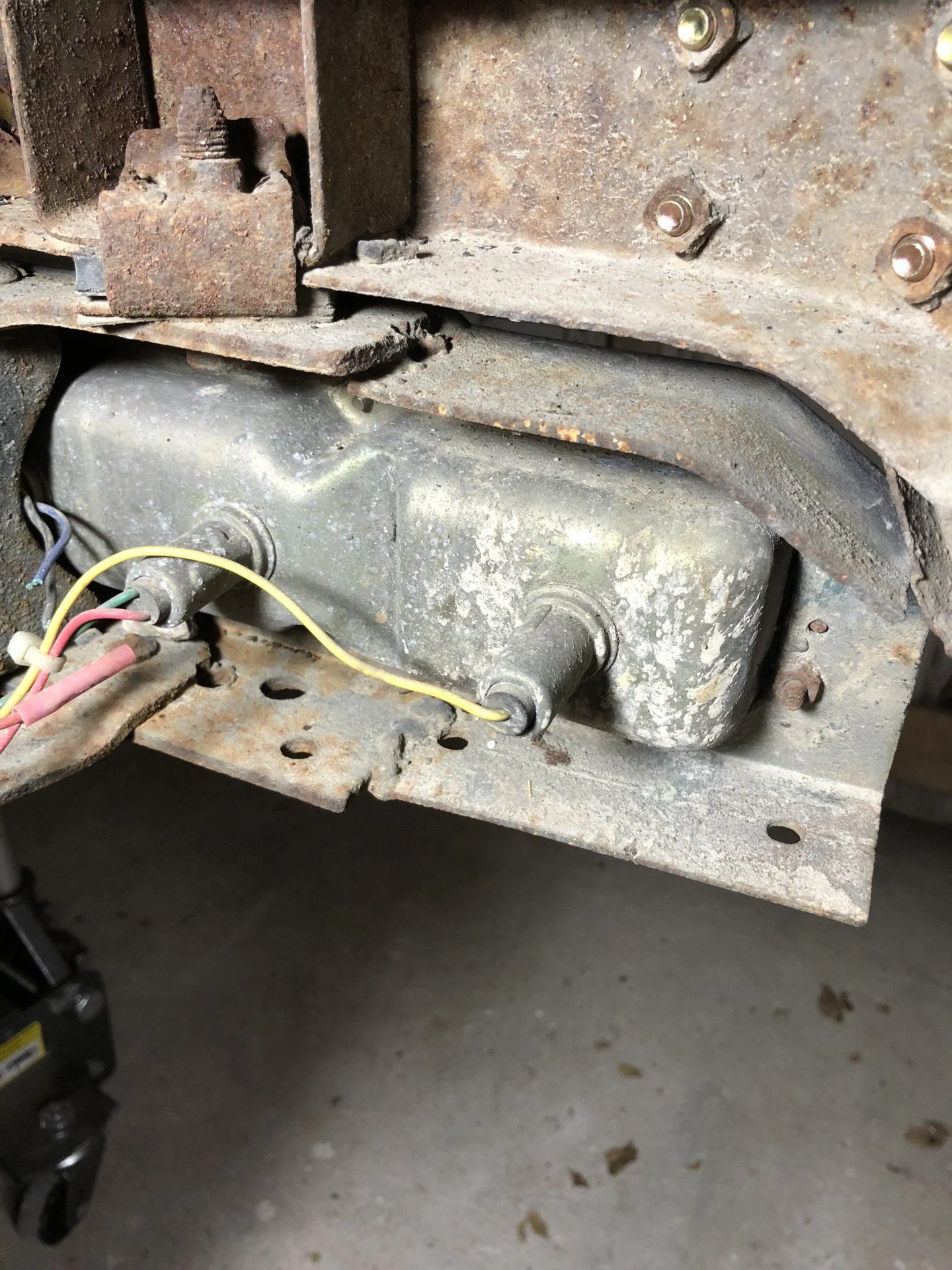

Your e-brake handle return spring is missing. Note the welded firewall bracket.
For the hole behind accel pedal shaft. I believe there’s an emissions switch that resided there. I probably have one in a box if you want/need to hook up the emissions gear. 65swb45 told me it’s a “brake switch for emissions” Here’s a thread to look at.

I have a 10/78 manu date, will check the steering column later

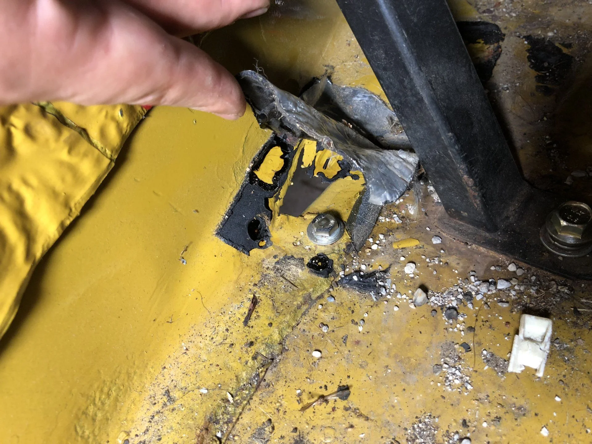

Also...took the floor mat out and saw tar tape covering what appears to be a grinder gone wild or a botched attempt at cutting out rust?
Giant hole? :)
Put a bolt in it... done..

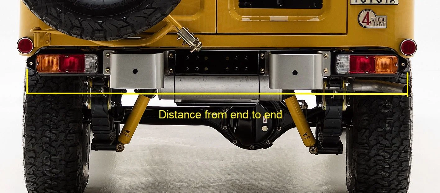

I need help with a measurement. Since the rear cross member was hacked about 2/3'rds of the way through the tail-light hole, I am looking for the end to end measurement of the rear cross member, as exact as it can be.
I'm also working on sourcing the chunks of cross member I am missing. I have a lead - but finding a frame someone has scrapped is not easy.
This is the measurement I need:

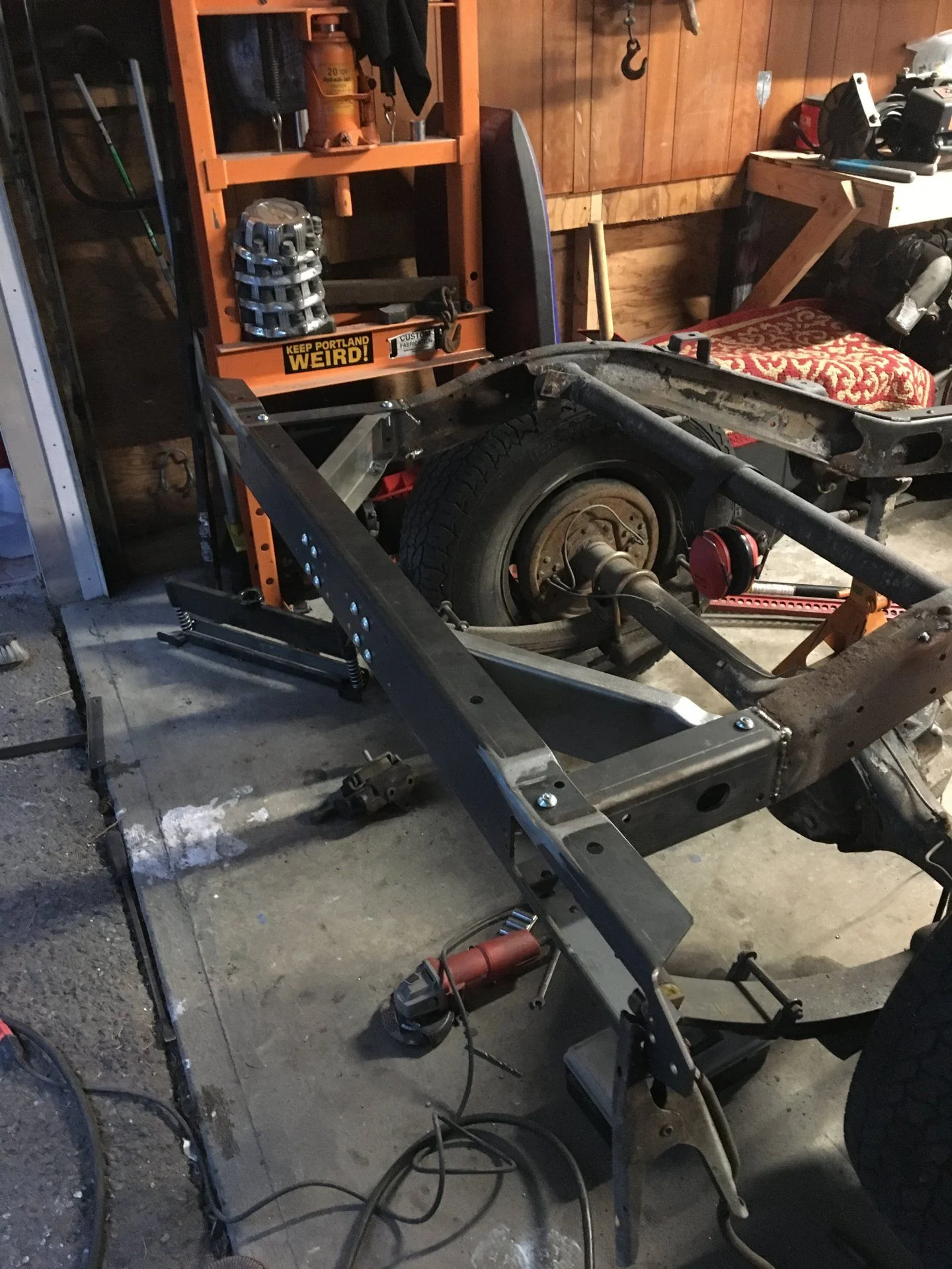

A photo of my '76 build from a series of pics I sent over to @Awl_TEQ who makes very nice replacement pieces. You would be well served to talk to him about getting a new one.

I see you got your measurement. I want to see more of the FJ40 in the photo. Or a link
They are all factory riveted together though....not quite sure how to restore the cross member and keep oem rivets.
And a huge thank you for the measurements!
