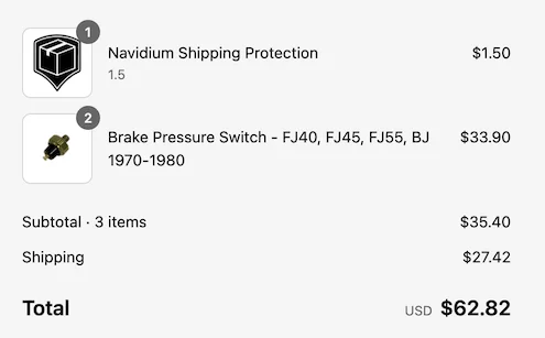

Hey everyone, i have replaced the break pressure sensors two times on my 78 fj40. I keep buying them from Cruiser Corps. Has anyone else had this same issue?
