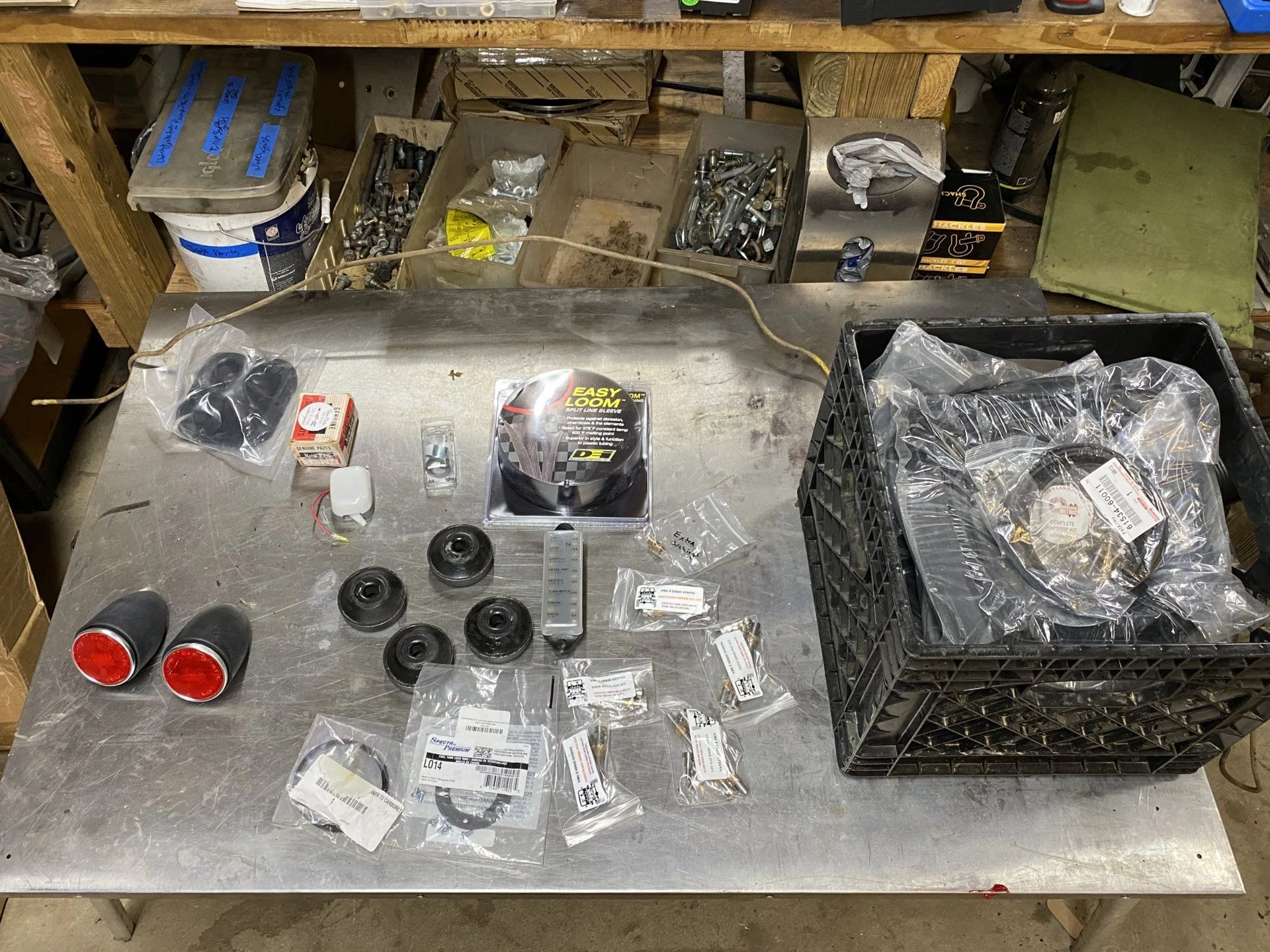

Some more awesome parts arrived today as well. Looking forward to the process now that the stupid knuckle job is done.

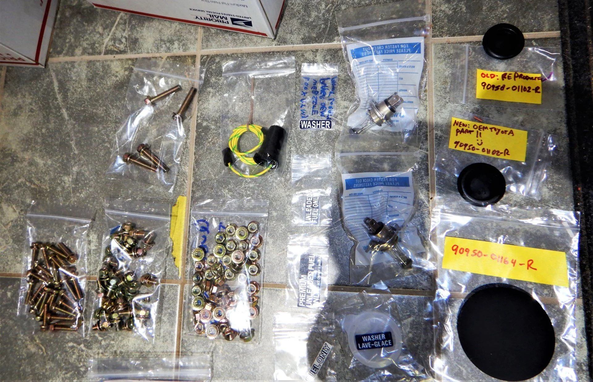

- your complete online parts store order was scanned at local post office earlier today , on it's way to Ya ..........:)
- i also included a small array of Professional Samples & my latest
VintageTeqParts Needed Solutions NLA / Disc. Reproduction Concept Vision kits.

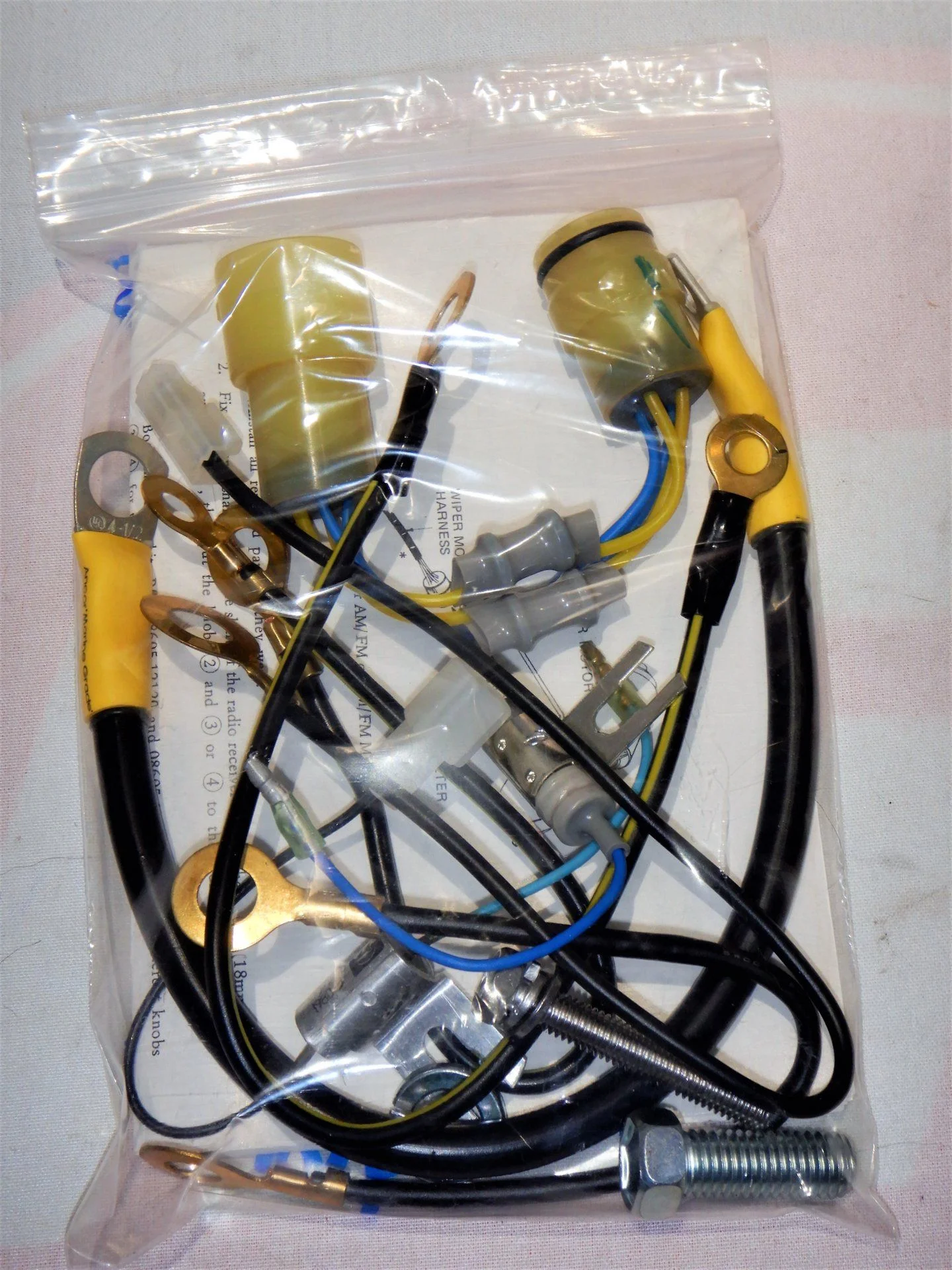

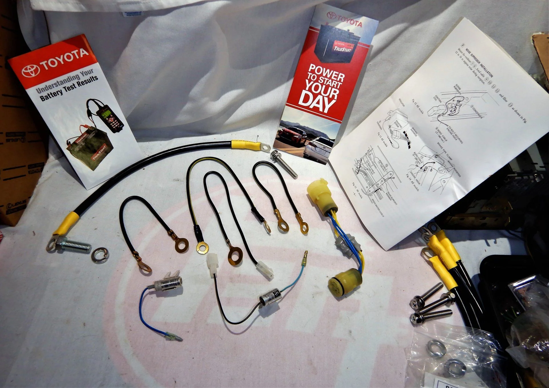

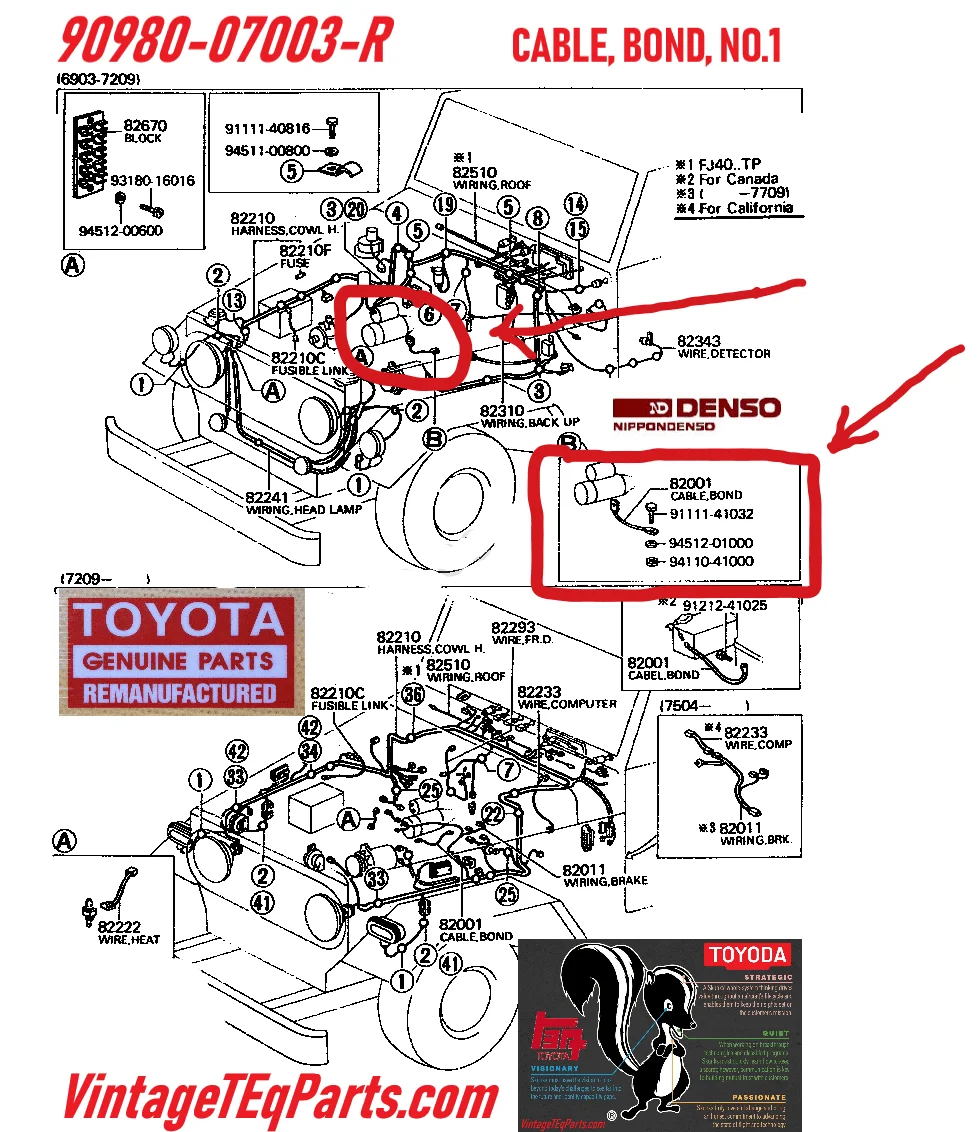

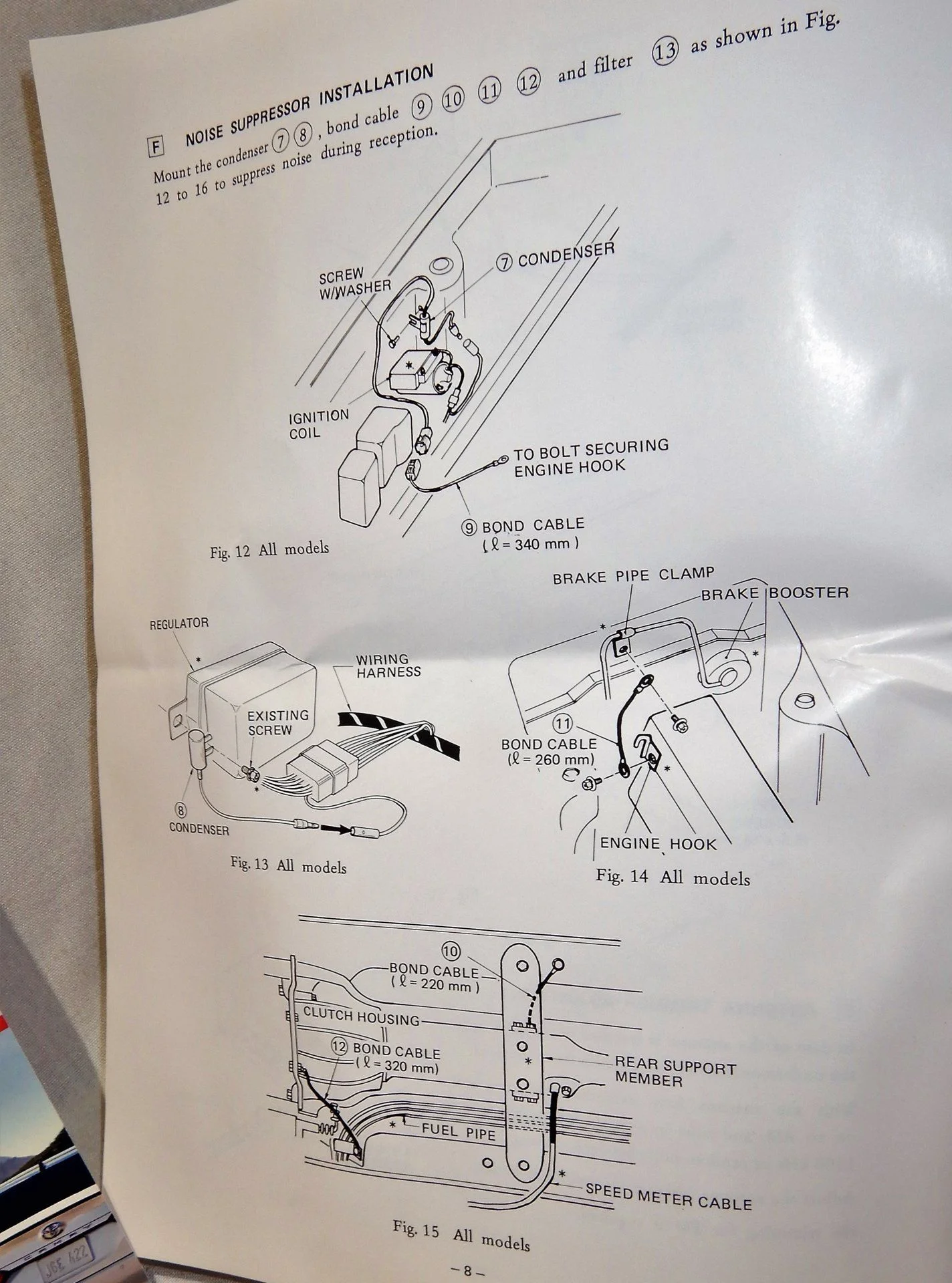

Part # 90980-07003-R CABLE, BOND, NO. 1
- However this one is Unique in the fact the kit contents include also
a Host of Very Special NOS Unicorn parts as well , in the form of a 5pc

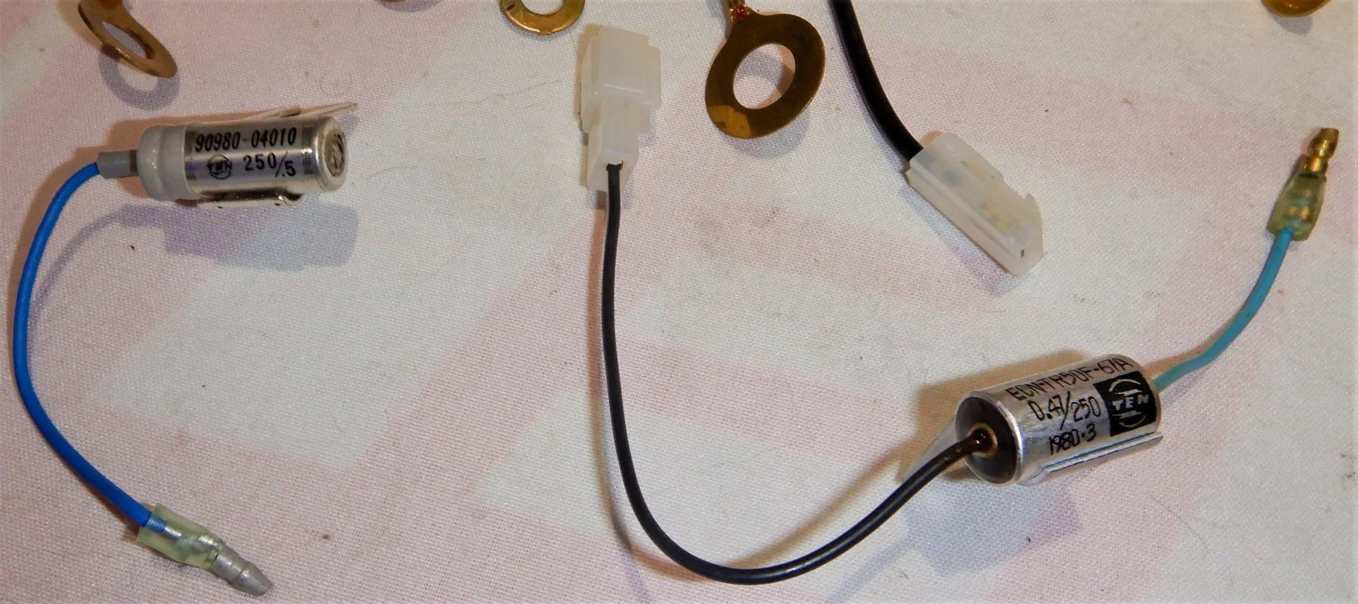

OEM Body and Chassis Ground strap kit . a voltage regulator condenser , and a fender mounted igniter condenser also , all of witch should be period correct for your year span range trucks you have going on .....................
- also , some of wide array of Period correct Body decals i offer too , and some
sample kits of the in-stock Bulk rate Yellow Zinc mounting Hardware i keep too ..
- note : where i do offer a indeed always am adding to my diverse line up of
Reproduction Land Cruiser vehical Decals , All the ones i sent samples of are
all NON or NON-USA ones i have sourced abroad etc.....

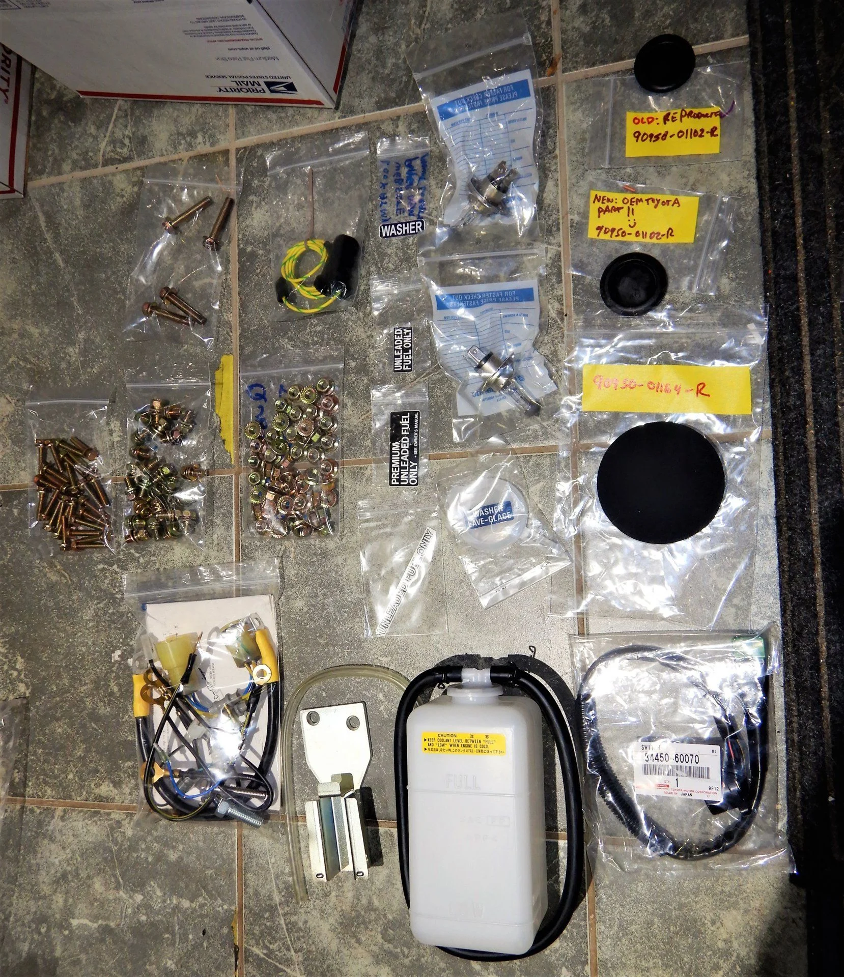

- also have included my Reproduction Fuel tank sending unit gauge access cover hole body plug , and the updated superseded version of the Drain Plug
hole grommet too , i also included the phased out reproduction one because you paid for that one ..................fyi

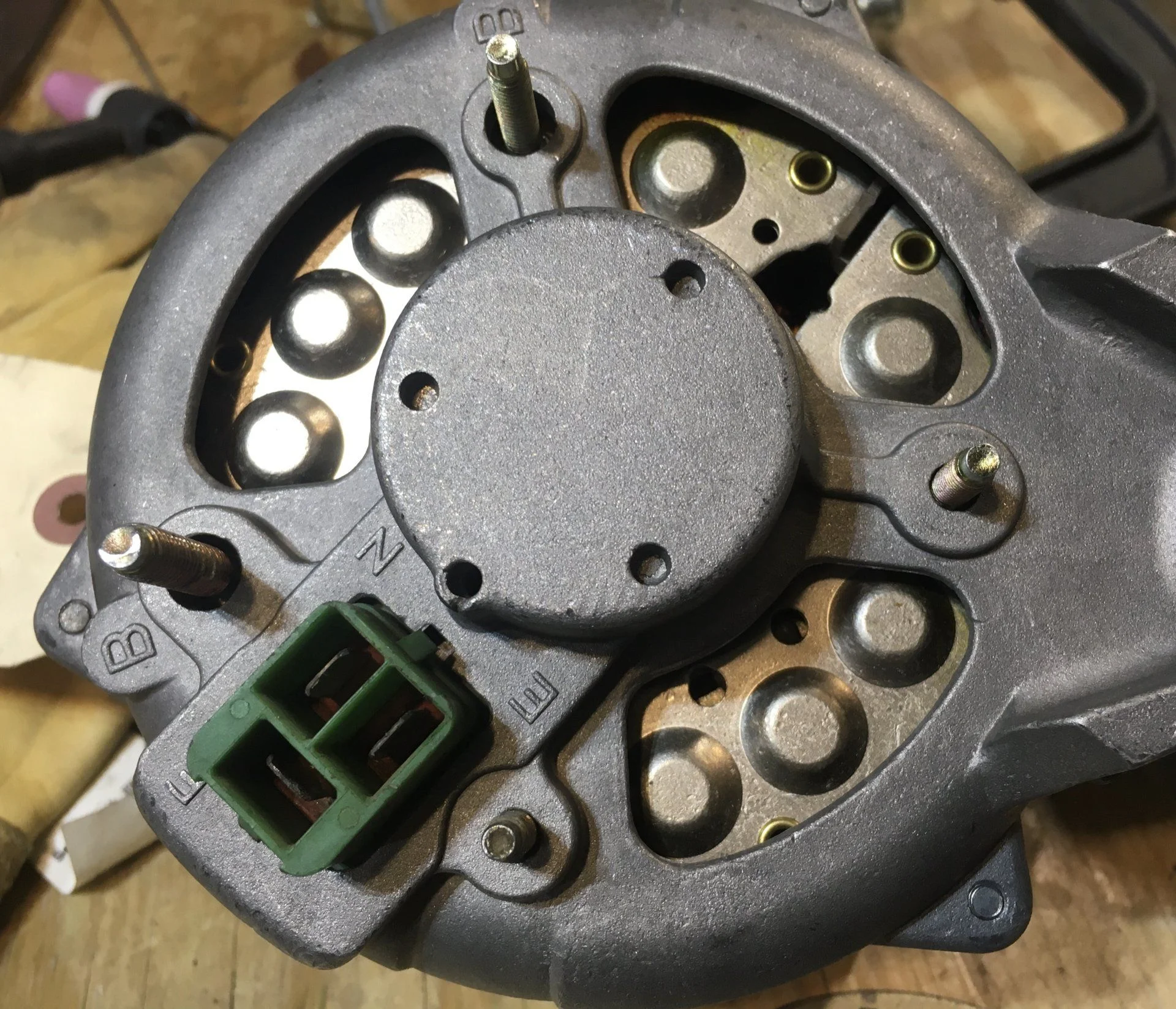

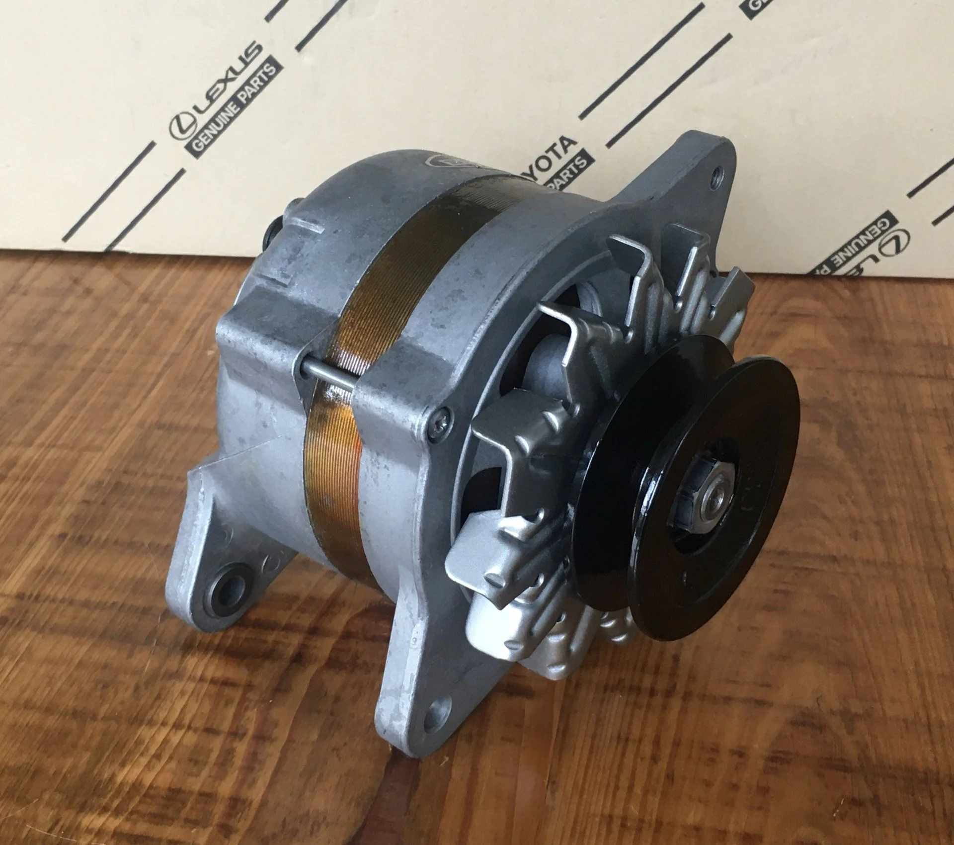

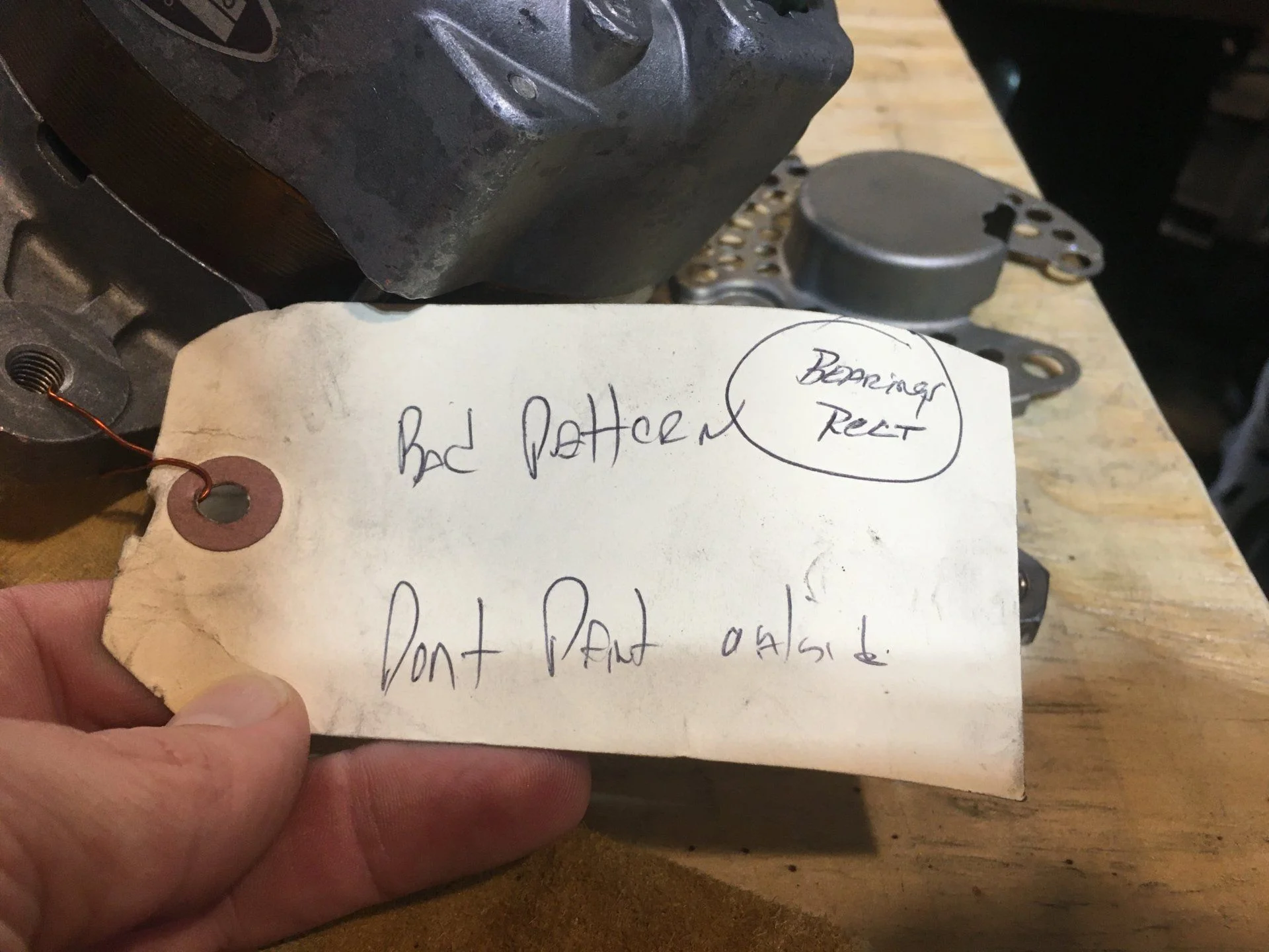

@wngrog sent me the #Mustard78’s alternator for a trip through the Alternator Spa (<<< shameless plug). He says it was working, but needed a mani-pedi to match the level of work going on under the hood.
I use a local rebuilder to rebuild the guts and then intervene at the very last minute to keep them from painting the exterior in hideous colors typical of remanufacturers (lime green, red, black, 80’s fake gold, etc)
This was was reported to be working, but when tested, showed a “bad pattern”. When they took it apart, the diodes were falling out of the rectifier.

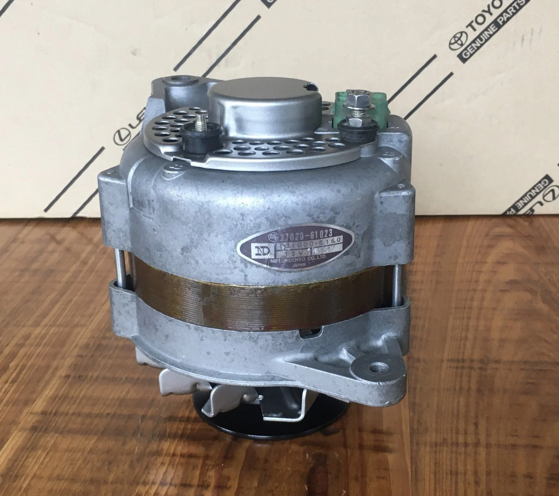

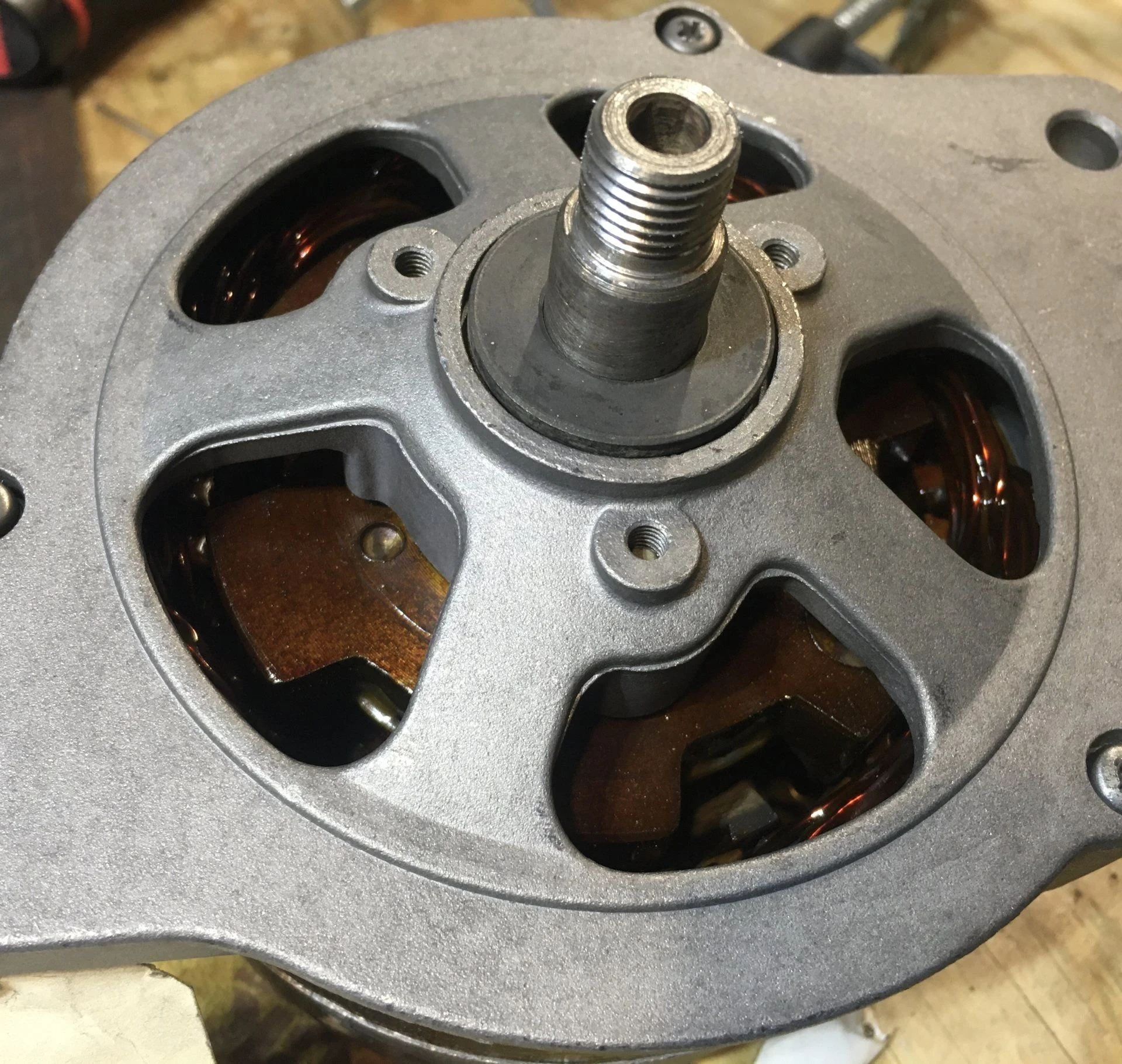

This is usually the death sentence for the older units, but they found a NOS rectifier that was a close enough fit to gunsmith into place (new metal plates behind the case)...

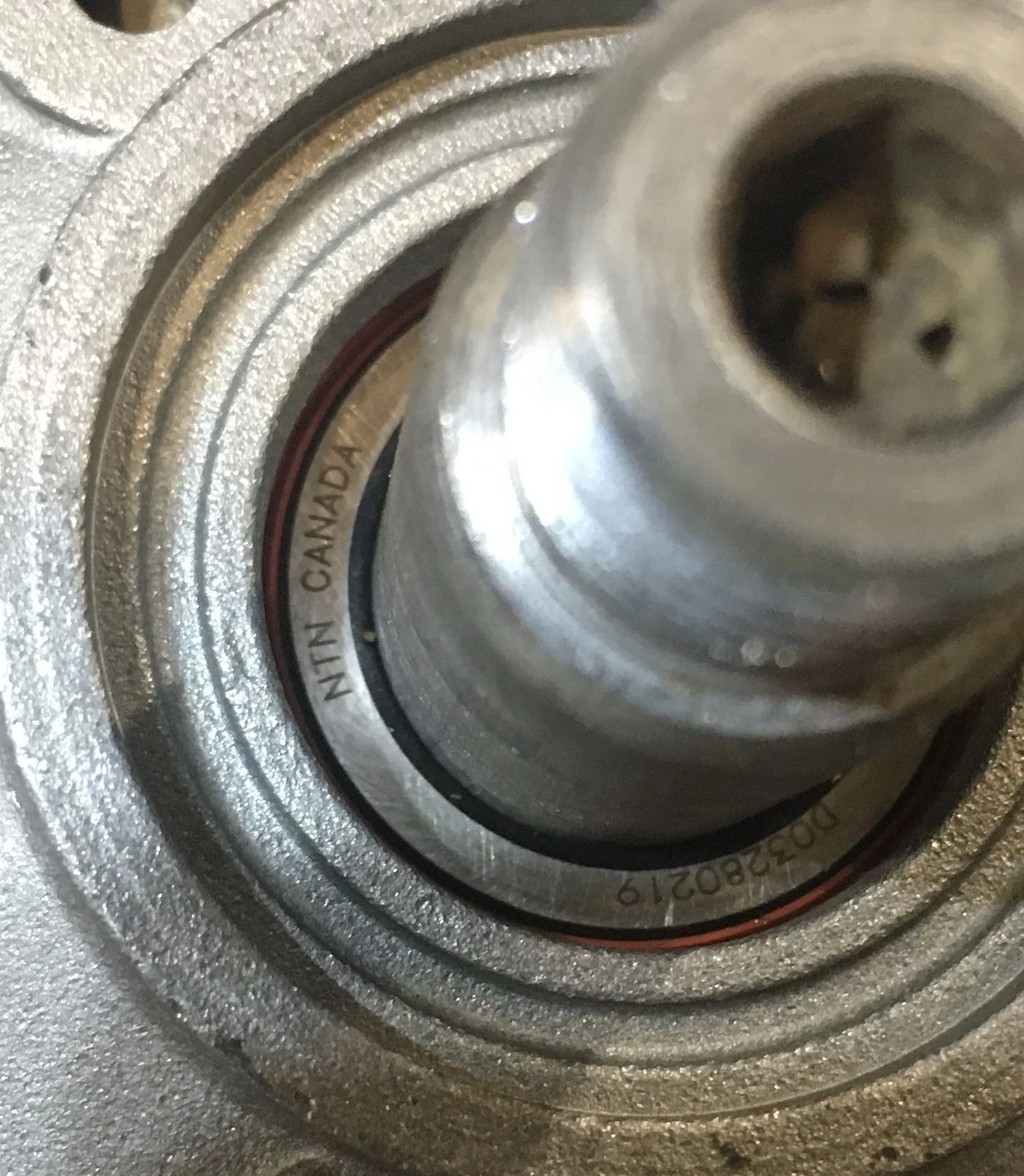

The standard spa treatment for working alternators includes new brushes & bearings. We don't use Chinese bearings either, in this case we used Canadians, eh.
Once they are done with their work, I bring it back to the MM World Headquarters for the application of our proprietary blend of alternator nail polishes that we feel looks classy and period correct.
The end result is similar to the vehicles they will go in - mechanically rebuilt and refreshed, but retain the character not found in something new. The aluminum case will still wear any old battle scars and may have have faint signs of any deep stains or corrosion. As they say, “the art of perfection is imperfection”.
Here is the finished product:
We masked off the original data plate since it was more intact than not:
This should last @jmlockwood a few more decades. Enjoy!

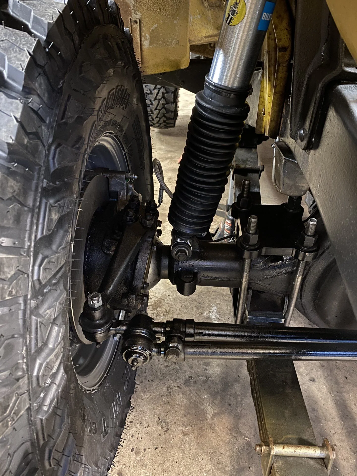

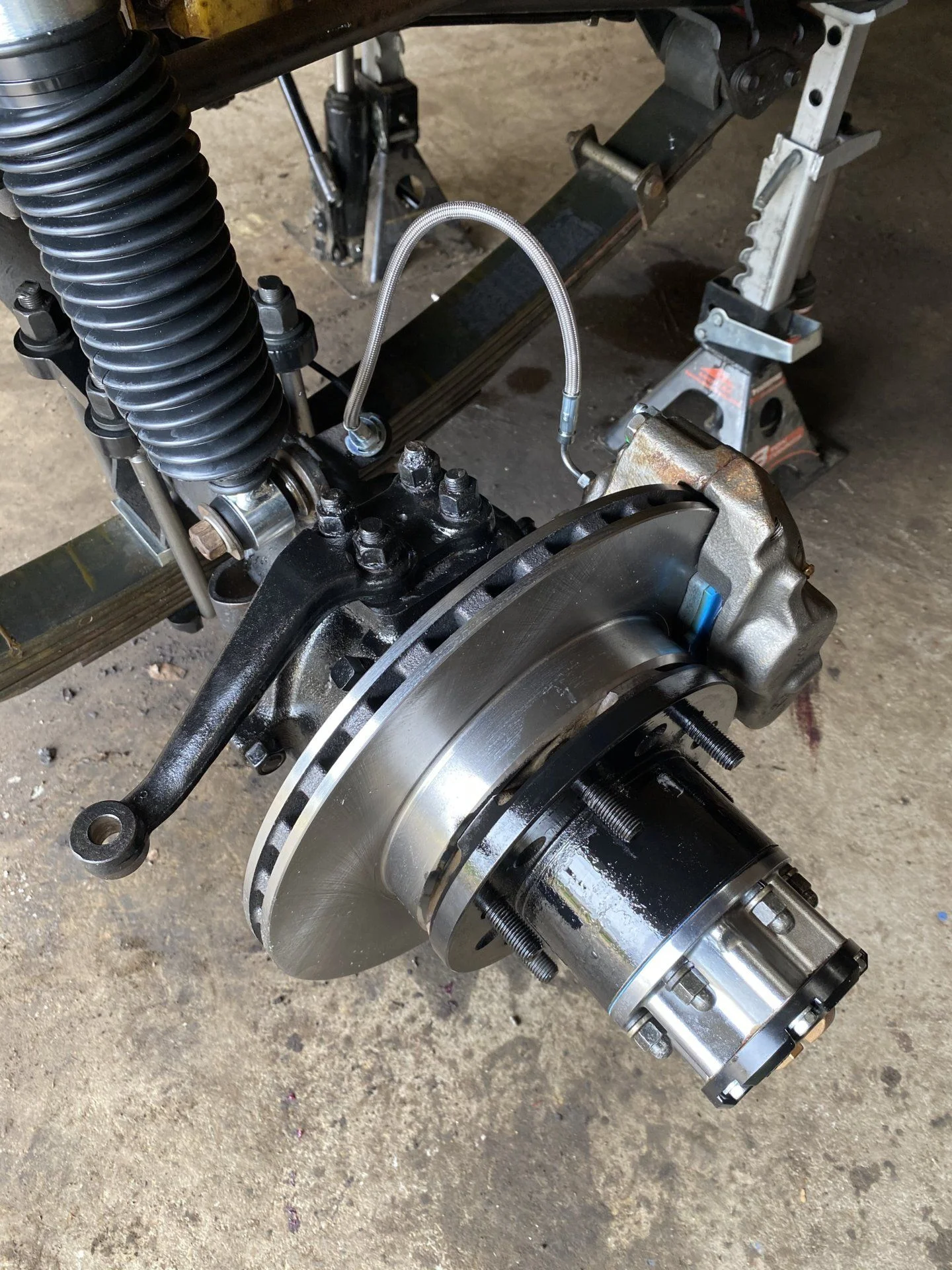

Just when you think, ewwww, that took you 11-12 hours to just get to the spindles yesterday.......
Then you have more.

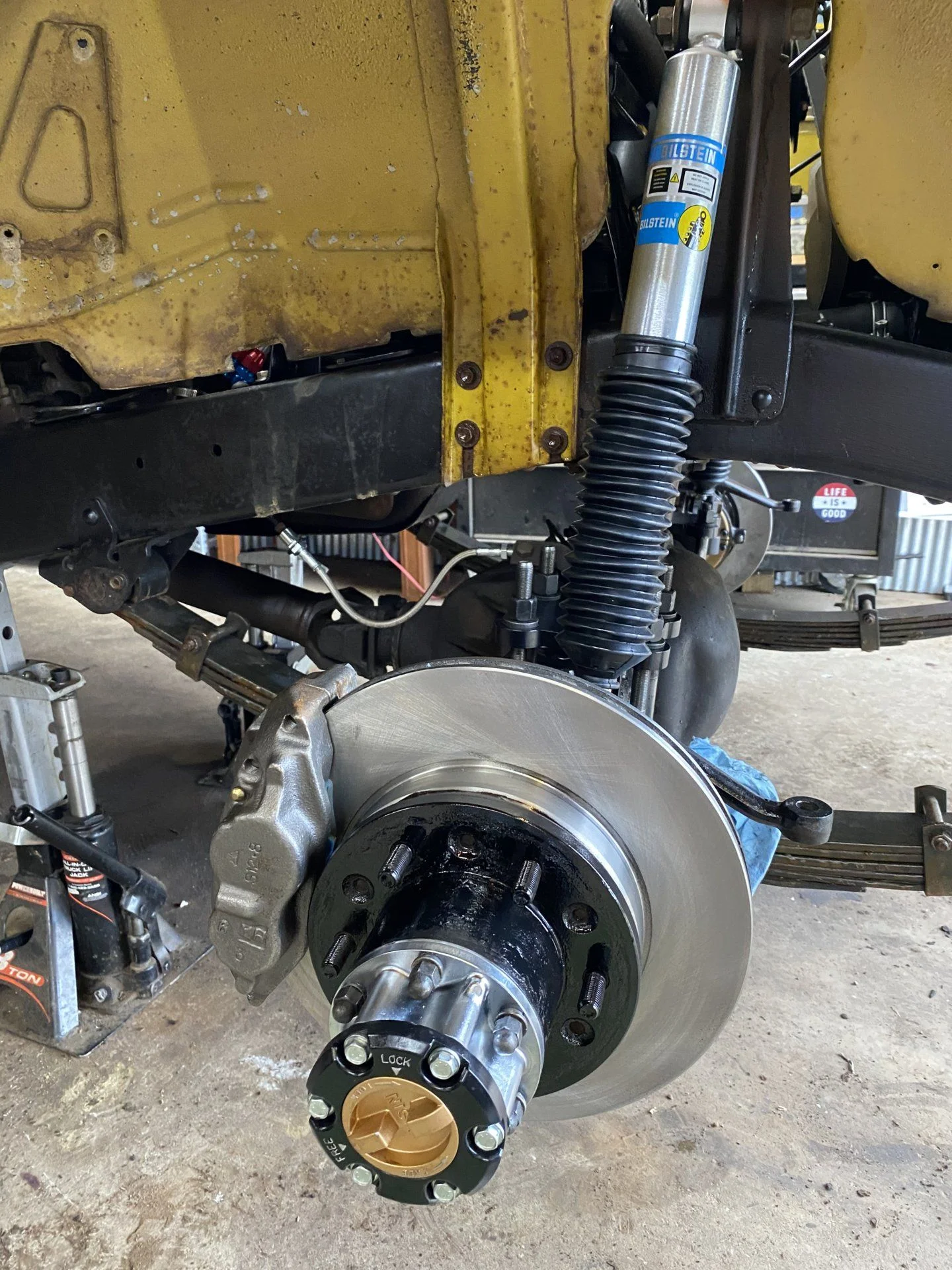

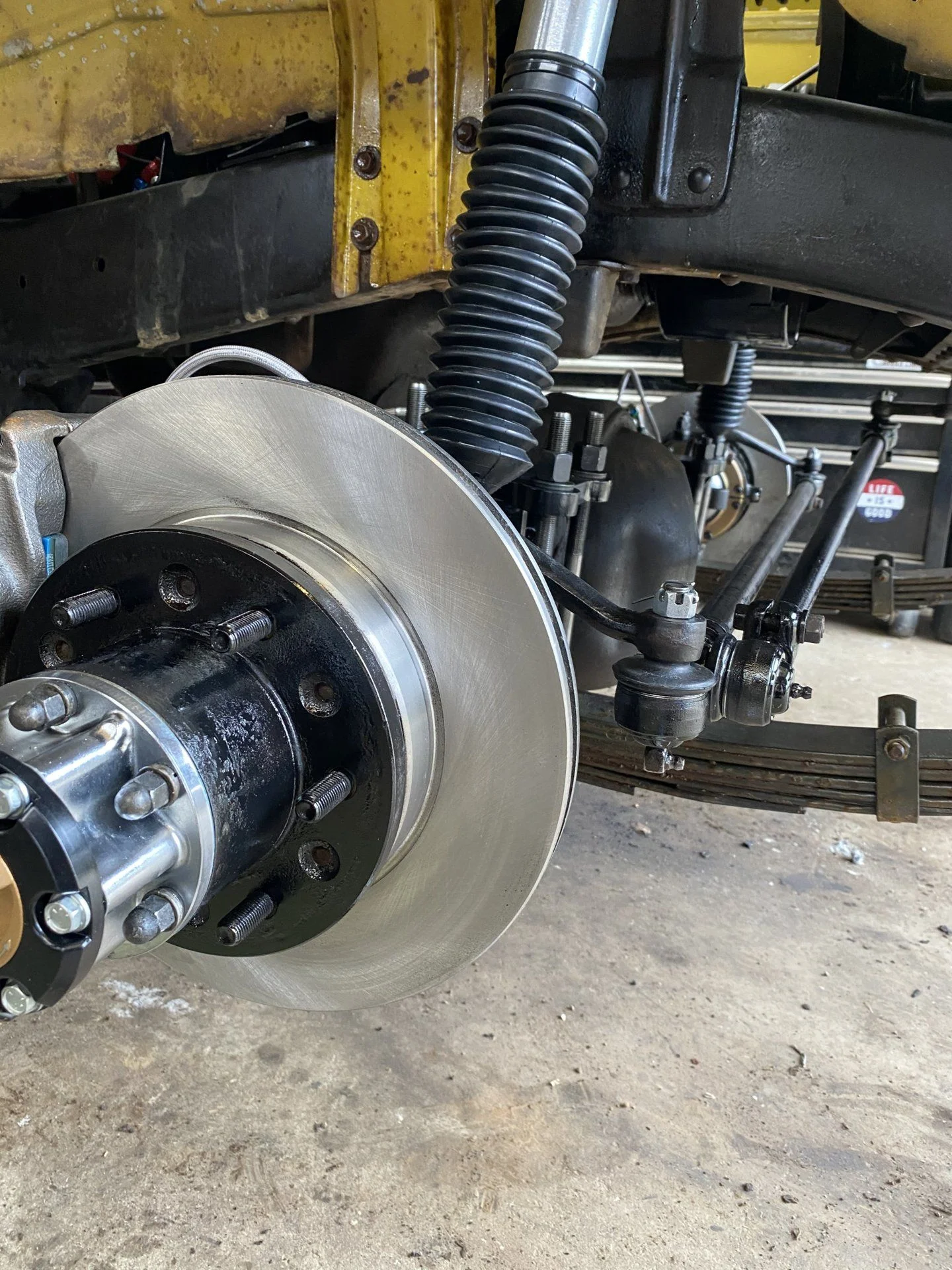

In this case it was removing the old Warren Hubs with their gas station replaced hub studs and redoing. 90* stainless lines with backing plate eliminators from @orangefj45
I robbed my 60 knuckles I have set aside for The Goat for the cone washers, washers and nuts. Beno is sending me all the parts I had to borrow.
Gold face Asin hubs from City Racer worked fine on the 78 birfs. I was a bit worried they would be the goofy long birfs like I have in my 77 FJ55
Then the tie rod and drag links get built. Luckily these were straight and we just had to get rod ends from @cruiseroutfit

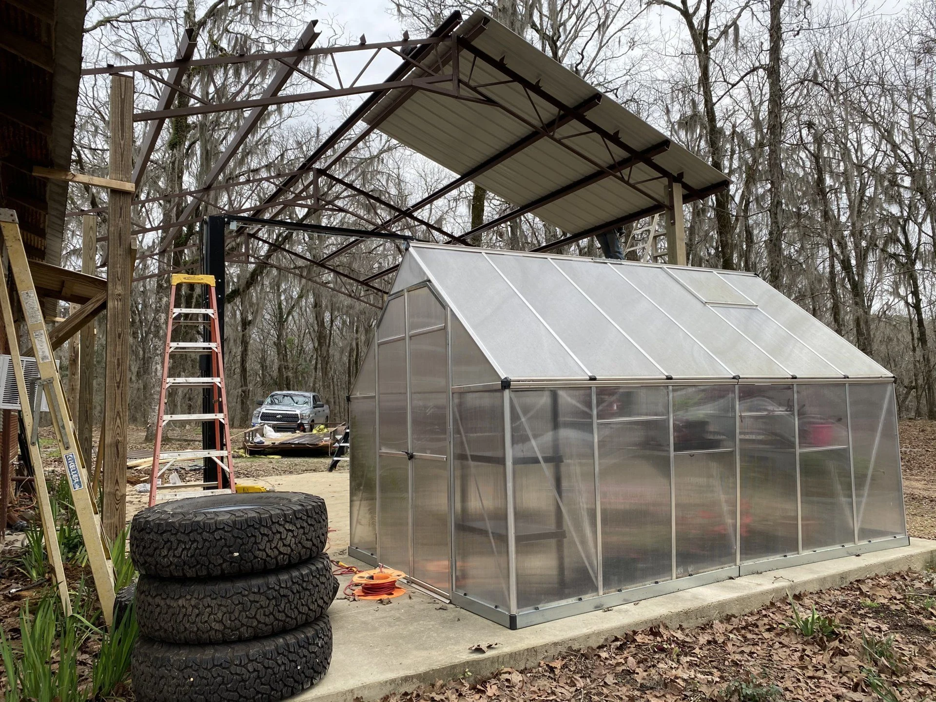

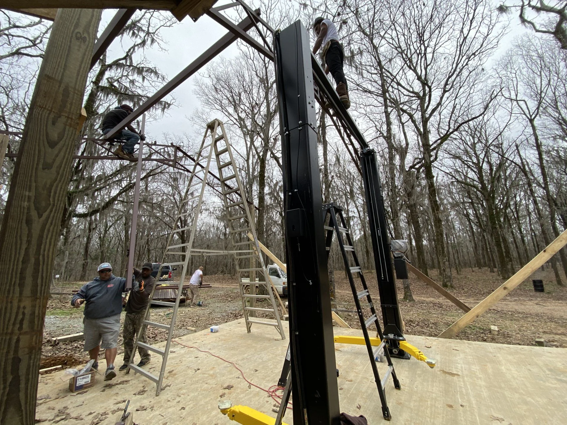

I had told the owner of Weenie 3 I was going to seal up the TCase on it today but the guys building my shop roof called and said they were coming today
Damn it feels great to finish a major project like this. Everything looks good. Everything that came off is in the trash. It was a hot mess in that axle. So glad to have this truck safe and sound and good for many years.

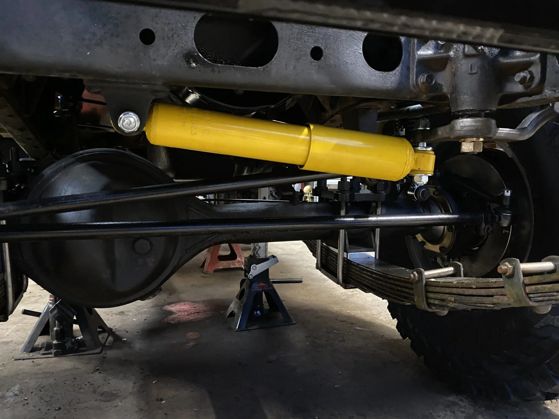

OME stabilizer on. TREs adjusted. All is well with #mustard78
The guys finished up the pole barn. @USMC22 is headed up tomorrow to lend a hand getting Weenie3 finished off.
The parts table is getting less crowded but there is PLENTY left to do.

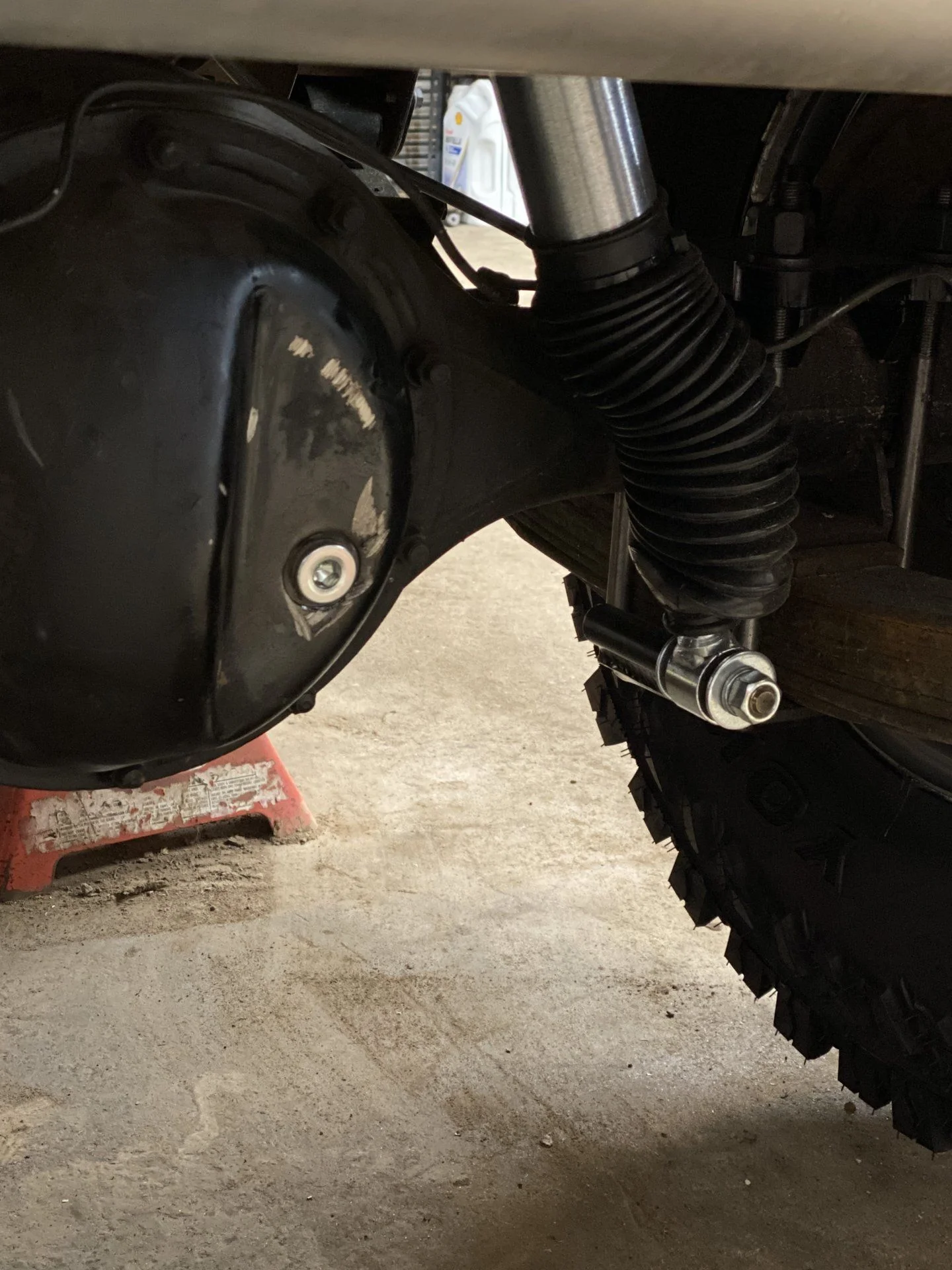

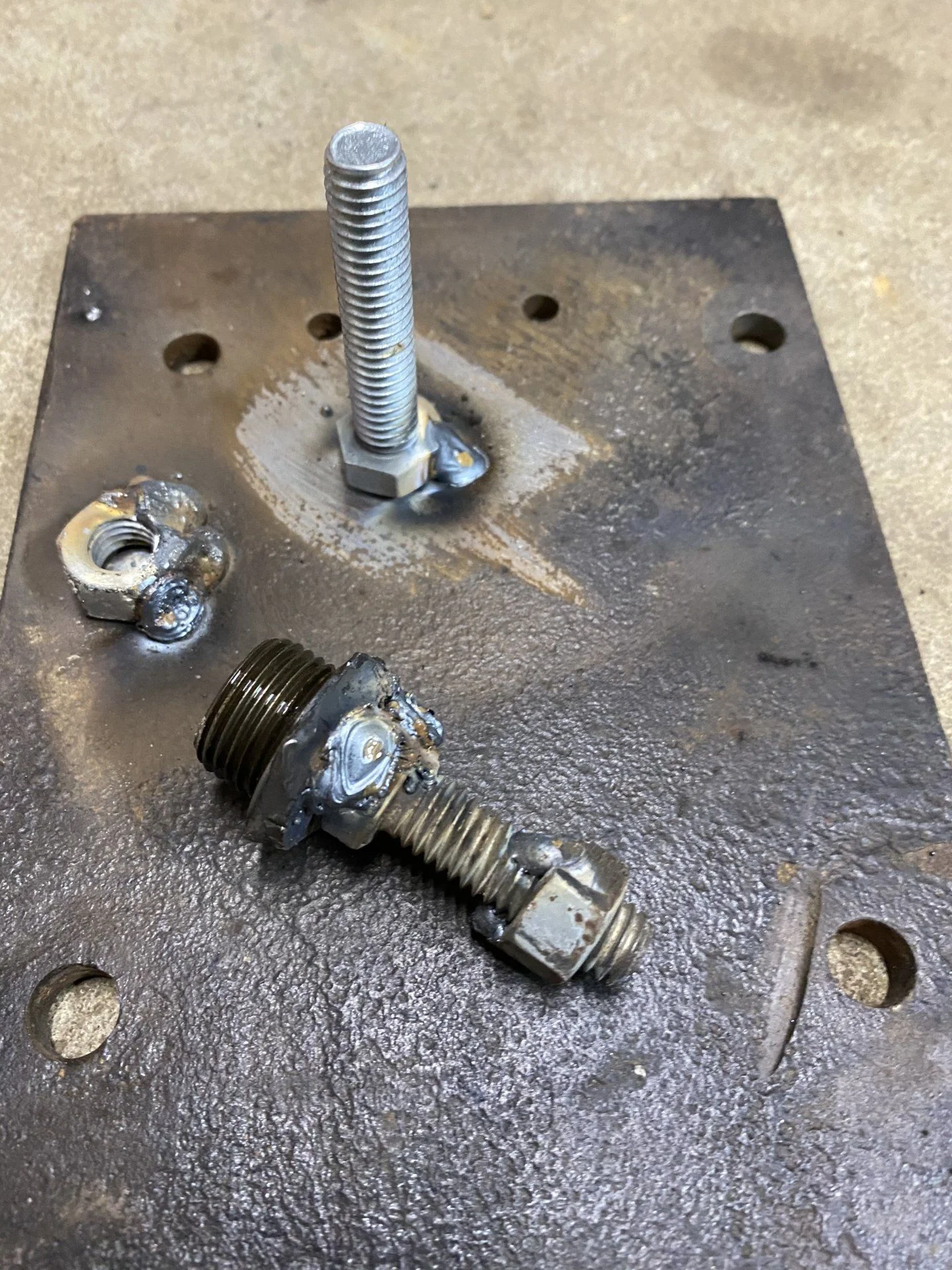

I started off wanting something easy so I dropped the old 90wt out of the front axle and added Hex Plugs.
Moved to the rear axle and the Valvoline guys in Oregon got me again. The rear fill plug was completely round.
Good excuse to bust out the new welder.
Easier said than done. Forgot to set the regulator so I buggered it up first try then made a practice bolt. I had to put the ground on the vice grips I was holding the bolt with so I was all over the place but got it.
5 minute to 50 minute job. Thanks Quick Lube guy.
