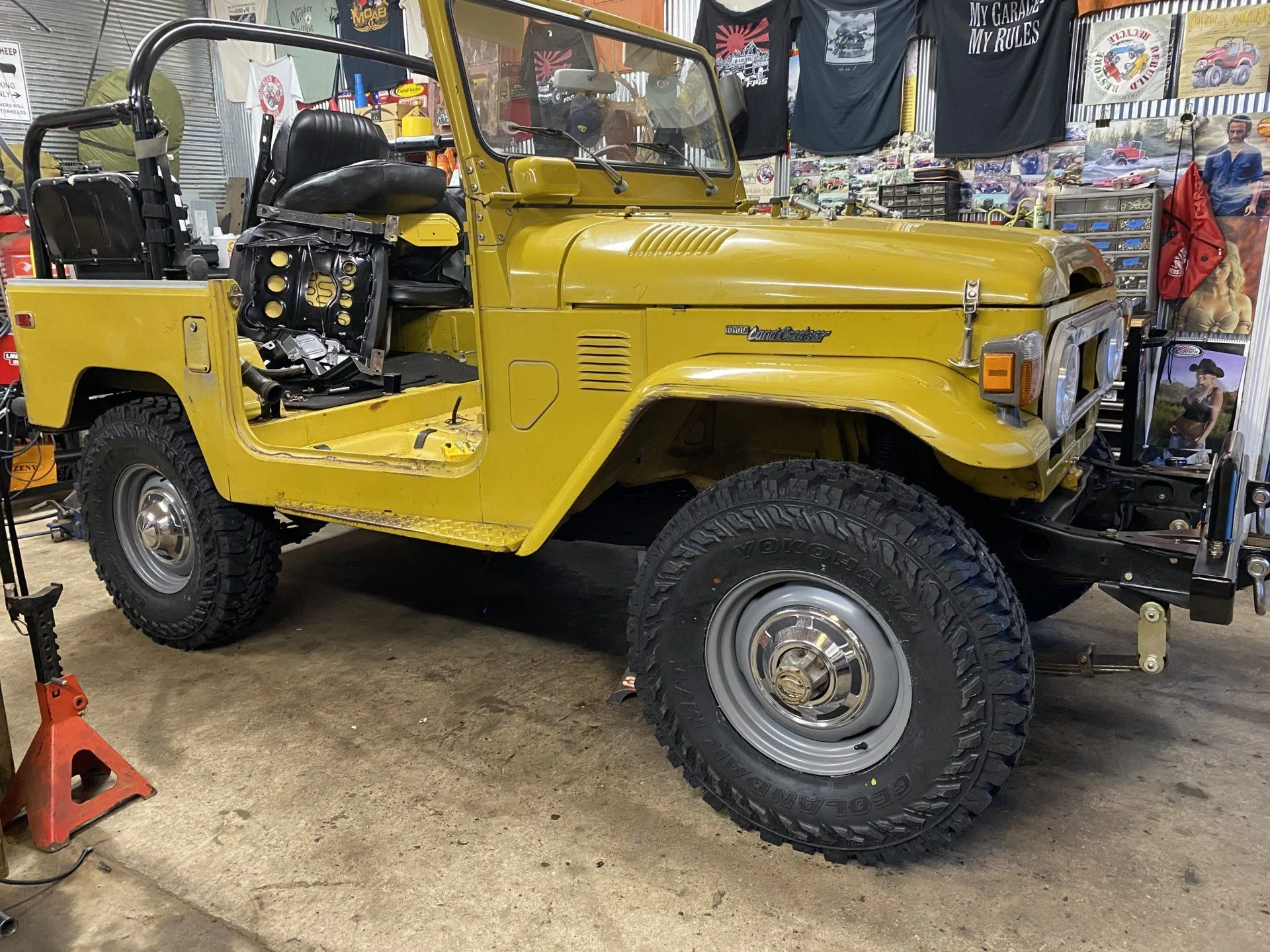

very interesting. So will it ride smoooother!!!???

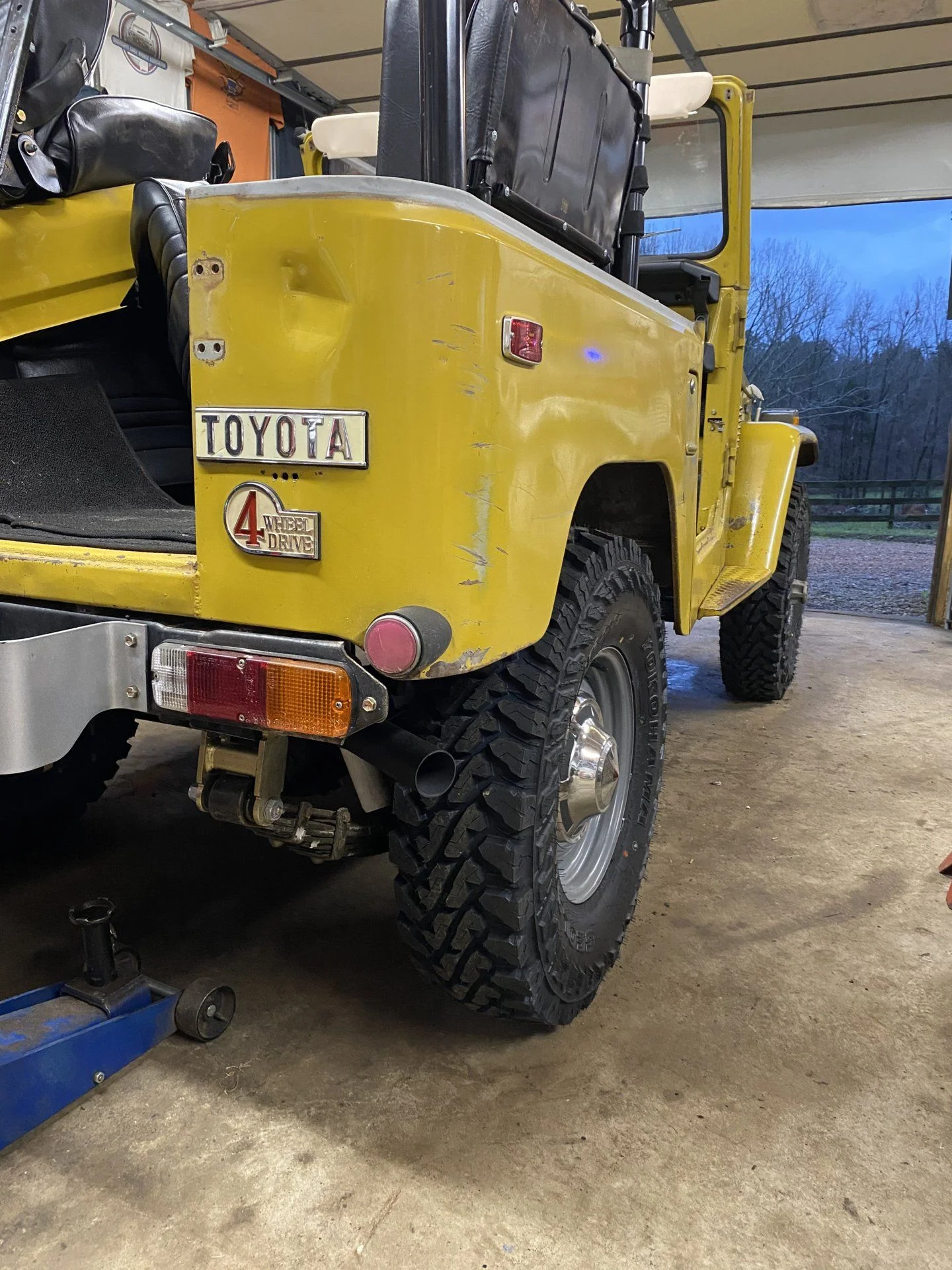

Well, KO2s ride great. These are taller by 2” and narrower by just under 2” with about the same size sidewall.
I got a 300 rpm drop in 4th gear going from 33x10.50-15 KM3s to the 255’s like these on my FJ60. That is a legit drop when you are rolling down the interstate with a 2F
Narrow tires steer better too......
Plus relics need MTs.

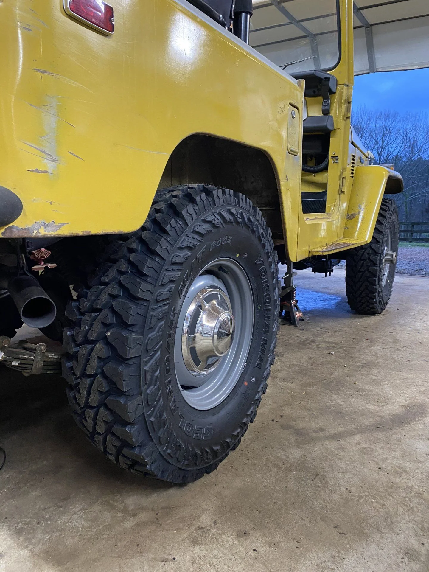

Sorry I can’t pull it out of the shop but I did drop it off the jack stands for the pics.

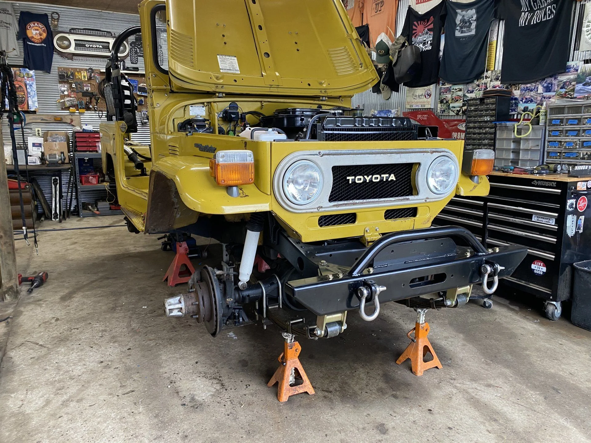

My wife is out of town so I stayed at it until 7:30.
I decided to work the easy end first before tackling this mess.

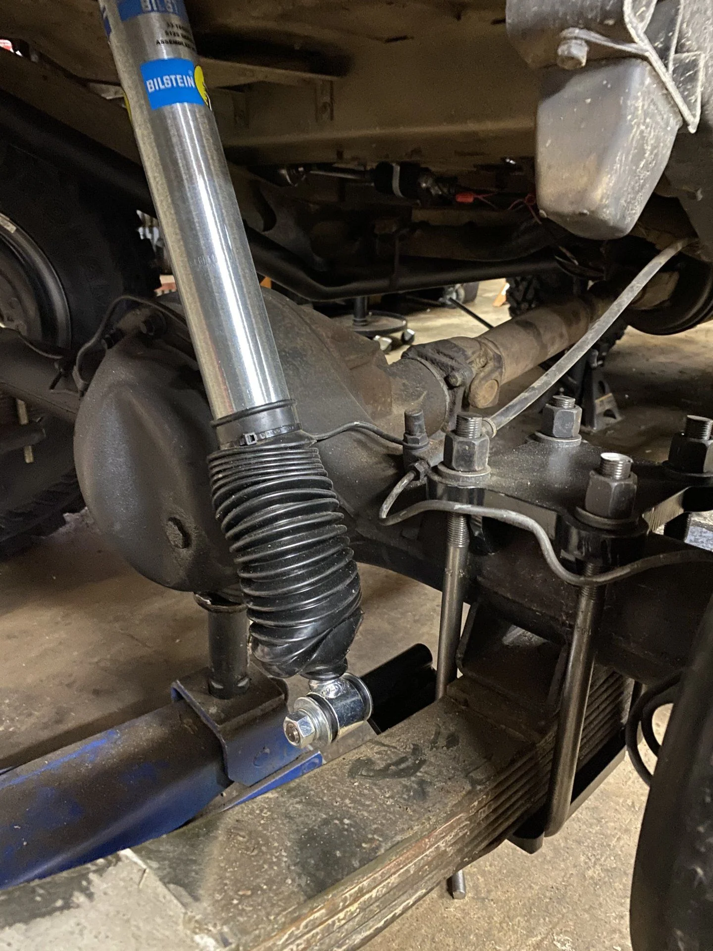

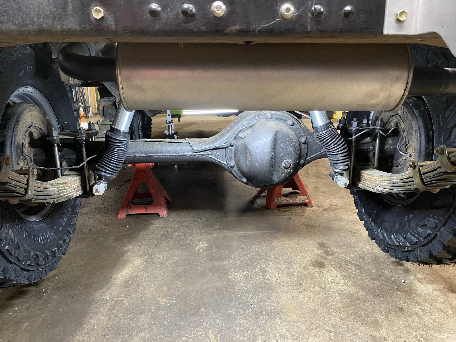

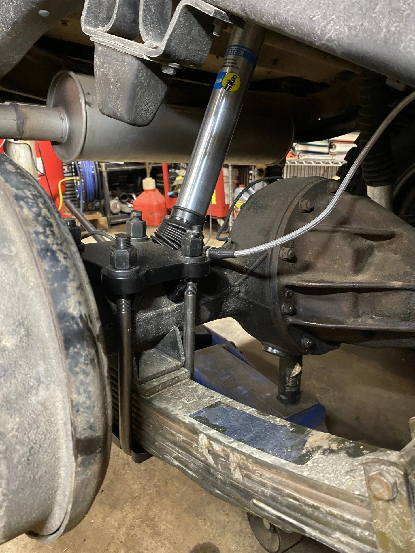

The owner of Weenie 3 asked for a 4Plus flip kit and Bilstein shocks. After installing them and driving on the shocks, I’m sold on the combo.
The rear brake line was banjo tight even before being flexed out so an extended stainless hose was added
Got the rear done and the stickers off the leaf pack (pet peeve)
Moving on to the nasty end tomorrow

Newbie here, what is advantage of flip kit?
Well, it get the bolts up instead of down if you are whomping though the rocks.
Or it gives you a beautifully clean Ubolt setup.
Its not cheap but it’s only about 40% more than OME ubolts

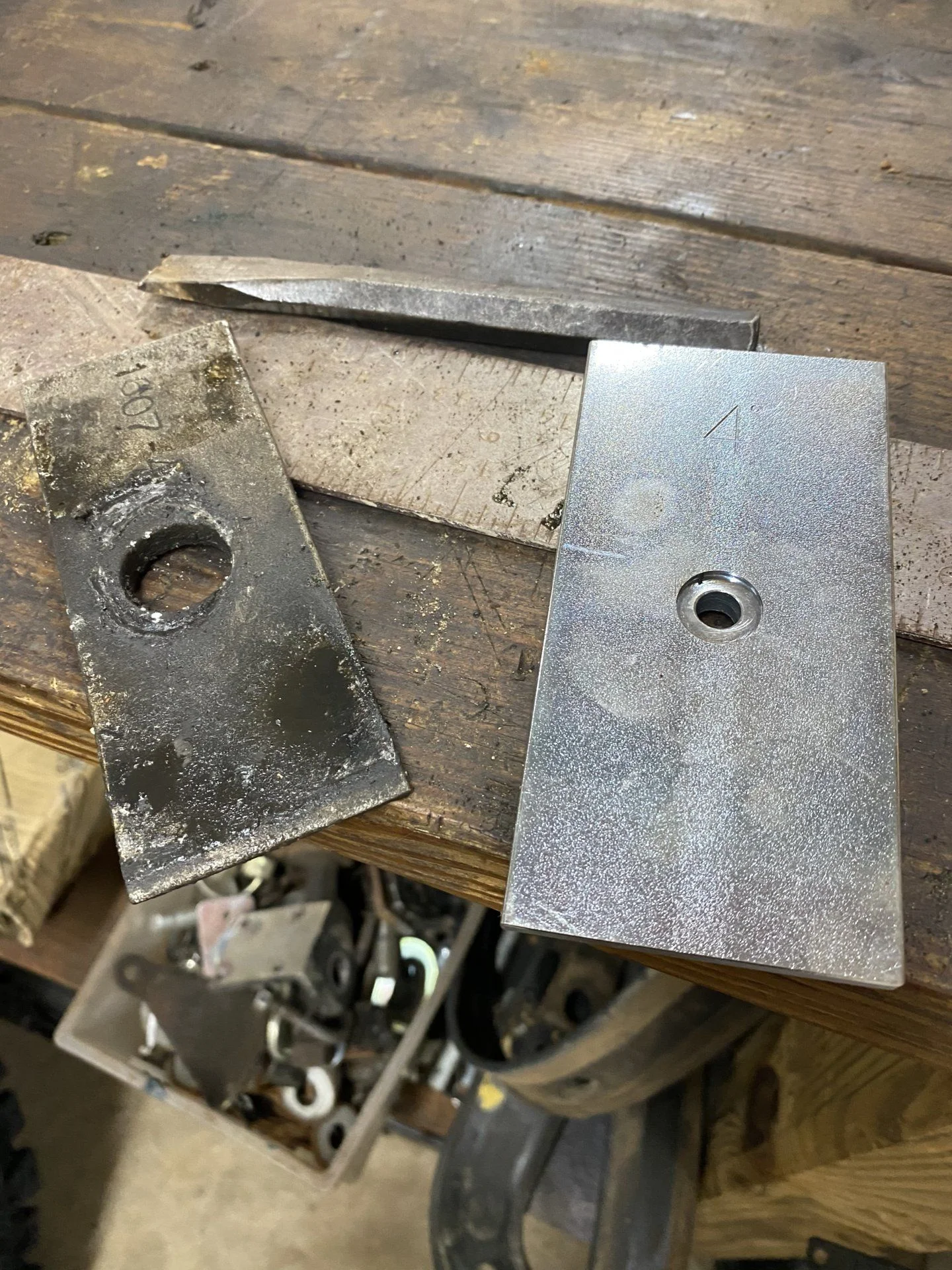

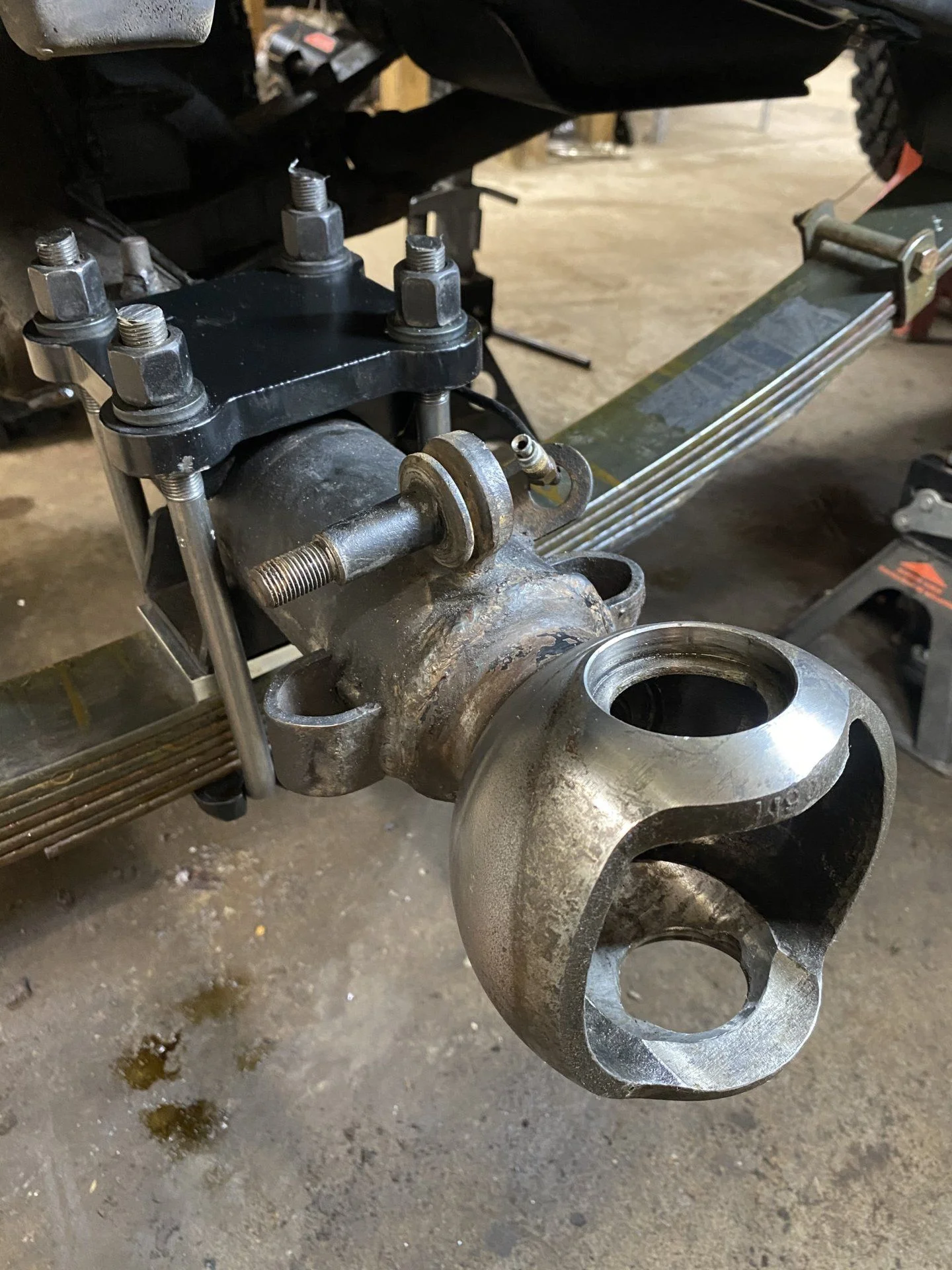

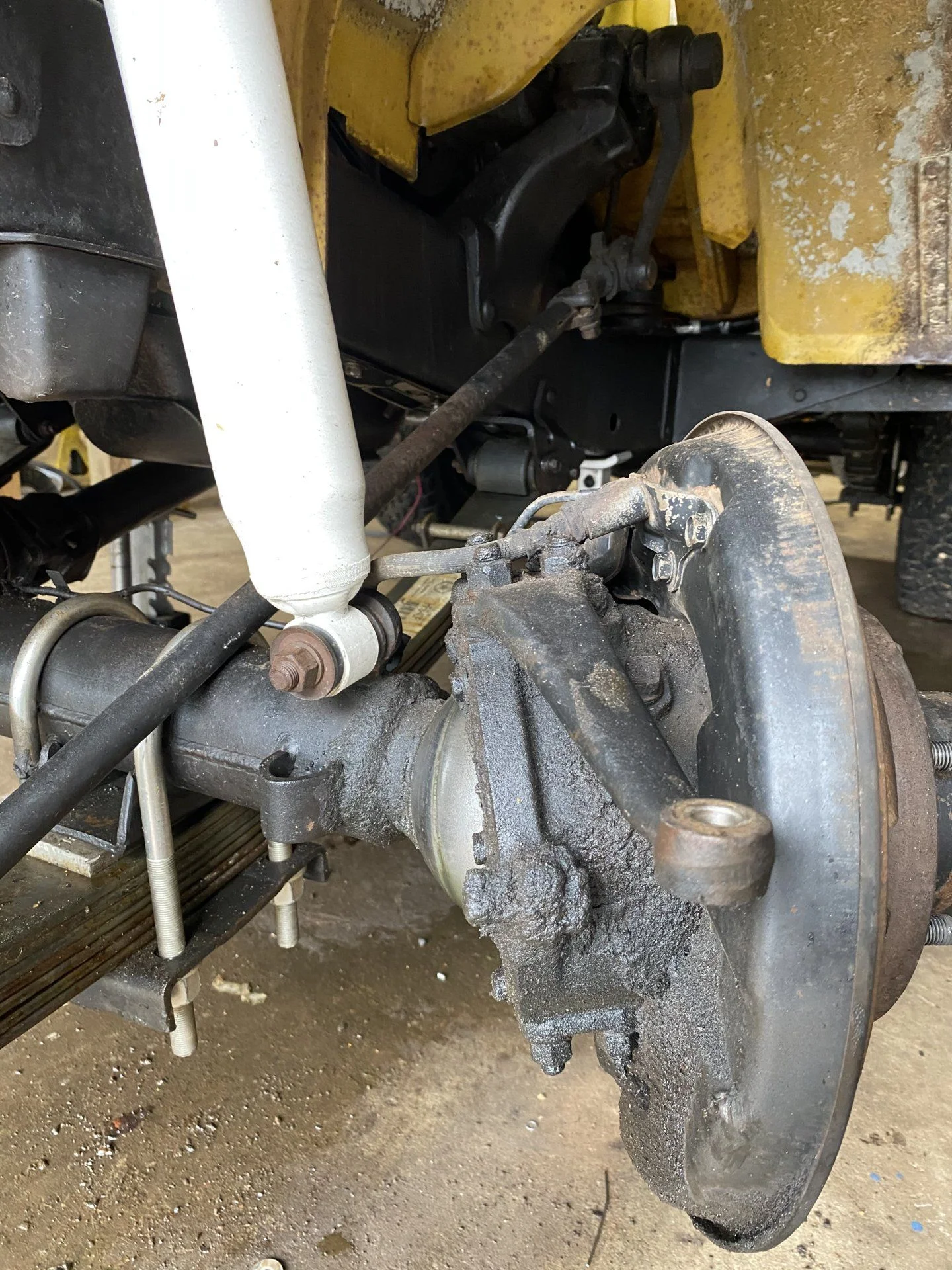

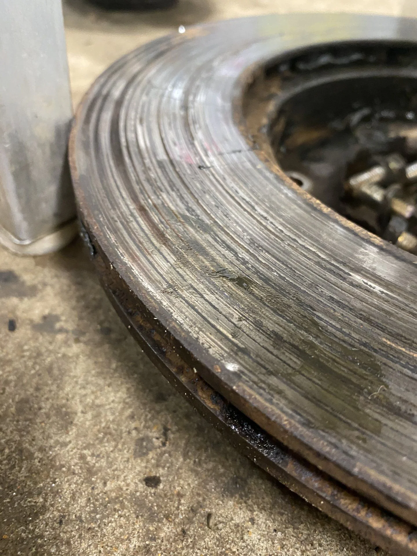

Folks, please. Don’t use these crappy aluminum caster shims. Get the proper steel ones from @orangefj45
These were already showing signs of wear.

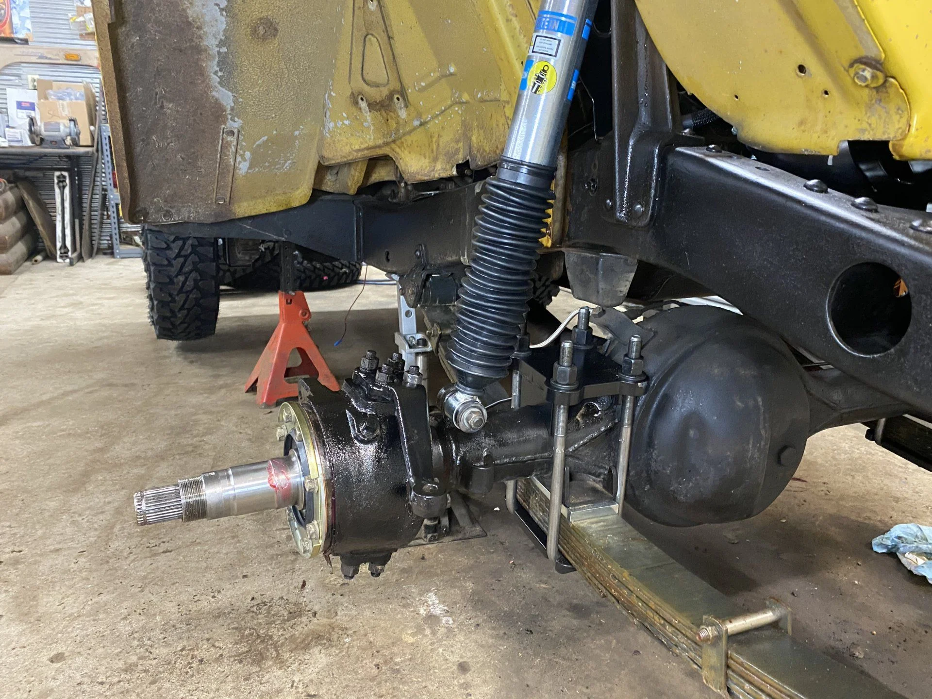

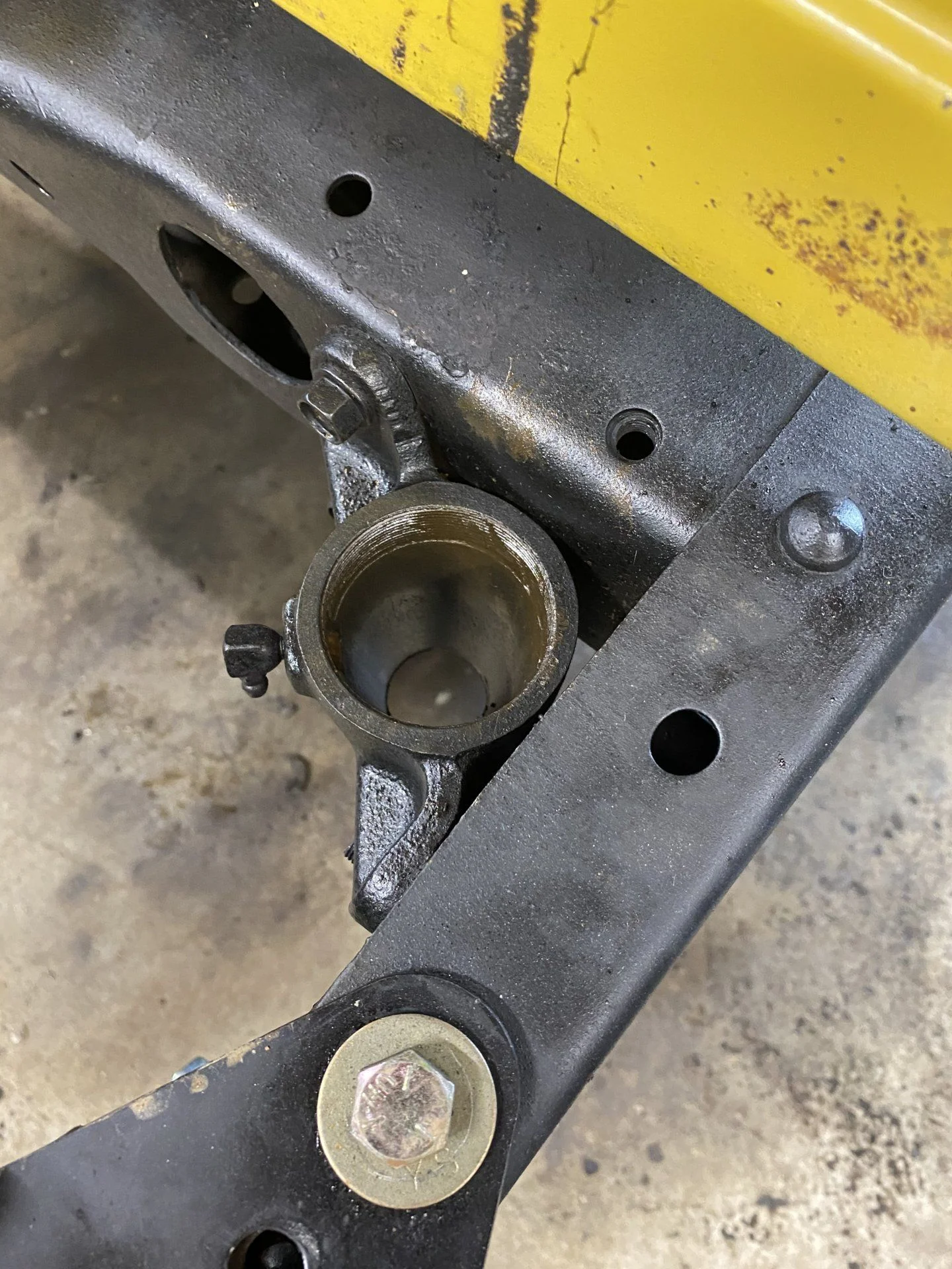

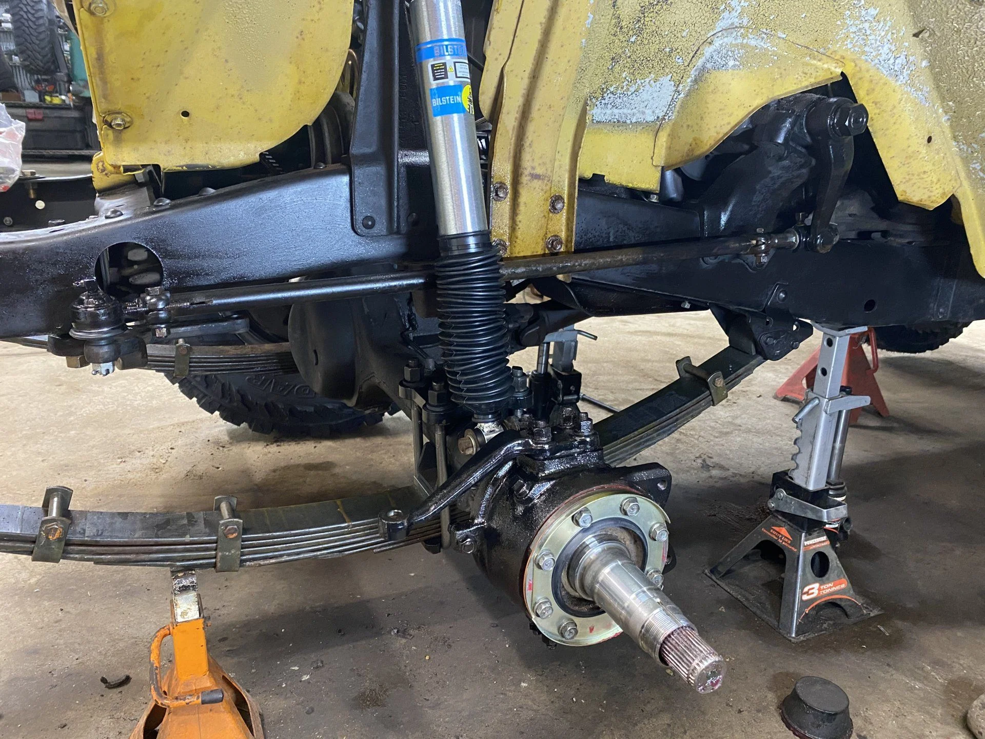

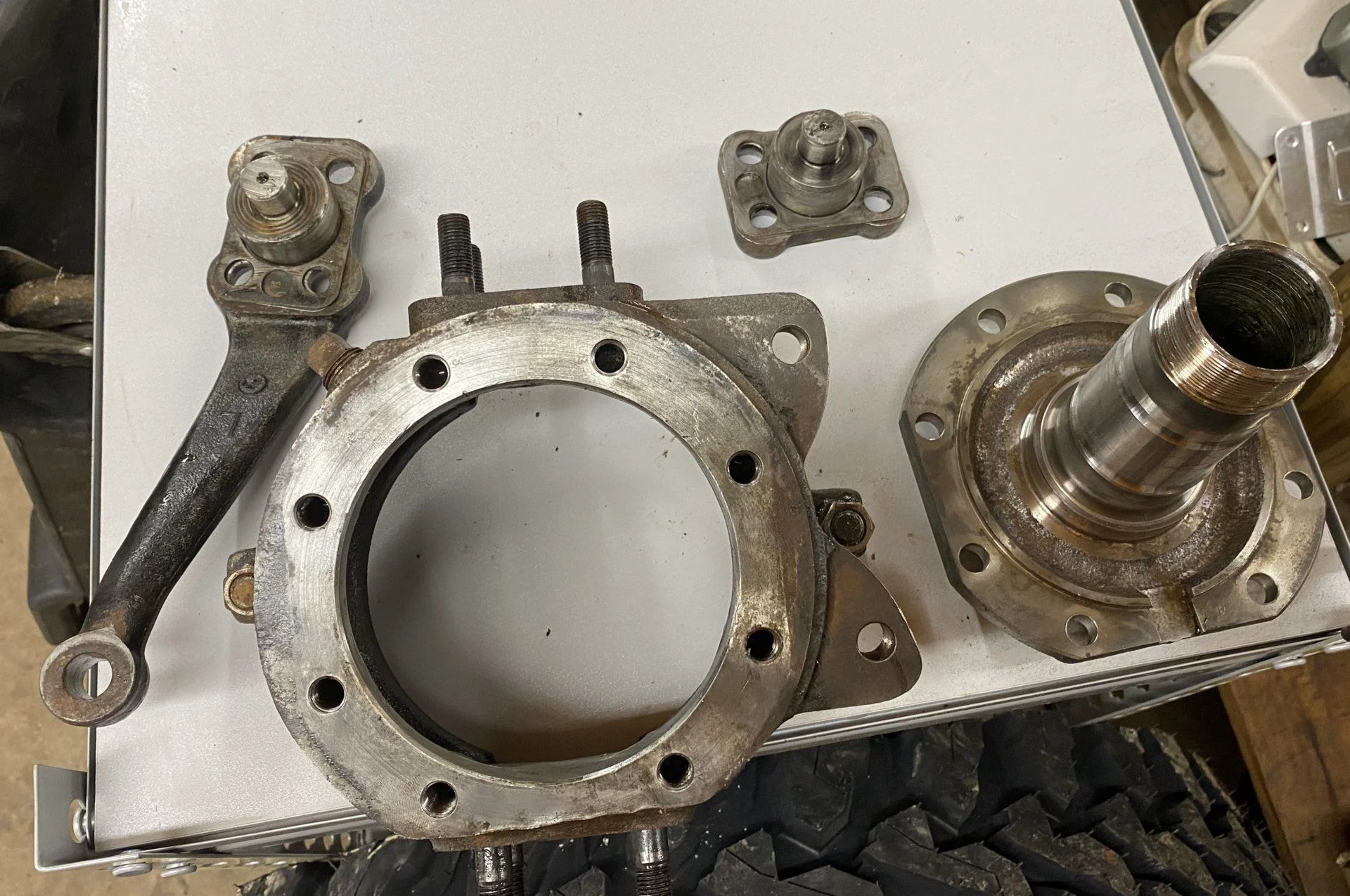

Got the hub and the knuckle ball cleaned up. The rest is still soaking. I got the rest of the steering linkage pulled and the center arm that was completely loose.
Flip Kit on with shims and new spring pin.
Slow and steady.

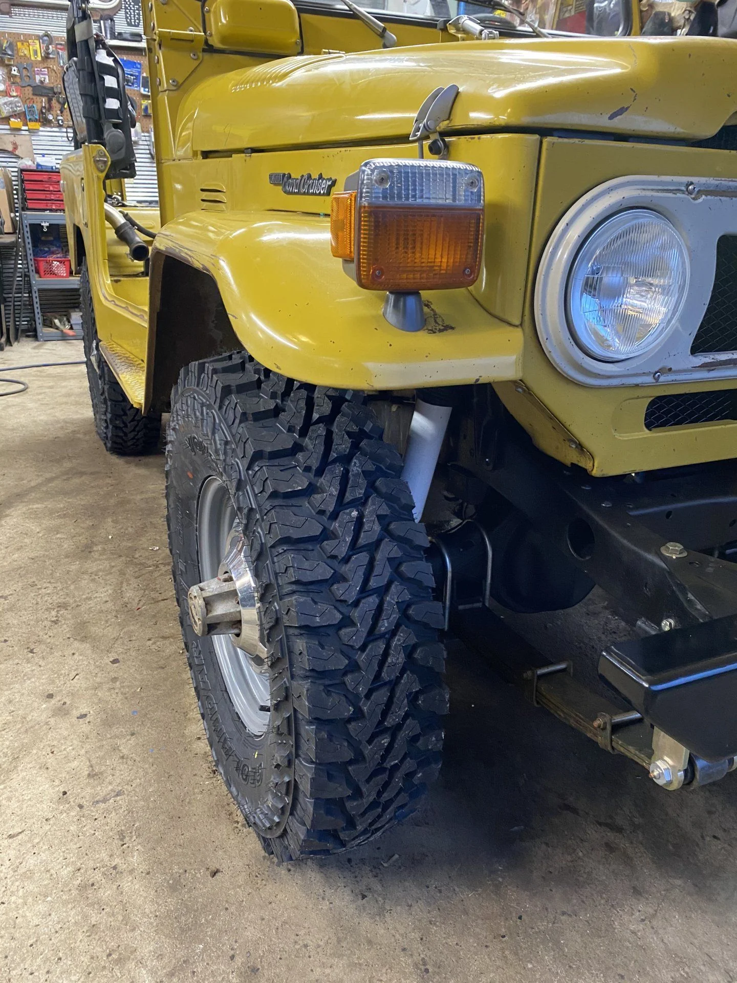

Looks great. OME 2.5 springs? I still need to decide between that set-up and 255/85 or clone yours at stock height and 235/85. Would the airbags you used in the rear on project patina work with the U-bolt flip kit? Keep up the great work.
EDIT: Found it on thread review, HFS springs. Sorry for the hijack. Love it, can't wait to join the patina refresh once I'm in the same state as my 67.
Love those Yokohama’s. I have those Same G003s, same size.
I’ll interject, I love the 255’s but the 235s are more common. You would have a better chance of finding them if you happened to blow one and need another spare. That said, with a spare you should be good to go. Make sure to get a brand that has regular sized tires, not undersized ones. I’m very partial to Yokohama G003.

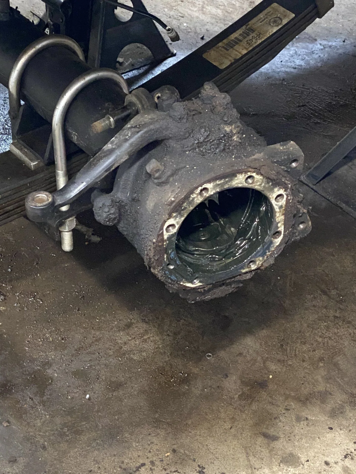

There is a very good reason why a shop will quote you $1200 or more to do a full knuckle job
This. Job. Sucks.
View attachment 2184713View attachment 2184714View attachment 2184715View attachment 2184716View attachment 2184717
Because of the cleaning. I don't mind the disassembly of dirty parts and I like the assembly of clean parts. The cleaning makes this an odious job.
No way I'd pay a shop because I wouldn't want some clueless tech using a chisel on the lock nuts.

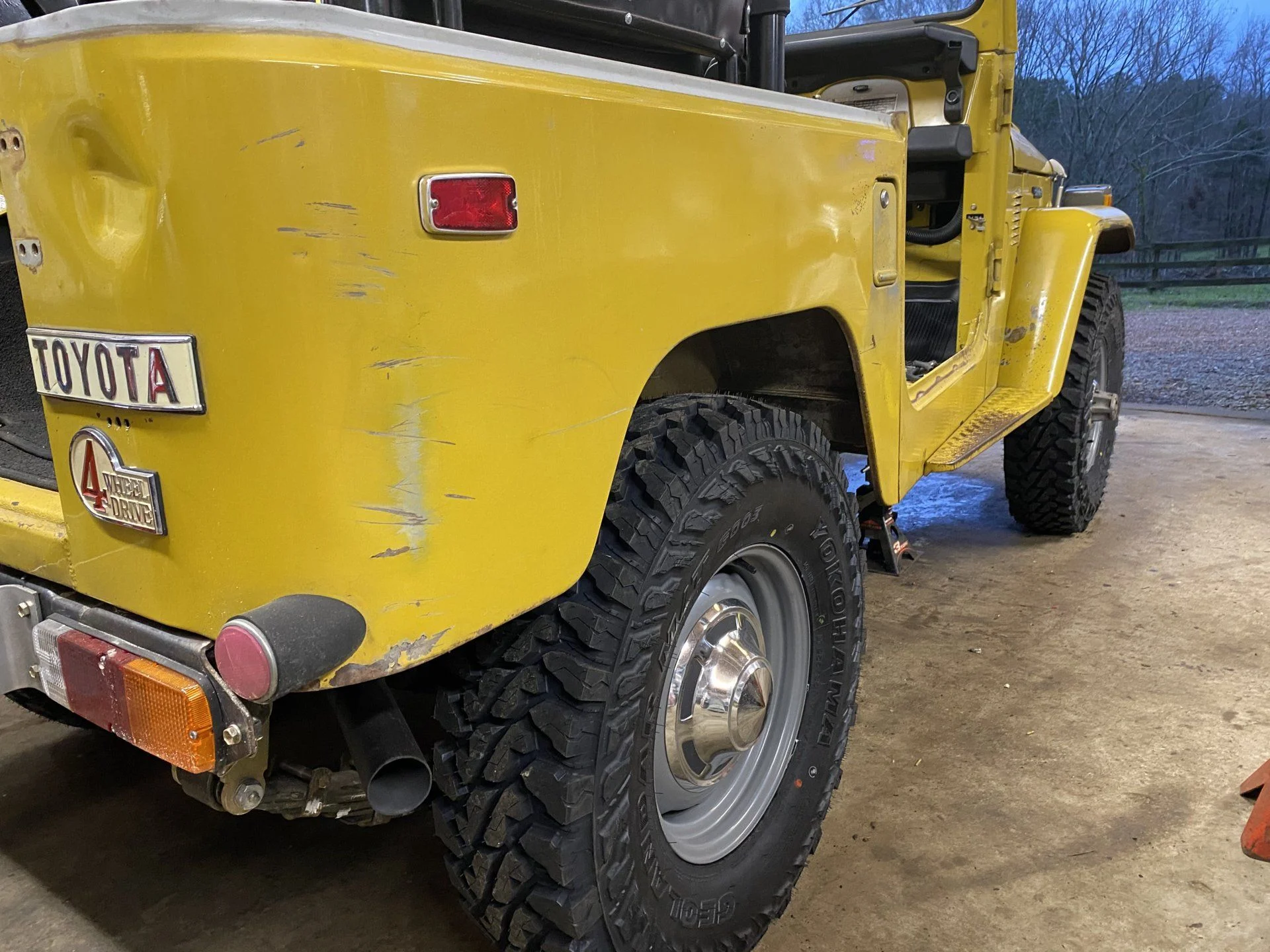

When I first agreed to give the truck a baseline and tune (funny), I had seen where John had mentioned that he did not like the KOs and was going to get KM3s.
I quickly messaged him and asked if he had purchased tires yet. He said no and I went into my rant about how tiny 33x10.50-15’s are and would he be open to another style and size.
With a 4 speed and 4.11s you want all the rubber overdrive you can get and seeing that the KM3 measures out 30.5” tall on a Cruiser wheel I suggested he get gray City Racer 16” replica wheels like I run on my 40 and 45 as well as my favorite MTs .... Yokohama G003 MTs in 255/85-16
@wct49 ordered these oddballs up for me and mounted them today
Beautiful. 32.5” tall and 9” wide. I run them on my 60 and 40 and they are superb tires
Yokos and Toyos come with this cool little dot that, if you line it up with the valve stem you can get the best balance with the least amount of weight. 49T was able to keep what little weight they needed on the inside of the wheel as well.
