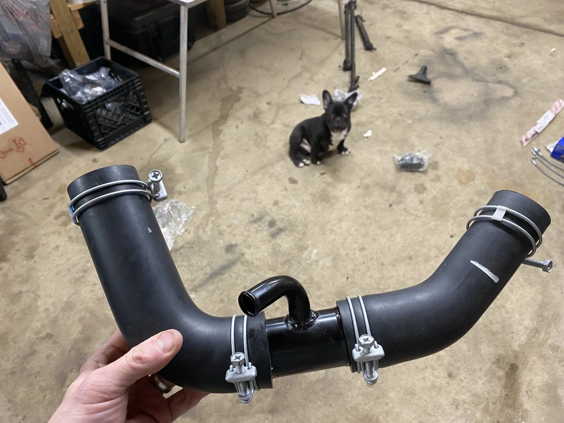

The thing I love about OEM hoses is you don’t have to monkey with trimming them. They are the perfect length.

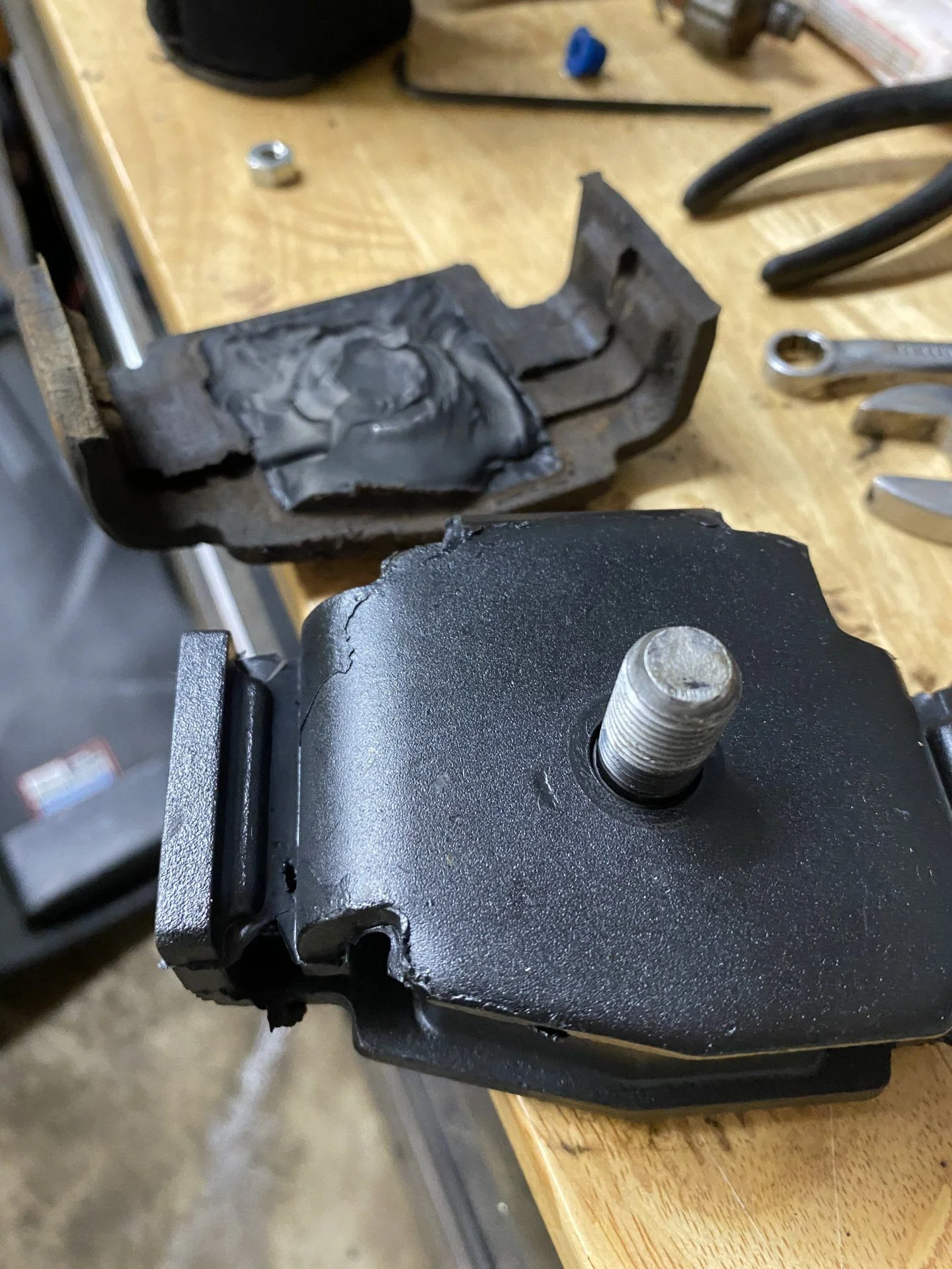

Drivers side motor mount is installed. OEM motor mounts are superior to aftermarket. I snapped a brand new set doing clutch dumps in the Warthog. The OEM ones laugh.

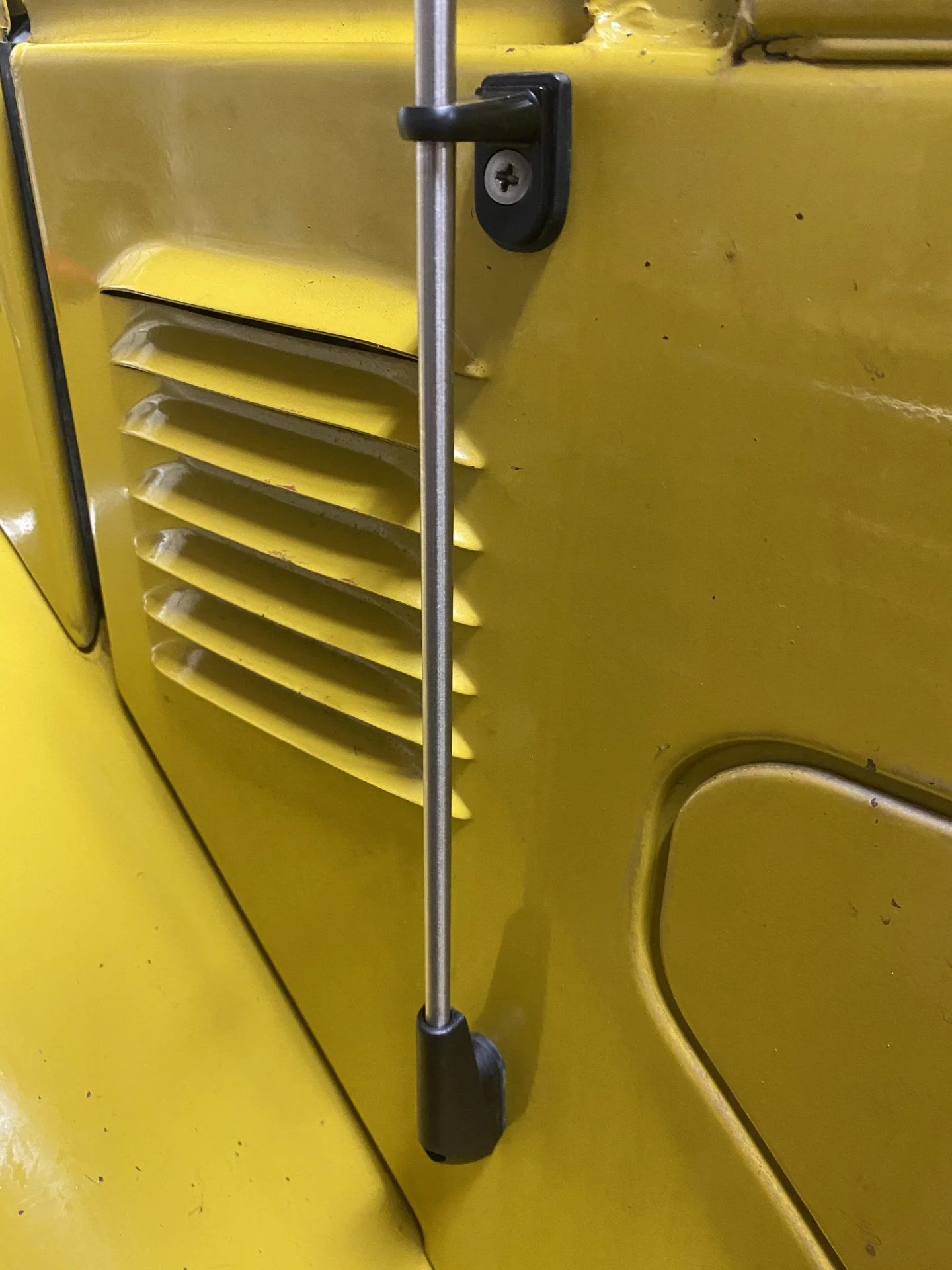

This OEM antennae is really nice too. Crazy you can still get them.

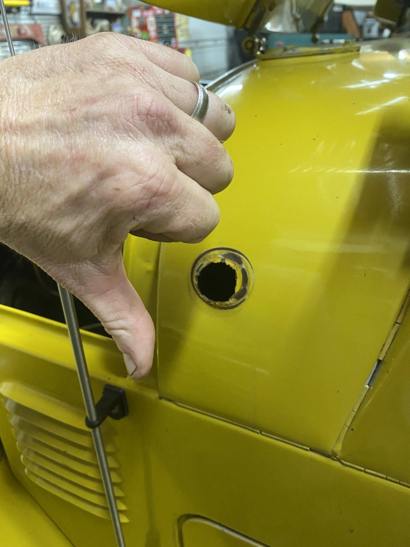

This hole in the cowl, however, is not nice. It looks like a damn rat chewed a hole there. For such an original, non molested truck, this kind of stuff offends me

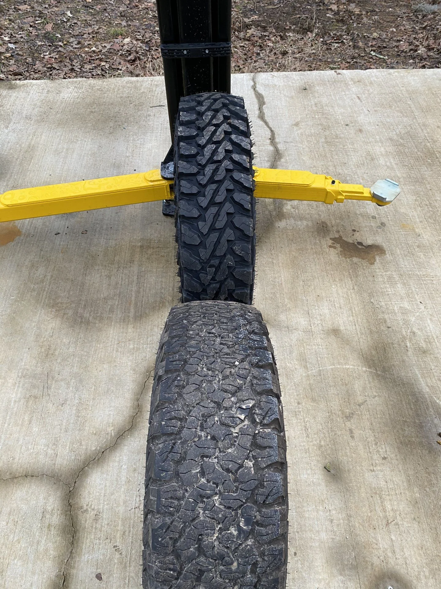

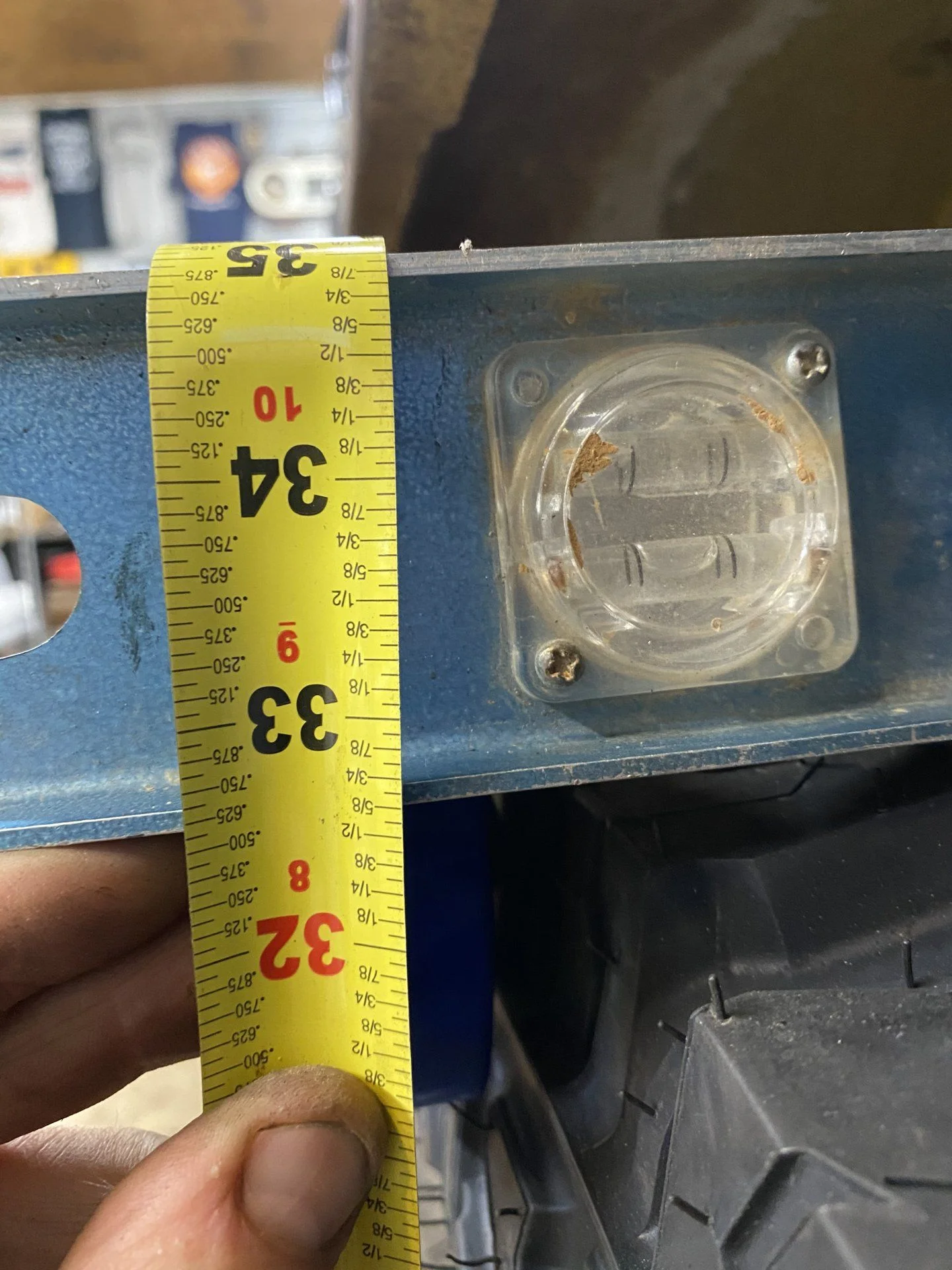

When I first agreed to give the truck a baseline and tune (funny), I had seen where John had mentioned that he did not like the KOs and was going to get KM3s.
I quickly messaged him and asked if he had purchased tires yet. He said no and I went into my rant about how tiny 33x10.50-15’s are and would he be open to another style and size.
With a 4 speed and 4.11s you want all the rubber overdrive you can get and seeing that the KM3 measures out 30.5” tall on a Cruiser wheel I suggested he get gray City Racer 16” replica wheels like I run on my 40 and 45 as well as my favorite MTs .... Yokohama G003 MTs in 255/85-16
@wct49 ordered these oddballs up for me and mounted them today
Beautiful. 32.5” tall and 9” wide. I run them on my 60 and 40 and they are superb tires
Yokos and Toyos come with this cool little dot that, if you line it up with the valve stem you can get the best balance with the least amount of weight. 49T was able to keep what little weight they needed on the inside of the wheel as well.
