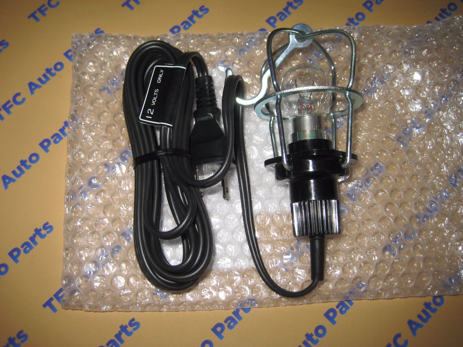

I was reading through my helpful Owner's Manual, when I happened across the coolio Inspection Light Socket on page 19.
I decided then and there that I must have this wonderful thing.
About a minute and a half and $21.73 later, I had ordered one. What a cool thing, and for so cheap!
Have I mentioned how much I looooove new toys?
