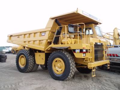

Didn't get much done this week; I did get a job, however. Since I'm retired from contracting, and this is intended to be the last paying job I'll have, I was looking for things that sounded interesting, and not necessarily in line with some kind of promotion path.
I had it down to a big wig job with Principal Financial, a job at a local materials laboratory breaking glass (no kidding) and driving Monster Mining Trucks 300 feet underground.
The 10 year old boy in me ended up choosing off-roading in a big way:
Pay is good, hours are horrible, but I'll be producing an actual product that people need and use, for the first time in my professional life.
I'm wondering if there is an off-shoot of off-roading called "under-grounding?"

When you say underground, I assume open pit with those big boys?

With crop land topping $12,000 an acre, no one open pit mines in our neck of the woods any more. We literally mine limestone through grid style shafts. Deep into the dark go the monster trucks.
