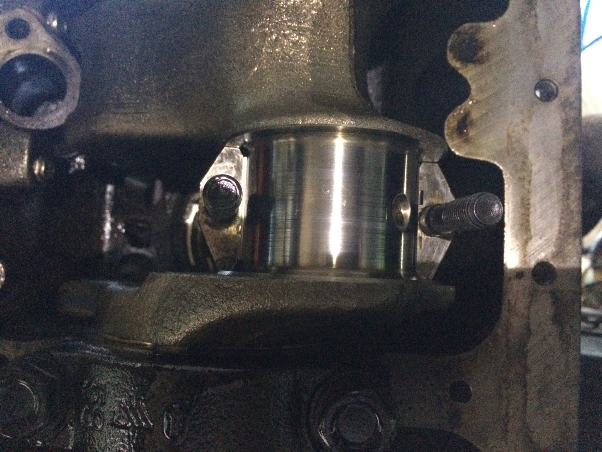

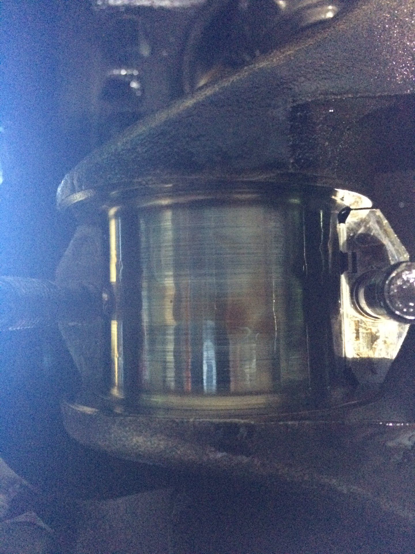

Yes between the journal and bearing. Photos of #2 then 4. First one threw me cuz bearing got stuck to the journal by the plastigage and I had to gently pry it off w/ a wood scraper I made. Hmmm, am I reading this wrong? .025 is what I see...
OH, that's in millimeters. You had me seriously worried for a sec. Let me convert that to Freedom Units real quick.
Yeah, that looks fine. Put up a picture of the bearing.

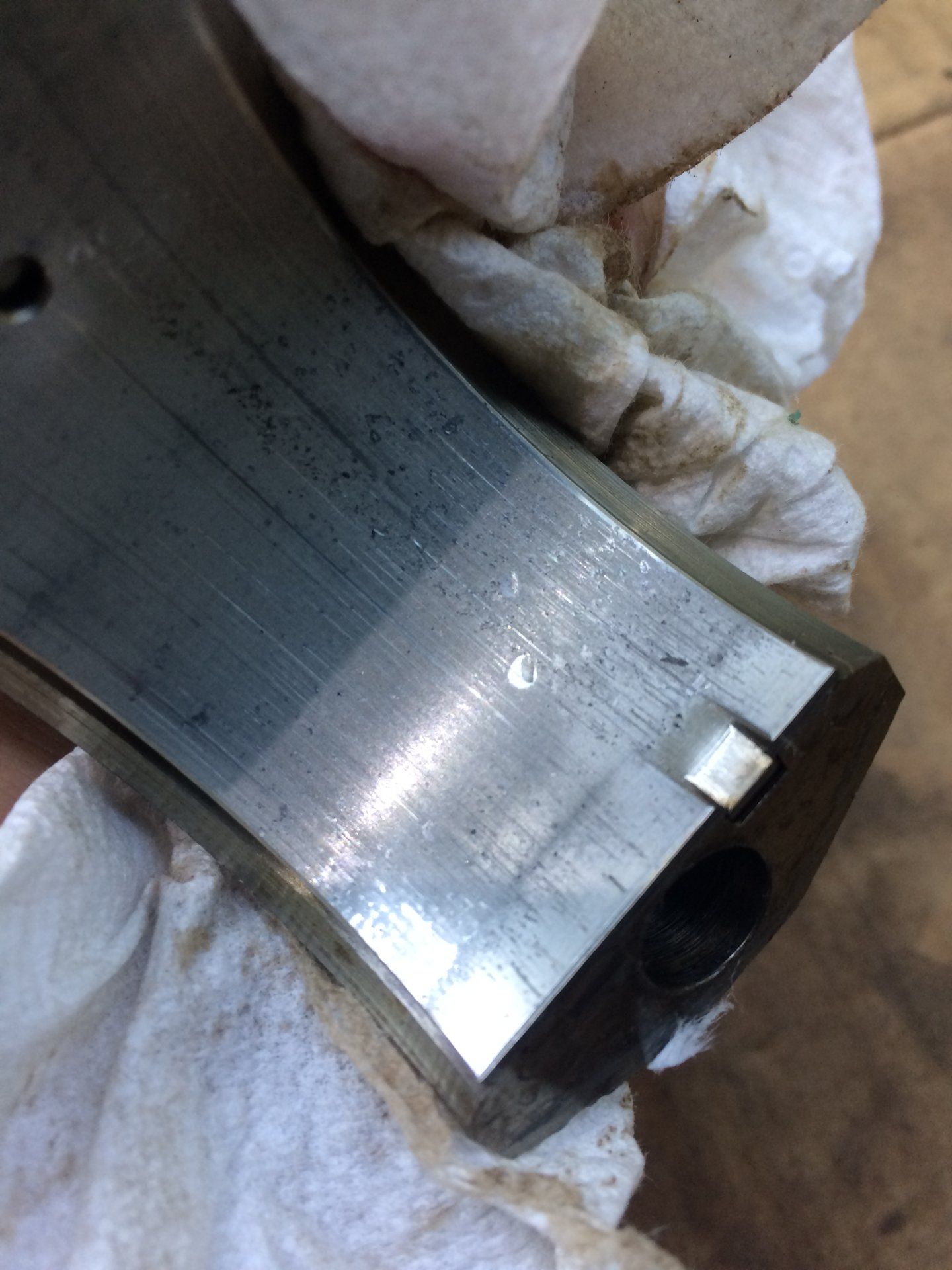

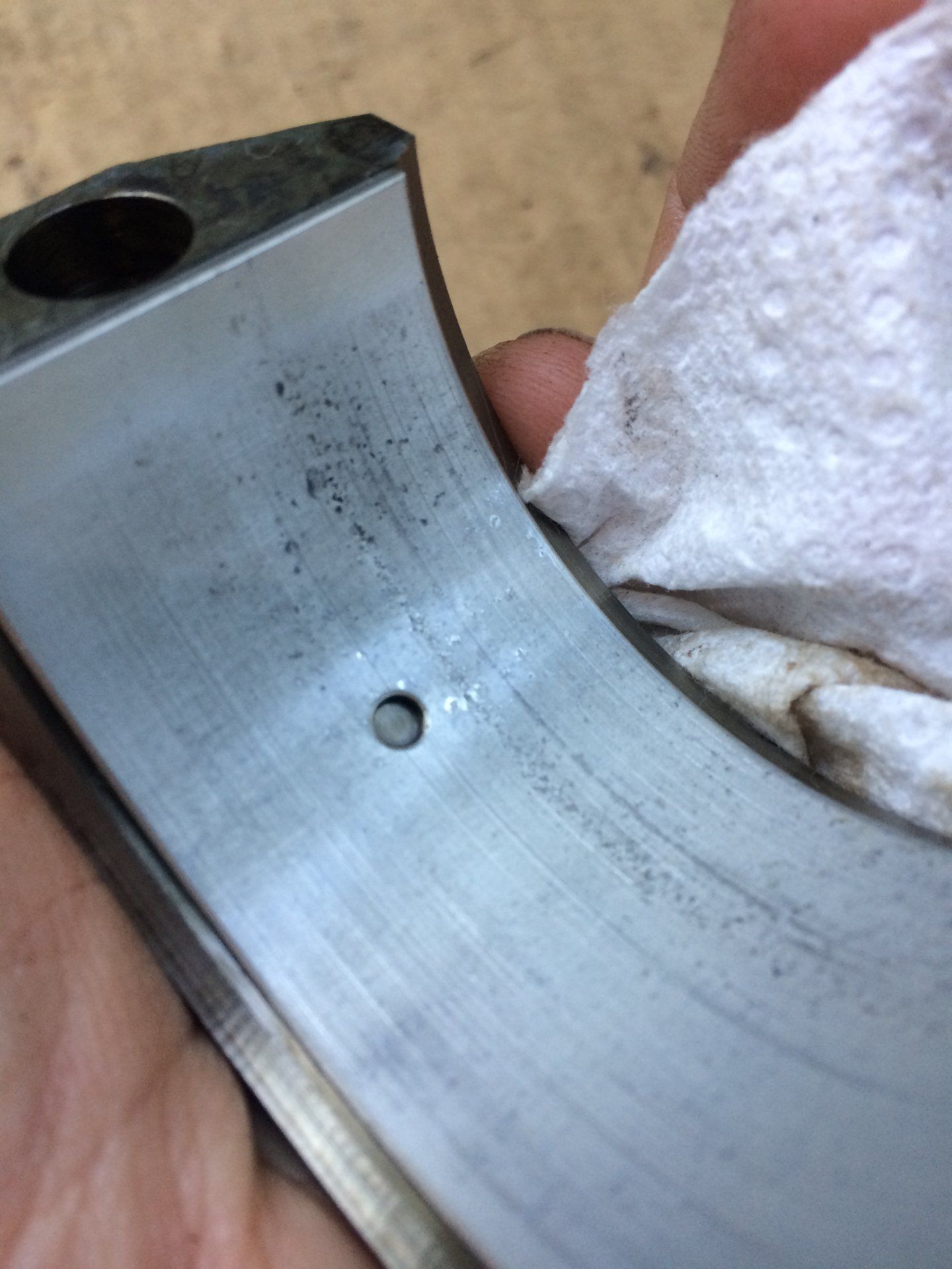

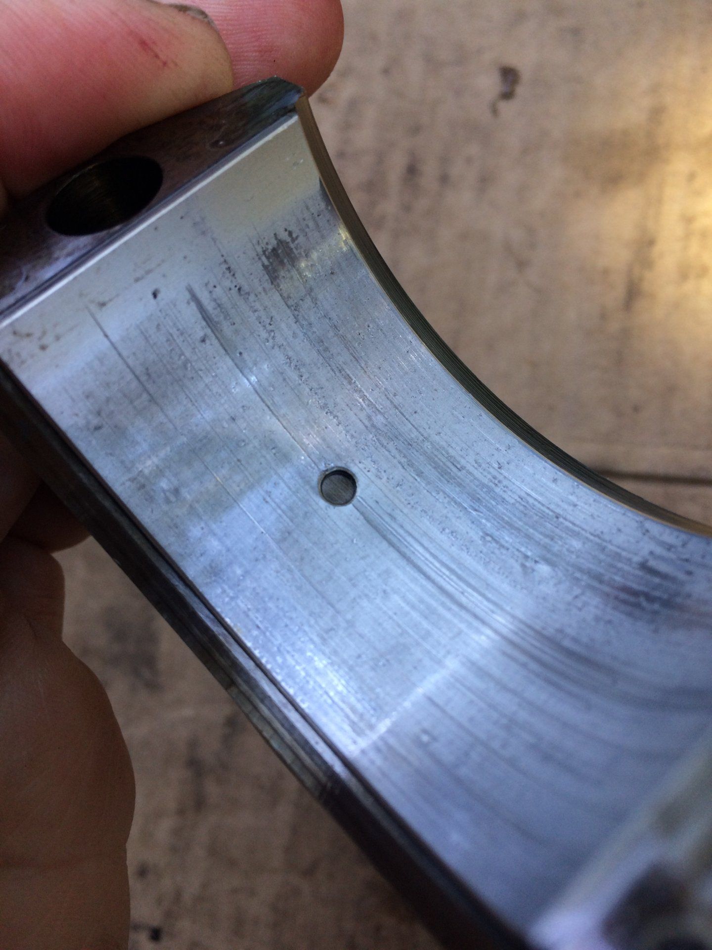

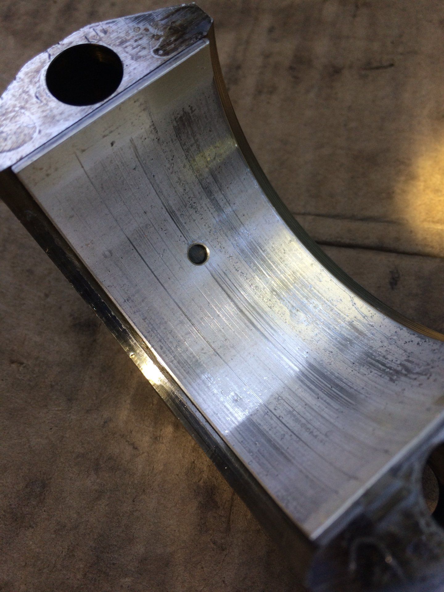

Two photos of #2 and two of #4.
Both have pock marks. 4 has a 1-2mm naked to the eye gouge.
Mistakenly only took photos of inner curve.
Those look pretty good from pictures, but they are pictures. If they fail the fingernail test it's probably a good idea to replace them. If not put em back in.
So those look like worn bearings. Normal in the scheme of things at 190K. Somewhere in it's past, someone neglected the oil changes it should have had!
Get it back together and run it. You could have 10 years or 1 month. You won't really know. I'm hoping it goes back together and runs perfectly for many years. But I will say, that at 190K you are closer to the end, than the beginning. Just the way of it. The 2Fs that make it to 400K, nearly all belong to original owners who really cared since it was new.
I agree. Those look like every 200k mile F-motor I've disassembled (about a dozen). I'd replace them if you can stand to wait for parts. Not sure what your timeline is on expected reassembly. I wouldn't bother touching the mains.
